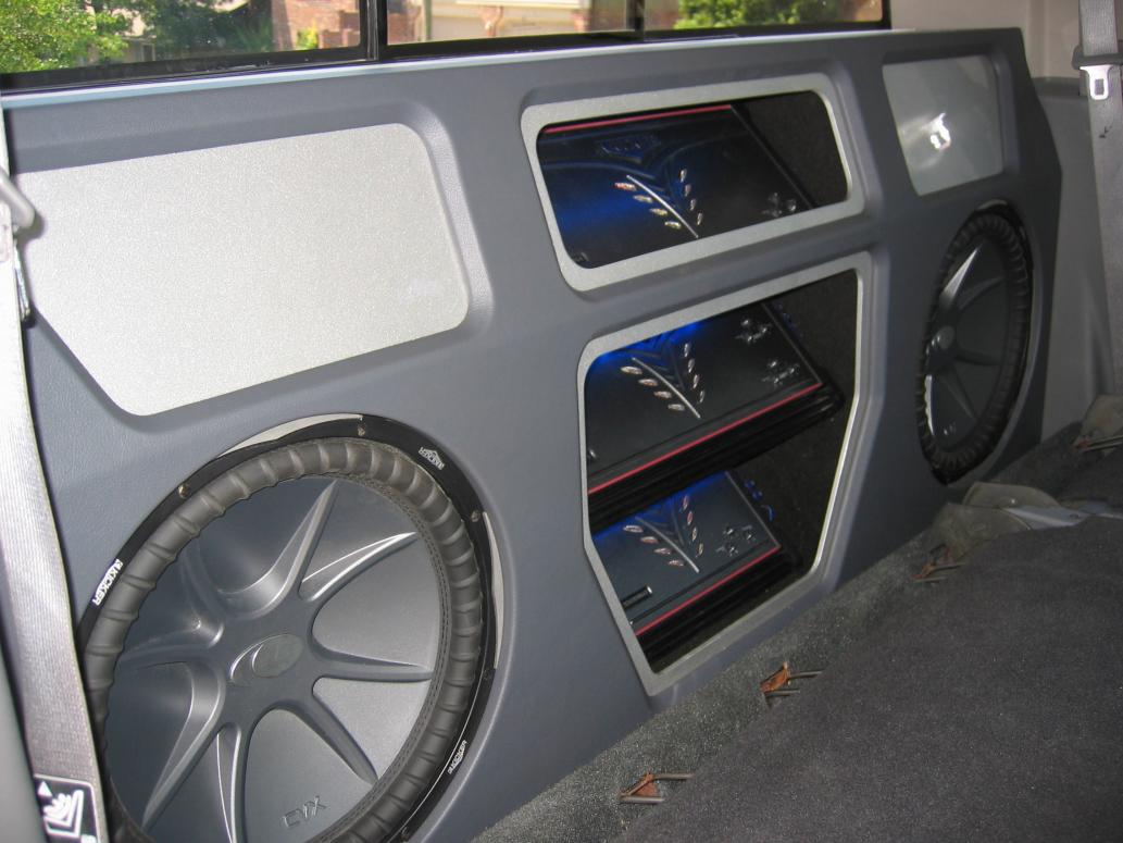

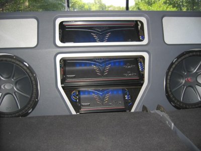

a buddy of mine did this install, benind the seat of a Dodge Mega cab, and I really liked it. So thinking about doing something like this, facing the rear tailgate behind the second row....thoughts?

man clean lookn install... im sure it sounds good but doesnt hit as hard as they could due to the lack of air space.. jus my 2 cents ;)

CVX's like small sealed. 12's are 1.25 per, but I plan to use Solobaric Classics, .88 sealed.

Hell yeah you know how I feel about the classics, amazing how hard they hit with such small space.

that would look sick.. thinkin bout puttin an angle on the sub or just face straight back?

I like the idea, I would actually like to do something like that myself....I say go for it
I LOVE too much wattage too little airspace sealed setups.. might not hit as low... but will hit massive hard and tight!!
I like that setup ALOT !!! do ITTTTTT

Looks good . I wanted something behind the third row at first, but just couldnt decide.

Looks nice! SHould be a cool build. Any reason you want to stay on the small end of things? Just want the cargo space?

yea, very similar to this, slant then straight up and down below the seat line if i can.
Yea, need what cargo space I have now, for trips,etc. I could easily wall it off and do six 15's, but I need practical. :)

if you can fit the depth....I'd do like three 8's sealed back there....that's enough cone area to make some noise.

if i keep the truck I will do a system very soon. Saw this on my buddies truck two years ago, thought it would be cool, yet not eat up all the cargo space in back.

You have to take into consideration though.. that the setup was in a truelly limited cargo situation... so he had to lose a sub to make room for the amps... it looks sick. but in our trucks you can do 3 12s.. and just put the amps under the seats in the 2nd row.. just fyi

IN a thick ass no flex box.. with just a hair less airspace than the speakers want.. sealed like a submarine.. so it SLLLLAMMMMMSSSS even to fast metal.. and still knocks to bass..

I kinda wish I had done 4 10s these things are really fast tho I don't think you'd need to downsize the enclosure the 10s only need .66/sub iirc. I bet they would hit sofaking hard.
