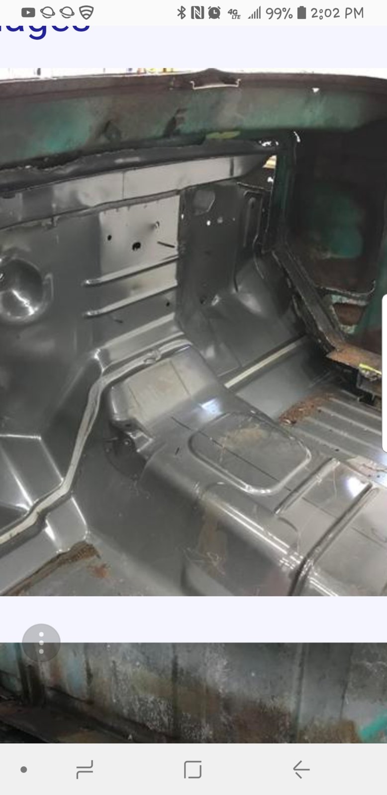

Grabbed this screenshot off the forums. This is the trans tunnel on the nbs Tahoe. Looks like it was meant to be there.

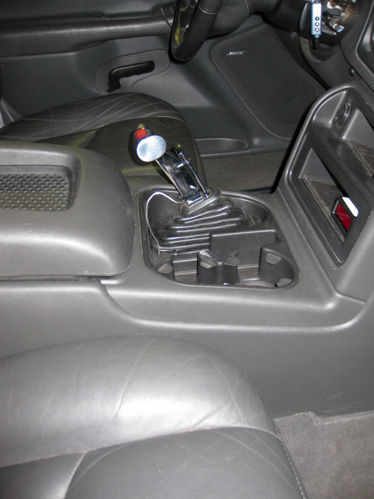

I literally spent an entire night googling because of your post. I'd be interested in seeing the SS shifter in your body style, but the best look I've seen with about eight hours of googling is a Silverado/Sierra rear entertainment console with a B&M megashifter 80680 protruding through the slot left of the cup holders with a modified boot. Removing the column shifter and splicing your wires together keep your P alert and indicator functional even with the floor shifter. Seemed like a easy enough job with patience to get the test fit right before snugging everything. Plus, slap shifters just make you happy.
...... You've inspired me to spend even more money now. :yuno:

That looks sweet!

Sure looks like the floor pan is separate, and probably easier to keep the same stamp for all of them, then to make a new one just to not have the area separated for the manual trans...
Also, I thought they did come in manual around the world. Wasn't a manual an option in South America or Mexico? Probably Africa too if they ever did it. The Silverado/sierra weren't assembled at the same places as the Tahoe/Yukon (AFAIK), but that doesn't mean the pans weren't stamped at the same place. Someone else might know easily, but I have no clue on the process, (just throwing stuff out there).
