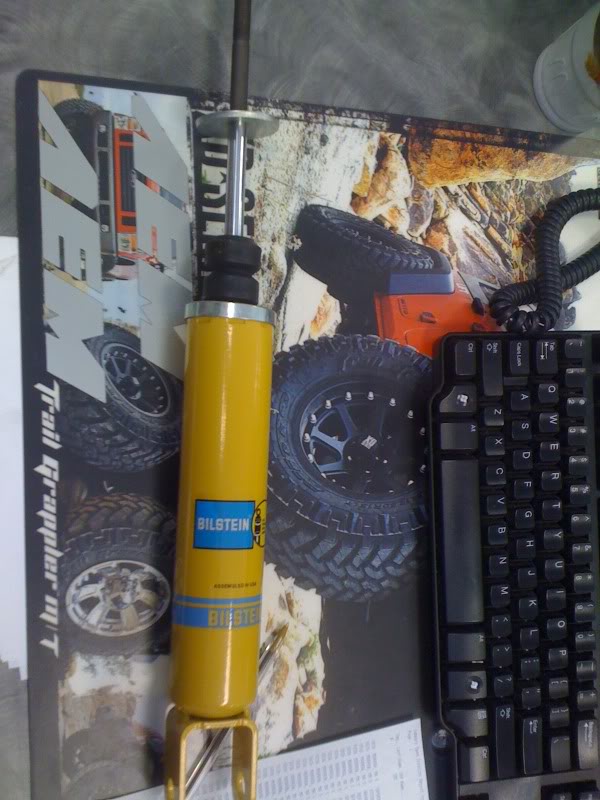

The front stops are normal, GM calls them jounce stops though some bilsteins would help the ride quality:
^^^holy grail of dropped ifs torsion bar trucks^^^

I've got the Belltech Toxic Drop 2 shocks up front and it already is better than stock but I would LOVE to have bilsteins front and back
Blizzard was tellin me about the Z71 stops.. how are they different?

The z71 stops protrude out at the top giving it a bit of a pre-bumpstop. The bilsteins pictured above have an integrated bumpstop on the shaft which really smoothed my truck out, now I just have to notch the rear frame to get the ride quality back on that end.

Factory height bilstein HDs work with shock extensions up to a 5" drop, I'm looking at the 5100 series 18.5" extended length part # BE5-6251-H5 for my truck with a 7ish spring.

They're about an inch shorter which is why you have to use the shock extensions. Part # on the stock rear HDs are BE5-E380-H0.
