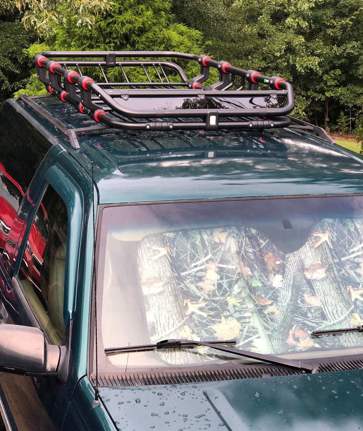

The Rack Basket is on, will install clamps tomorrow

I think it looks more than strong. On my Yukon it could be at least 6-8 inches wider, but it's good as is. The red urethane you can see are water resistant seals to keep most of the water out of the tube clamps and interior of the basket tubes.

Since it was cool after a T-storm, I went ahead and installed the clamps that attach the basket to the OEM roof rack. Tomorrow, I'll tighten them all up after I center the basket. Because the bars the clamps ride on on the basket, there's not much positioning left except fore and aft.
All recommendations I've seen are to place the load as close to over the rear axle on our trucks, I've move the basket rearward as far as possible.
