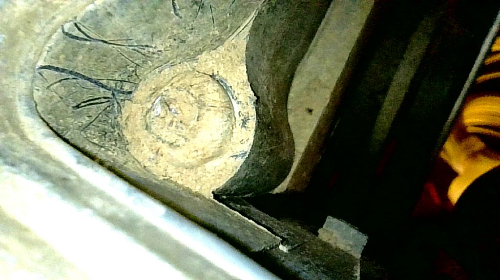

Everything doublelive said. I'll add that it's sort of a stressful to pull the EBCM too; it's underneath the car with limited room and you have to blindly ensure the 4 torx screws aren't jammed up with crud or else you'll strip them.
Here's how one of mine looked.
Wouldn't have been able to clean everything up and get the screws loose without my endoscope. Anyways, just do really good diagnosis because you don't want to go through all this mistakenly.
