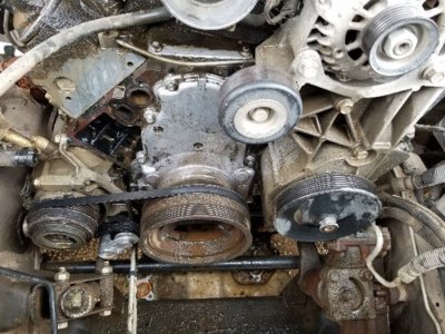

While replacing the water pump, I did some cleaning on the front of engine. There was about 1/8" of build up all over.

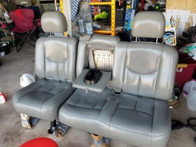

Today, I somehow managed to get the 2nd row seat and two Denali seats out of the back of the truck by myself. I knew my degree from that fancy agriculture and mechanical school would come in handy some day. Here's the back seat after I got it out and fabbed a dolly for it.
This came from the same '05 Tahoe as the leather fronts I pulled previously. I swear it was a stripper's truck...glitter everywhere. It's also interesting that nearly every vehicle I pull parts from, I find empty beer bottles or cans in. Keep drinking and driving folks, I need your parts.
Oh damn, I never bothered to check if the center plastic was there. I think I have one from a previous salvage yard excursion though.
I first cleaned them with some leftover Krud Kutter water from the last thing I cleaned, then did the seams/stitching with Krud Kutter and a toothbrush, went over the whole thing with my steam cleaner, then wiped with a sponge and clean water.
Then I went in with coconut oil shampoo (from Dollar Tree),
and finished with a soak of 303 Protectant just like I did with the dash, wiping it with a microfiber cloth after about 2 hours.

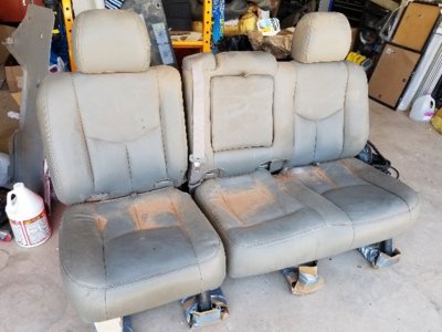

Here are the seats I pulled from the Denali. I tried to pull the top leather without cutting it, but that is a helluva job, so I organized all the gray vs. tan parts I have sitting around and washed the truck instead.
Here's the shampoo from Dollar Tree for the leather
And now I'm exhausted, so time to relax until I start again tomorrow.

I forgot to mention that the Denali seats and the back seat only cost me $80. The front seats I pulled from the '05 and all the plastic from the previous haul was $85.
33,185
51,399
Good deal. Denali rear seats should be heated. Has heating elements in them.

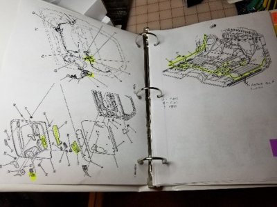

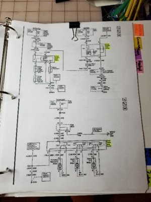

I'm not good at getting the plastic J-clips back together, I don't have the strength or patience to pull/push on them. The headrests and bottom seats aren't bad, but I'm soooo hating the top seat covers right now.
I research everything to extreme. I made a Word doc from all the different sources I found.
For you Tony, I walked out to the garage and got it. Here's the interior info and a few pages from my nerdbook.

View attachment 198020View attachment 198023
Nice! Thank you. Great job. I could use that myself. I repair seats for dealers, and I have to dye the repair afterwards. Sometimes finding the right color takes me longer then the repair does.
