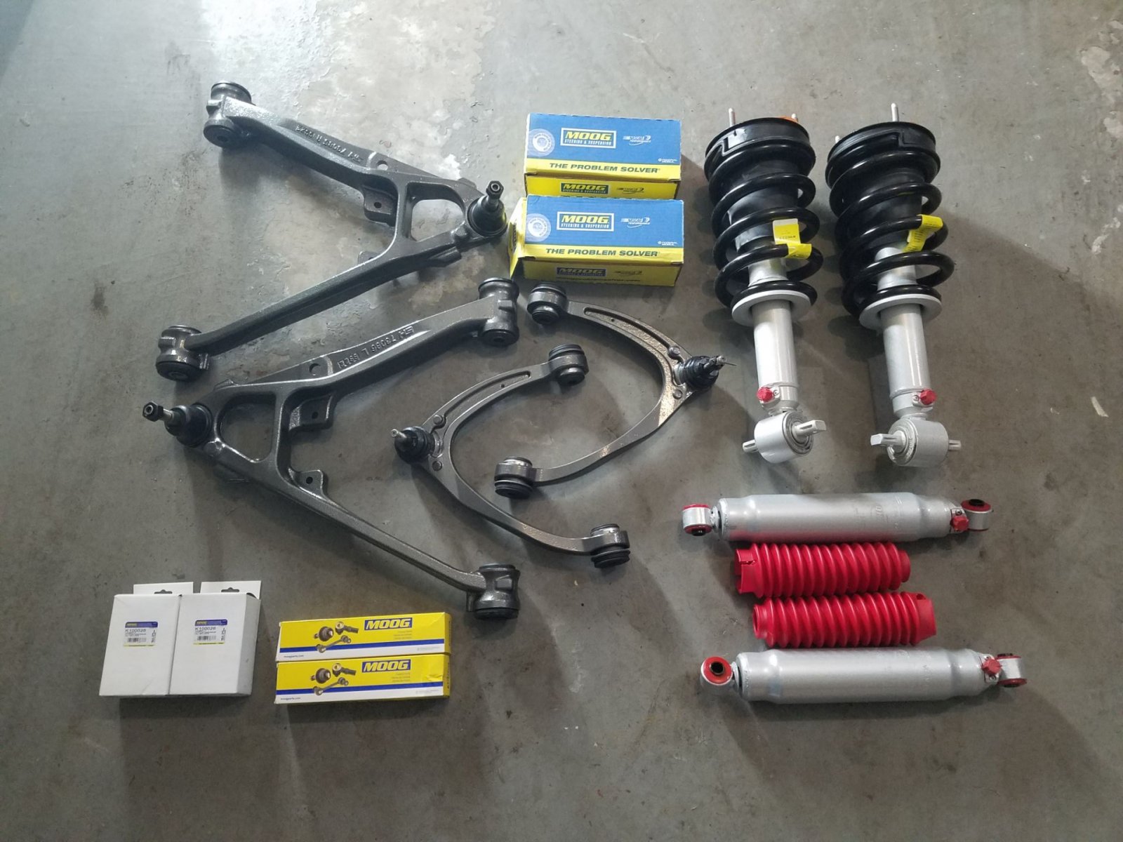

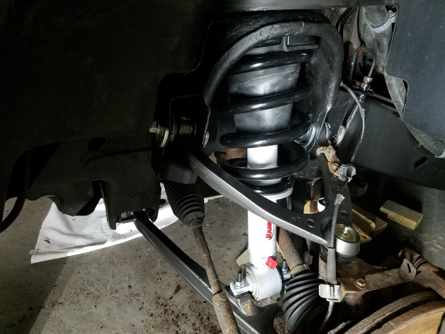

This was the catalyst for the whole year really. I knew my ball joints were shot and then I started experiencing a loud THUNK whenever the front wheels hit a bump in the road. I knew I was going to have to put quite a bit of work/money into the suspension so I considered trading up. But, as mentioned above, I decided to keep her and dive into a year of upgrades and fixes. Besides fixing the issues with the suspension I also wanted a small lift to bring the Tahoe up to the height of modern OEM offroad packages. I was always annoyed by how the newer bone-stock Rams/F150s/Silverados made the Tahoe feel like a minivan when they pulled up next to me. I knew i'd only need a couple of inches at most so I aimed for a 2" front 1" rear setup.
I originally settled on Bilstein 5100's, and actually ordered them. But during the teardown process I realized that Bilstein counts on you being able to re-use your factory spring perches...which is pretty ridiculous...mine were rust-welded to the shocks. In setting out to order replacements I learned that the perches aren't offered separately, only with new shocks. WTF Bilstein? Really? That, combined with the reported really-harsh ride of the 5100's and the reported failures of the c-clips that support the perches led to my decision to go with the slightly more expensive Ranchos. They came fully assembled with springs, perches, isolators and mounts.
This was a big project:
- Rancho RS9000XL front coilovers and rear shocks
- Moog LCAs and UCAs
- Moog Outer tie rods
- Moog Front Sway Bar links
- Moog rear stabilizer links
- CCM 1" rear lift pucks
- Powerstop Evolution front and rear brake kits
Who doesn't love the day all the new toys arrive?

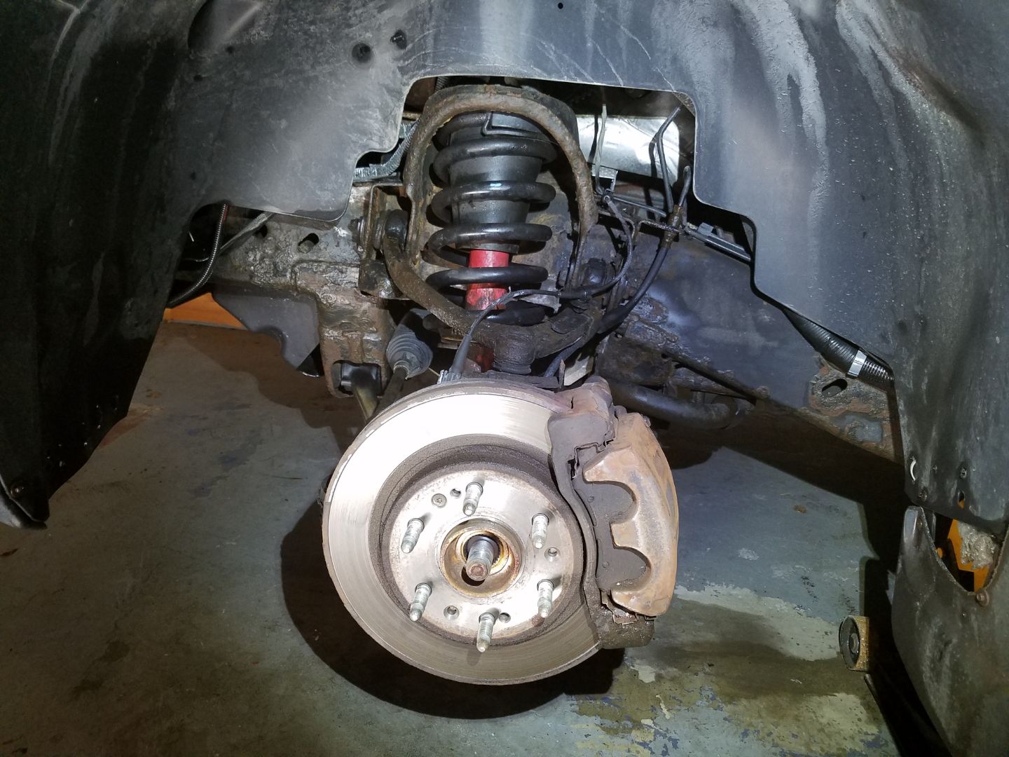

So here we go - before:

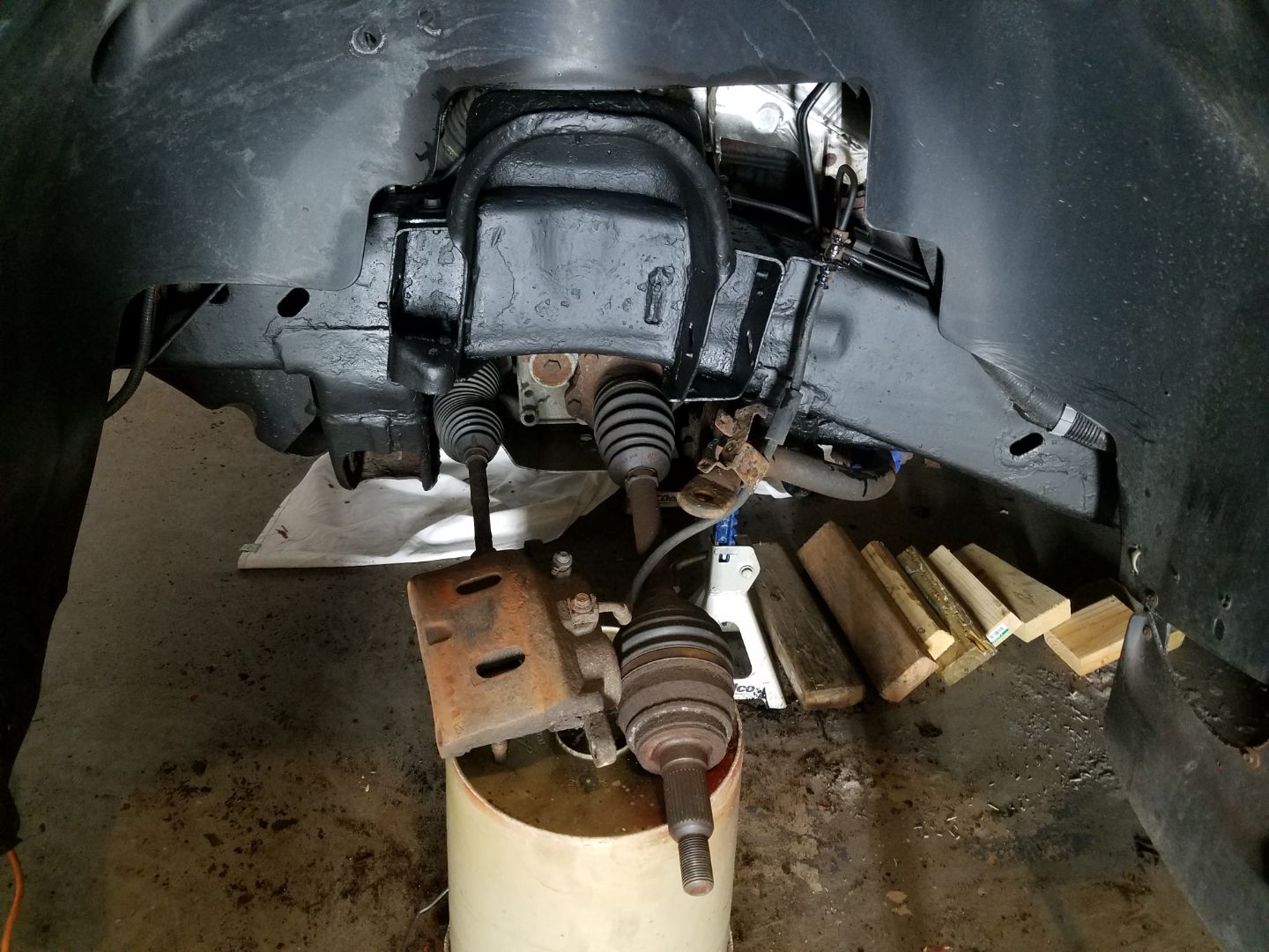

And what a frikin nightmare it was. Everything was rusted to everything else. The only tools that actually worked for disassembly were my angle grinder, sawzall, and cutting torch. I basically just had to cut all the bolts off because they had completely fused together with whatever they were holding.
During this miserable process I decided to do something about the rust so I stopped the suspension work with the truck apart and put a couple days into cleaning up the front half of the frame and coating it in POR15.
It took me three days (two weekend days and one weekday evening) to tear it down, two weekday evenings to POR15 the frame, and then about three hours to put it all back together. Ha.
All pretty again:

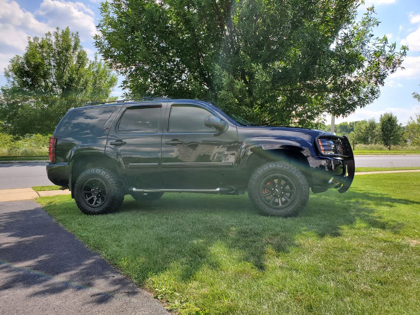

The day I reassembled it:
It was initially a 2.5" lift up front and a 1.75" lift in the rear. But it settled out to a 2.25" front and 1.25" rear within a week. Pretty much exactly what I was going for - i'm now right at eye level with the drivers of those newer pickups.
The RS9000's are adjustable and I love that feature. I've settled on a setting of 5 front and 4 rear. Going higher makes the ride harsher and more unsettled, going lower makes it floaty and bob-y.

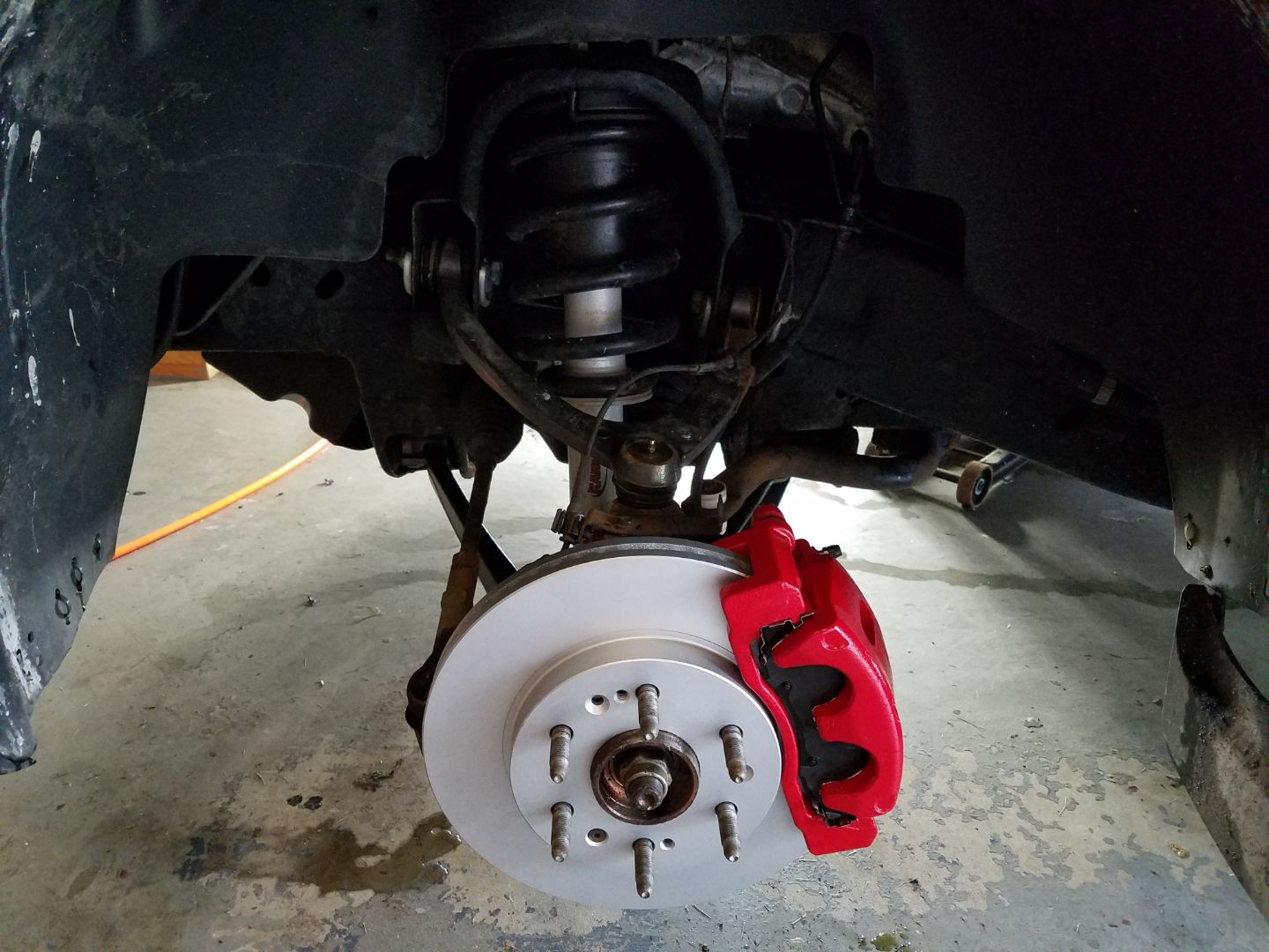

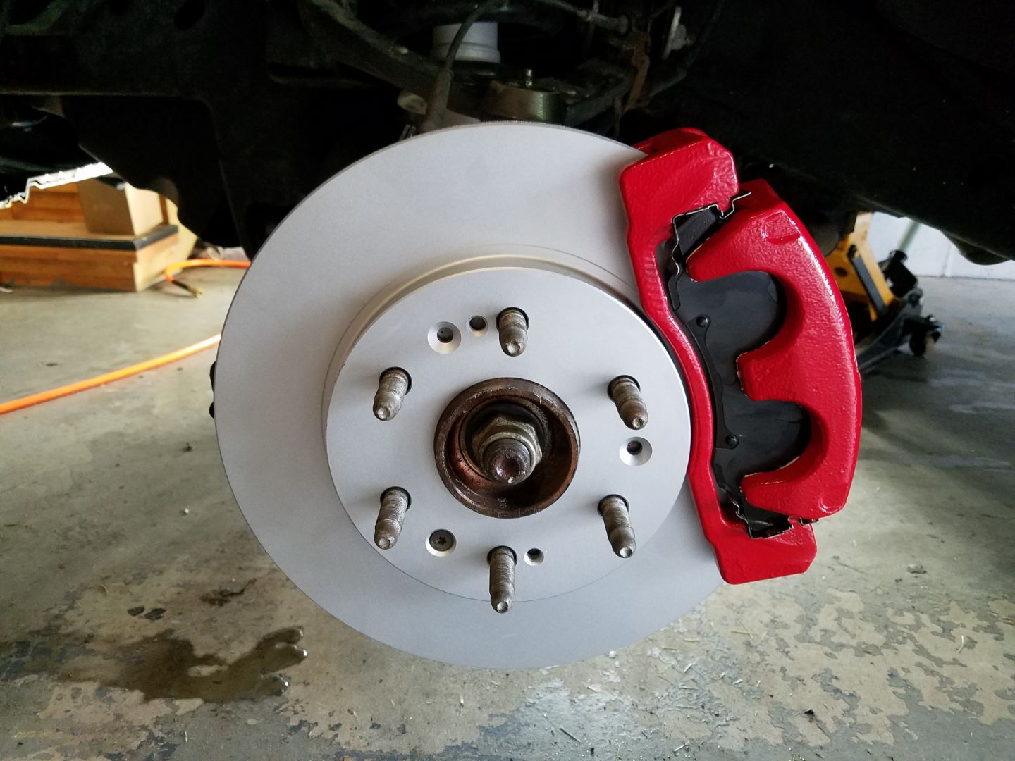

So about a week after I got the suspension re-assembled, I started hearing a squealing from my front brakes. I knew exactly what it was and many of you will too - the pad abutment brackets had corroded where the pad clips seat and basically locked the pads in place so they couldn't retract properly, so they were skimming along the rotor when the brakes were not applied. I initially was just going to clean up the brackets real good but then I saw the price for the Powerstop Evolution kits which come with brand new (red!) calipers, rotors, pads, and hardware. I decided I might as well just go all the way if I was going to take it apart again.
The before pic is basically the after pic in the suspension post.
All done:
So pretty.
So there you have it. Suspension and brakes.
