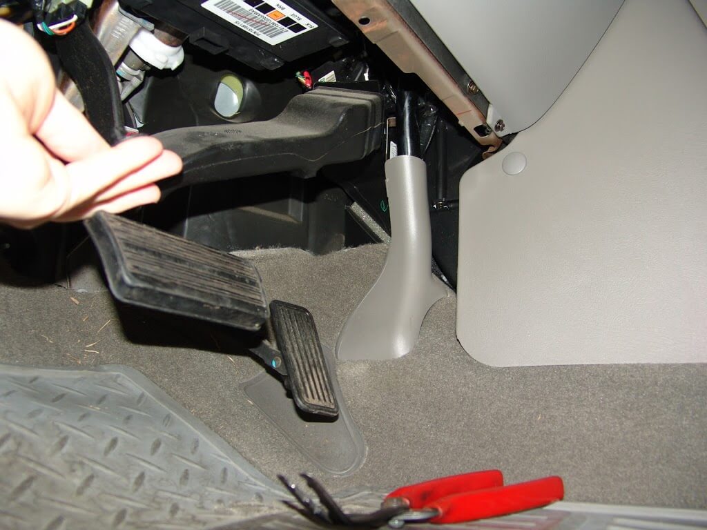

Yes I know it’s a module. I found other ones, not the one I’m looking for. Thank you
30,768
48,462
this should be where it is, at least that's what your looking for, top dead center in photo with black squares printed on it, I sold my 2000 yukon but this photo is from a 2003 silvy should be in the same spot. but could be to the right in front of center console or could be to the left on firewall also.
https://i0.wp.com/104.197.77.209/wp-content/uploads/2011/02/DSC04776.jpg
RealTahoeSS
RealTahoeSS
Nov 8, 2017
Thanks. I found that. It only has 3 plugs on it. I was told it has seven connections. Obviously bad info. On my end.
