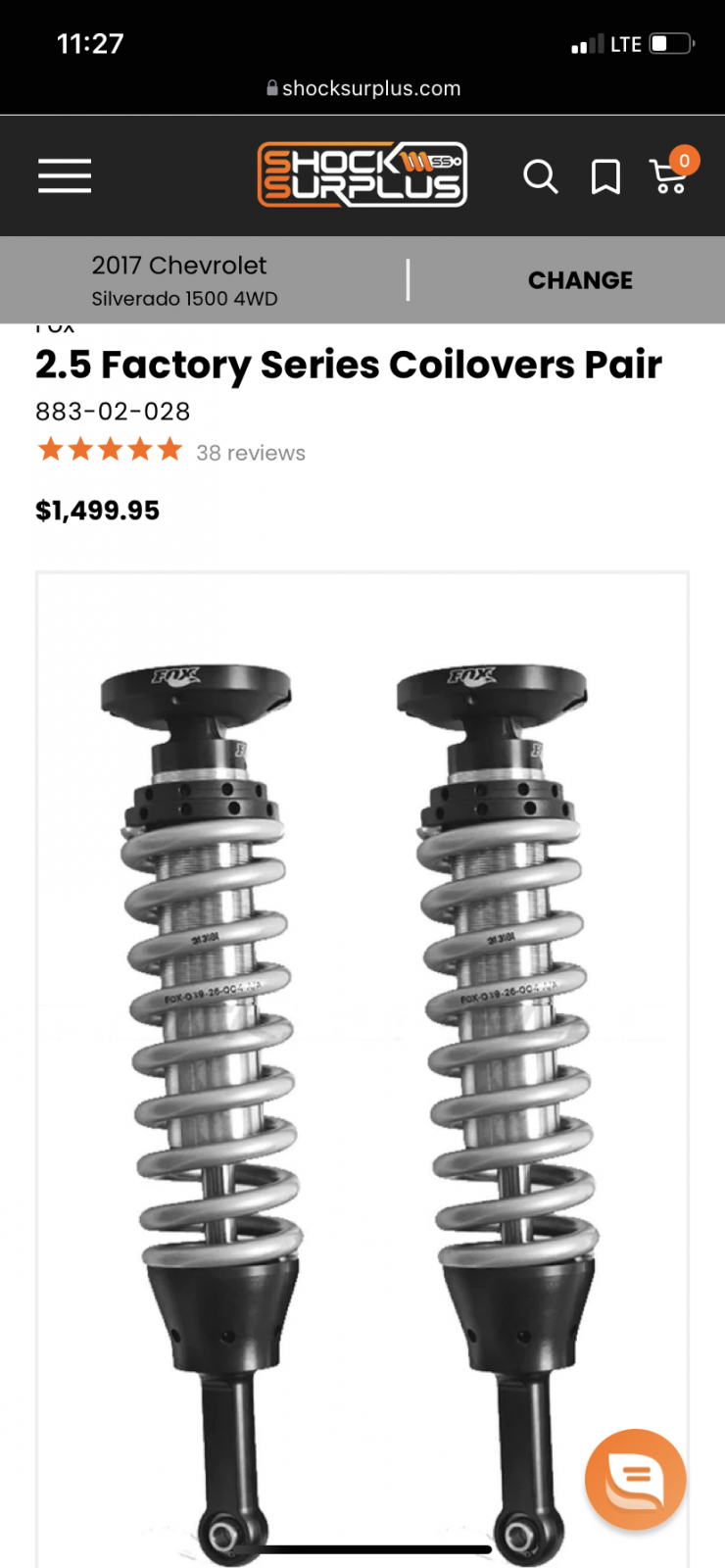

Seen a few threads on this topic but nothing too specific. I have a 2017 LT tahoe 4x4. Will all 2017 Silverado 1500 LT coilovers also fit? This fox 2.5 coilover shows they will fit a 2017 1500 but 2017 Tahoe is not listed on the fitment chart. Is the issue the factory UCA is different?

They ought to fit. Pickup trucks use higher spring rates. These coil overs leave a lot to be desired in ride quality over the factory style.

Thanks ya my goal is to lift the vehicle for larger tires and ground clearance with off-roading in mind. Ride quality around town isn’t a big concern. Our camping and fishing spots have some very rocky trails to get there. So trying find a good coilover for a small lift 2-3in

The fox coilovers i put on my wifes ‘16 denali showed they were for a truck too…bolted right up just fine
