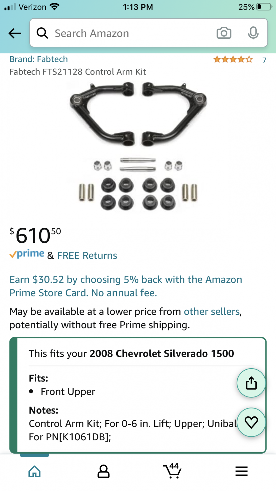

I’ve had 2 sets of fabtech an arms and the one set is 4 years old with 0 issues out the joint or the bushings not even a squeak. They got a couple bad reviews on Amazon but I believe it was from installation error one guy broke the bolt and it diddnt look like he drilled his spindle out to fix the tapered pin on the uniball so it snapped at the threads.
Here’s the part number for the control arms they are the best deal I could find for uniball arms most run 750-900$ sometimes you can find them on sale on Amazon for 500$ or so

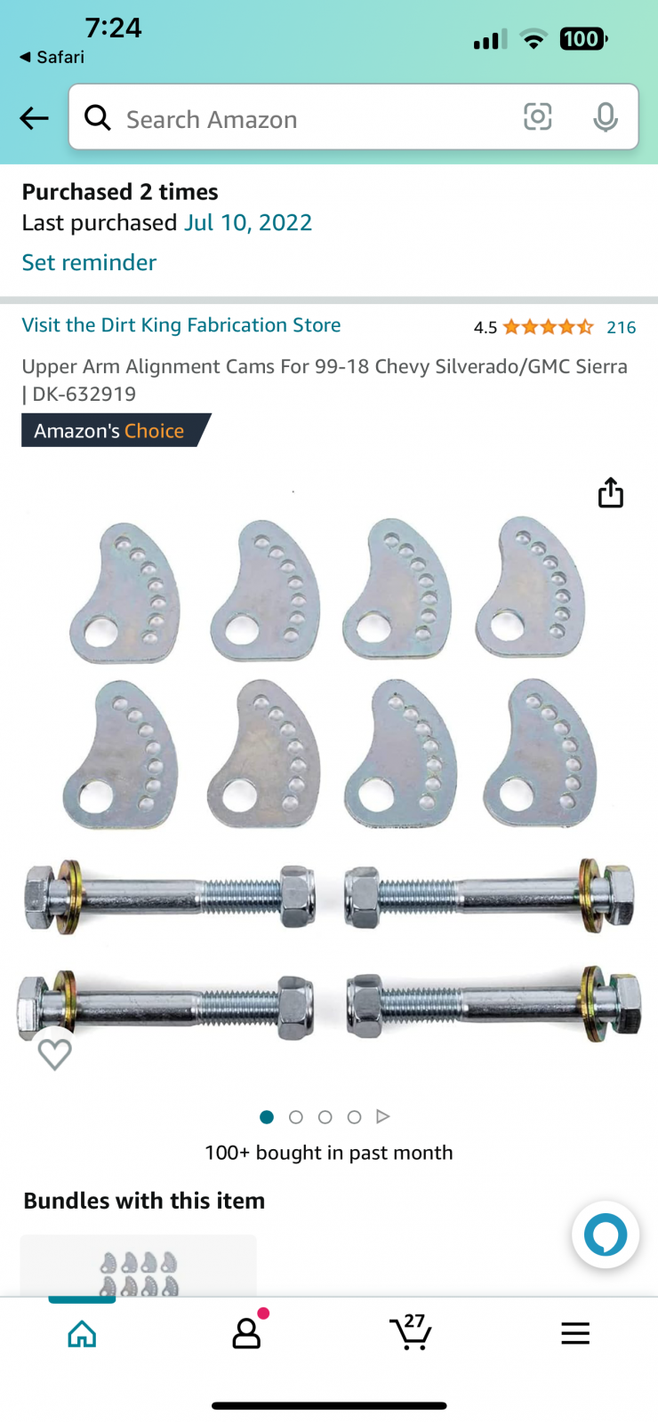

These cam plates lock the alighnment in where you cannot knock it out again I’ve beat the hell out of mine and I haven’t had to get an alignment since I put them on.(the stock sliding style cams like to move or come loose over washboard roads and bad bumps)

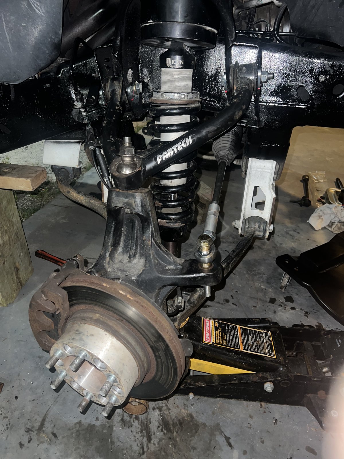

Pic of my setup here
