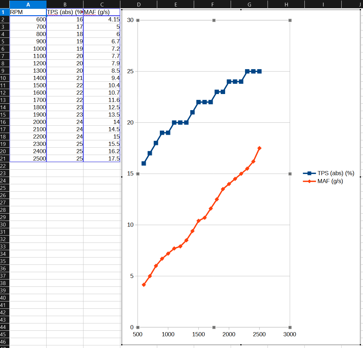

It's taking away fuel (negative fuel trims) so it's either getting too much fuel or too little air (or so it thinks). You stated one value, though; was that for one bank or are they both essentially the same?
What are the short term trims (both banks) at idle and at, say 1500 or 2000 rpm?
Has the throttle body been cleaned lately?
The MAF reading seems a bit low, can you graph it along with the rpm and run it from idle to 1500 rpm or so to see how much it changes?

tahoe_toronto
Jun 30, 2023
Here's the graph. I didn't know a better way so just pushed the pedal down in 100RPM increments, and read the numbers eyeballing what they averaged to the best I could.
T
tahoe_toronto
Jun 30, 2023
I cleaned the throttle body (lots of deposits) and the numbers are better.
I noticed the truck's trims ends up in two cases:
Idle after ignition stabilizes and is great, idle after short drive is a bit worse off.
What do you suggest, do I continue hunting this down or is it good enough now?
The numbers are:
Idle few minutes after ignition, if the car has been sitting off for a while.
Short B1: -1.5% to 0, B2: -0.5% to 0.5%
Long B1: -2.3% B2: -3.9%
After a 5 min drive around, then rest for few minutes, idle ends up at
Short B1: -4% to -2.5%, B2: -2.4% to -0.7%
Long B1: -10.2% B2: -11.7
For whatever unknown reason, on idle after a short drive, the Throttle Absolute position went down from 17% to 13%
Moderator
16,284
33,667
People's Republic of Colorado
Can you get a scanner on it that will reset the fuel trims? I think that the LT trims are going to take some time to adjust since they're learned from before, and resetting them would start them over with the new condition. (STFTs reset with ignition cycle; LTFTs are learned and stored.)
If not, they should come down over time as long as the ST trims stay low. Anything under +/- 10 is "okay", but +/- 5% should be attainable with everything working correctly.
Keep your eyes on them for a while, see what happens. We'd love to get an update later on, good or bad.
And your throttle body position is relearned with a few driving cycles, so expect that to change a bit. Cleaning it allows the butterfly to fully close.
