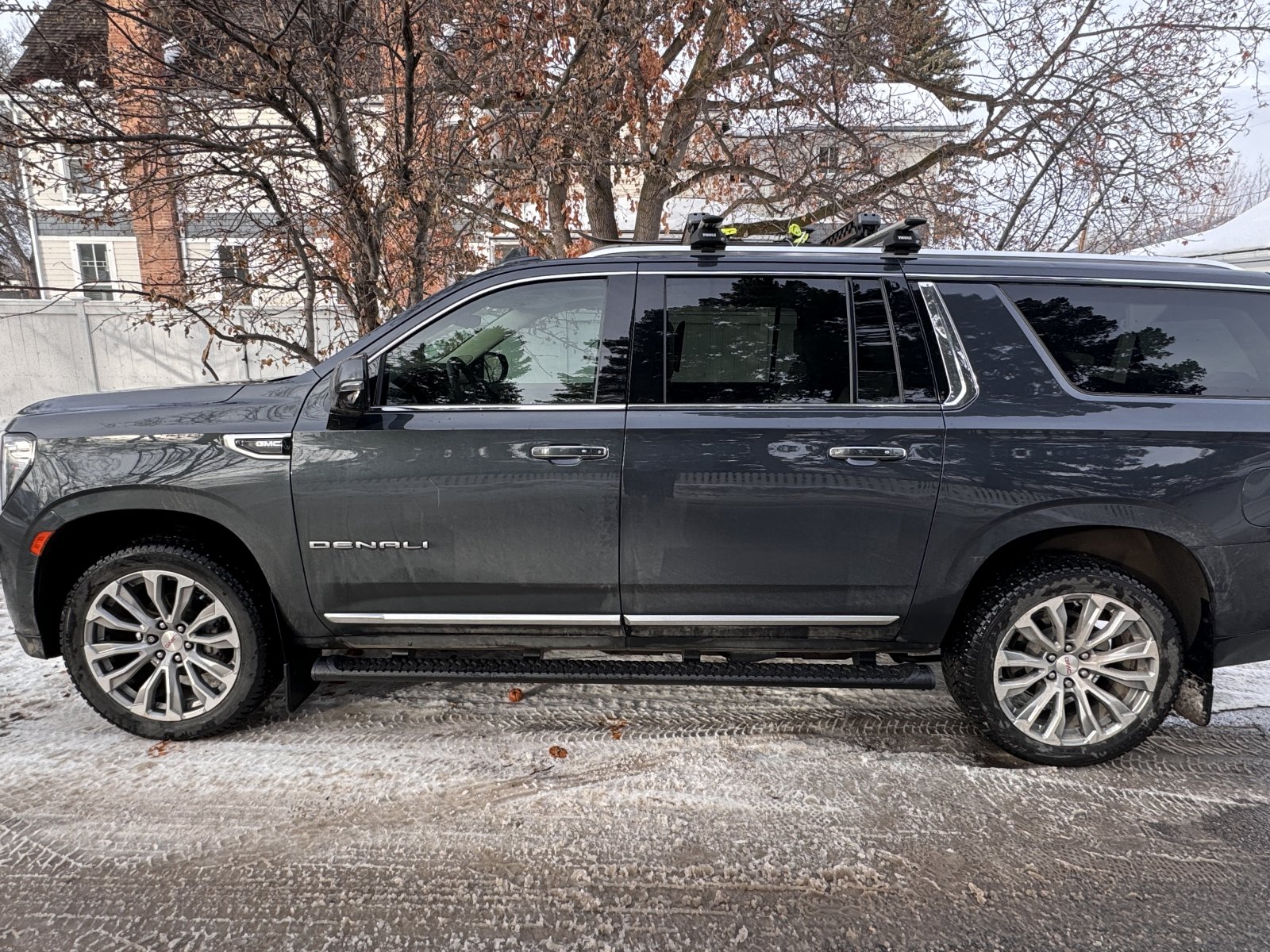

Hi all. I have a 2021 Yukon XL Denali with automatic running boards. Wanting to switch to stationary (OEM or aftermarket) but am running in to a lot of issues since the automatics only have two mounting points. Nothing seems compatible. Does anyone have any solutions or ideas for swapping to stationary running boards? Thanks in advance, my local GM dealer and two off road companies in town have come up empty so far.

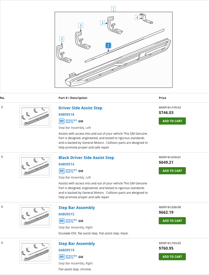

Why can't you order one left and one right of (these appear to be the extended wheel base version), may need to look up for the short wheel base.
Left P/NRight P/NDescription
8480951884809519Left and Right with Chrome Insert Fixed Running Board Assembly
8480951484809515Left and Right with Black Insert Fixed Running Board Assembly
Would think any body shop worth their salt could install these (or would think is not too tough to do yourself). Cannot imagine that there is a difference in the body/frame of our rigs whether or not they have power or regular boards on them. I'd thiink all mounting holes are there...and some are not used depending on which step you ahve installed.
The only challenge may be deprogramming the option in the computer as not installed...and not sure what happens if you just unplug them. Perhaps if you unplug the Control Module for the auto running boards, the vehicle will recognize them as not installed...not sure.
Note, @AOK, scroll down in the list that @Blackcar provided; the fixed version is listed on the same poage, further down. The assembly P/N's provided include the mounting brackets too.

They probably do but if you buy stationary boards they will come with attaching system that work with them.

If they are selling the ones in link in post #2 I linked and say they fit vehicle in search the attachments that boards come with will fit locations in inner rockers on truck for sure.

I ordered a pair of the running boards for a z71 Suburban. They went right in!

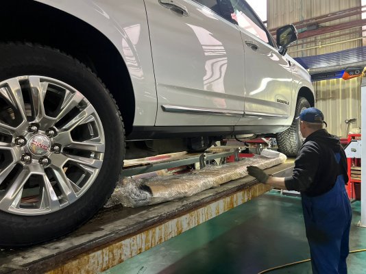

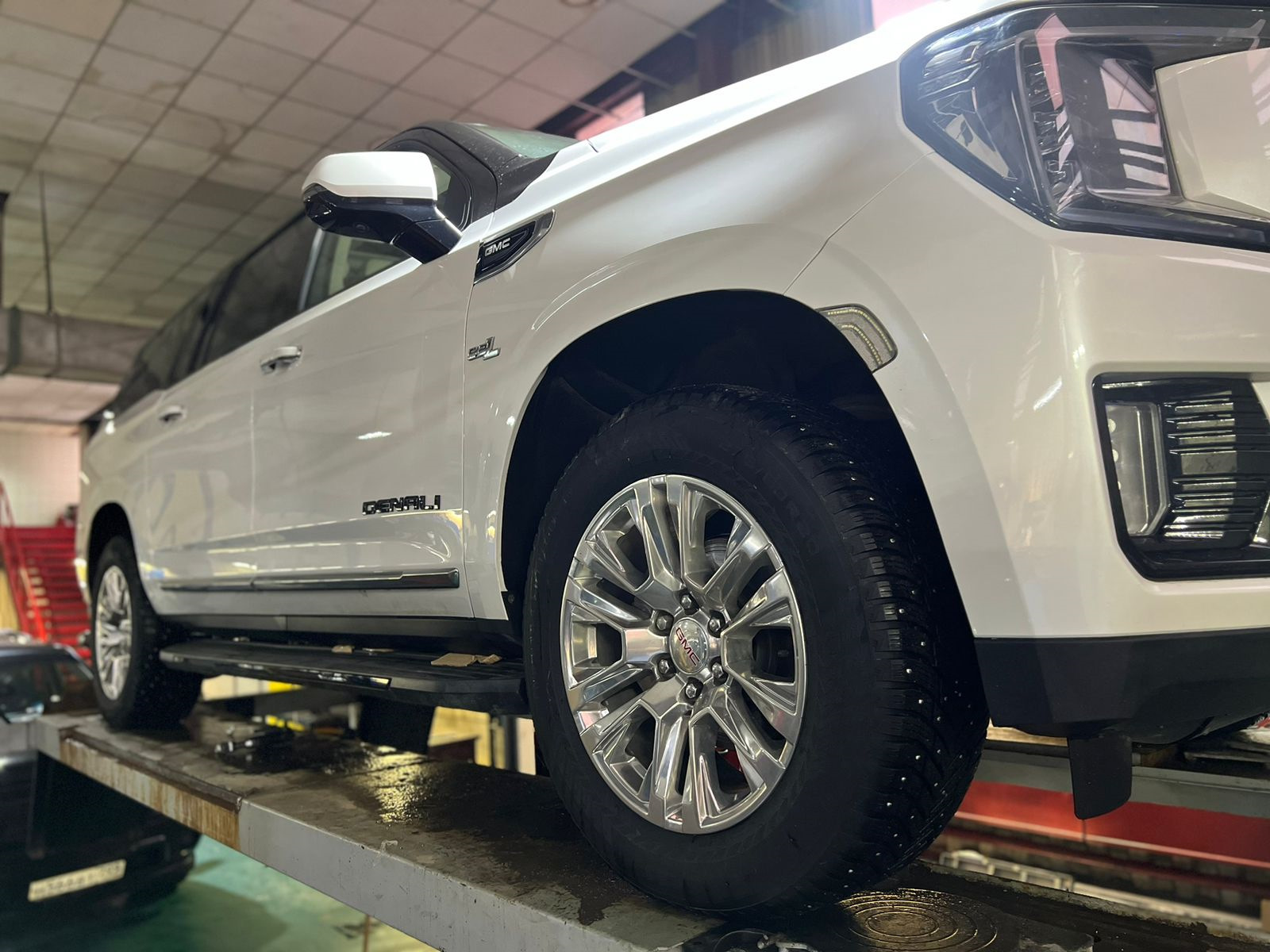

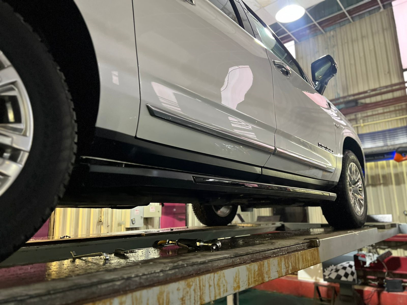

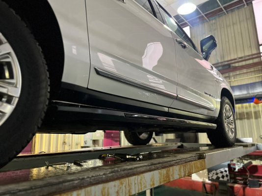

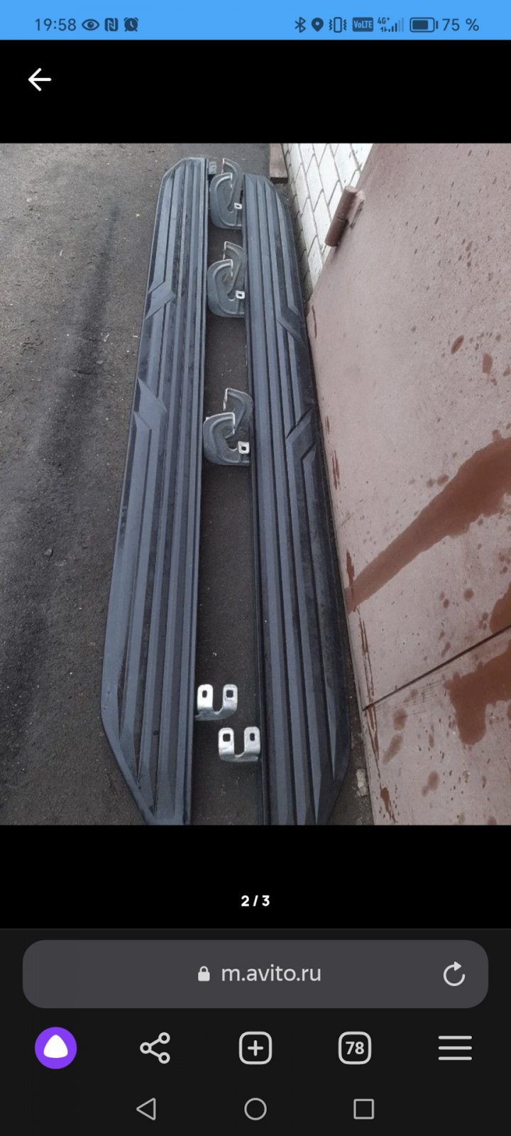

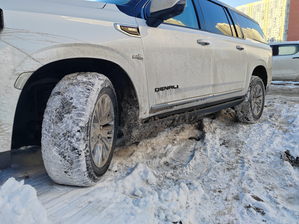

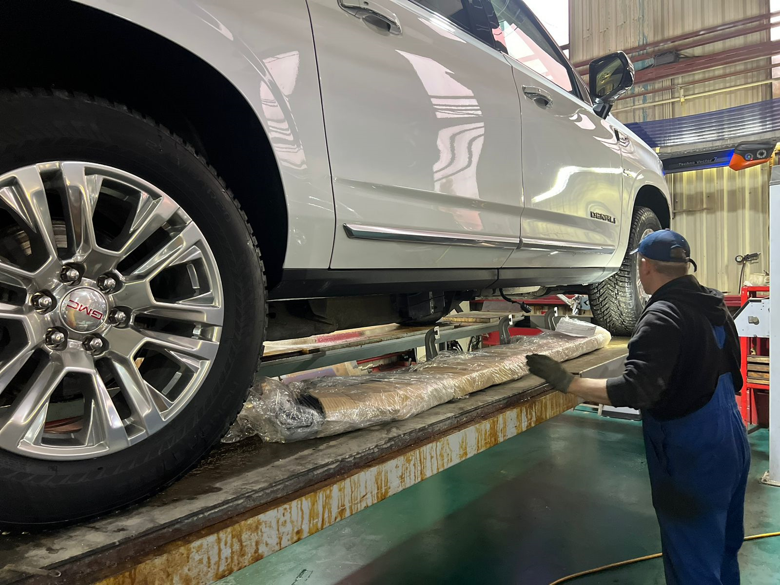

There are no problems at all in replacing electric thresholds with stationary ones, you buy thresholds from the catalog, they fit into the regular places. The main problem is to properly isolate the power connectors from the electric thresholds. Because if you cut them, it will be impossible to return to electric ones. I installed stationary ones after I was exhausted by their work.
