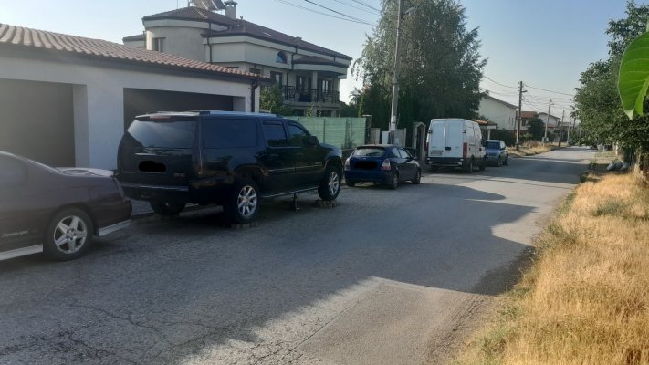

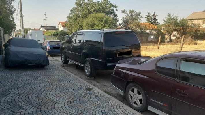

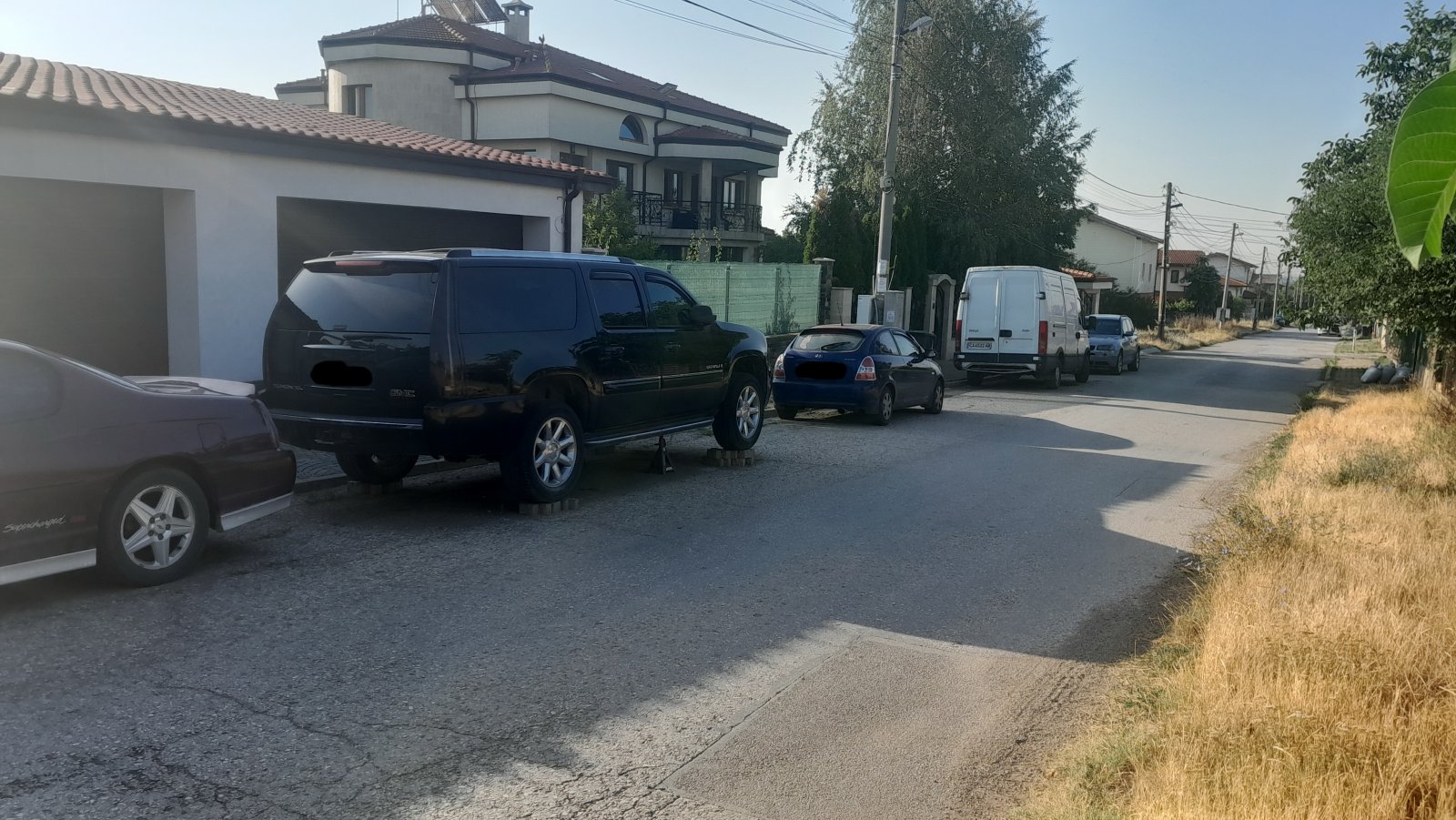

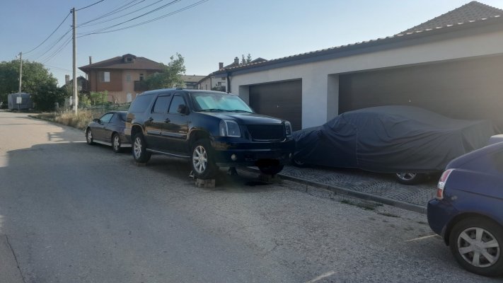

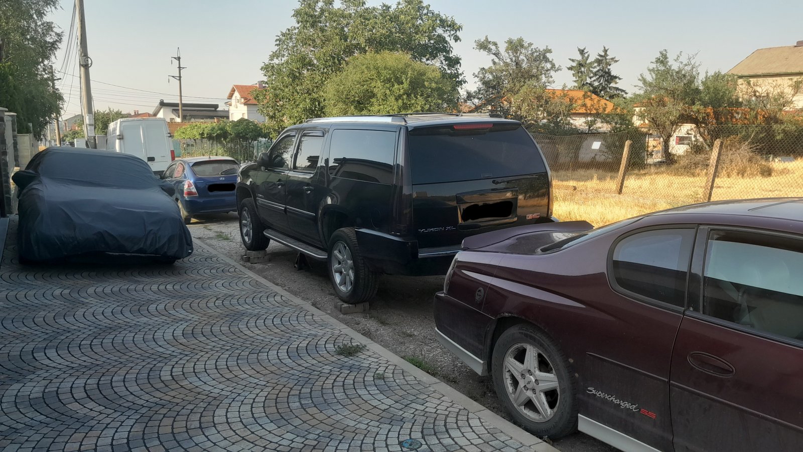

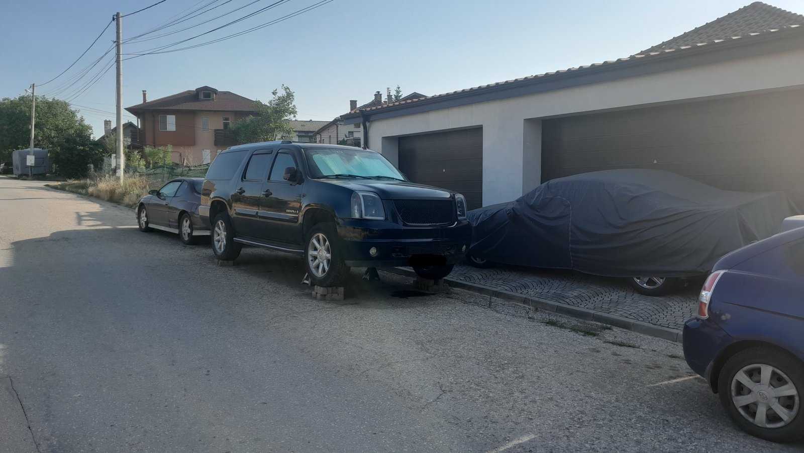

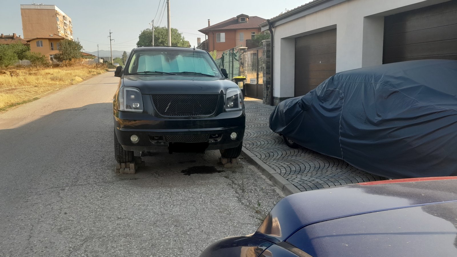

Here are some pictures of the car. It is on jack stands because I have some staff to do. It is around 180K miles.
I bought it last year but have not driven it :-(, got less then 1000km.

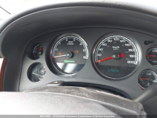

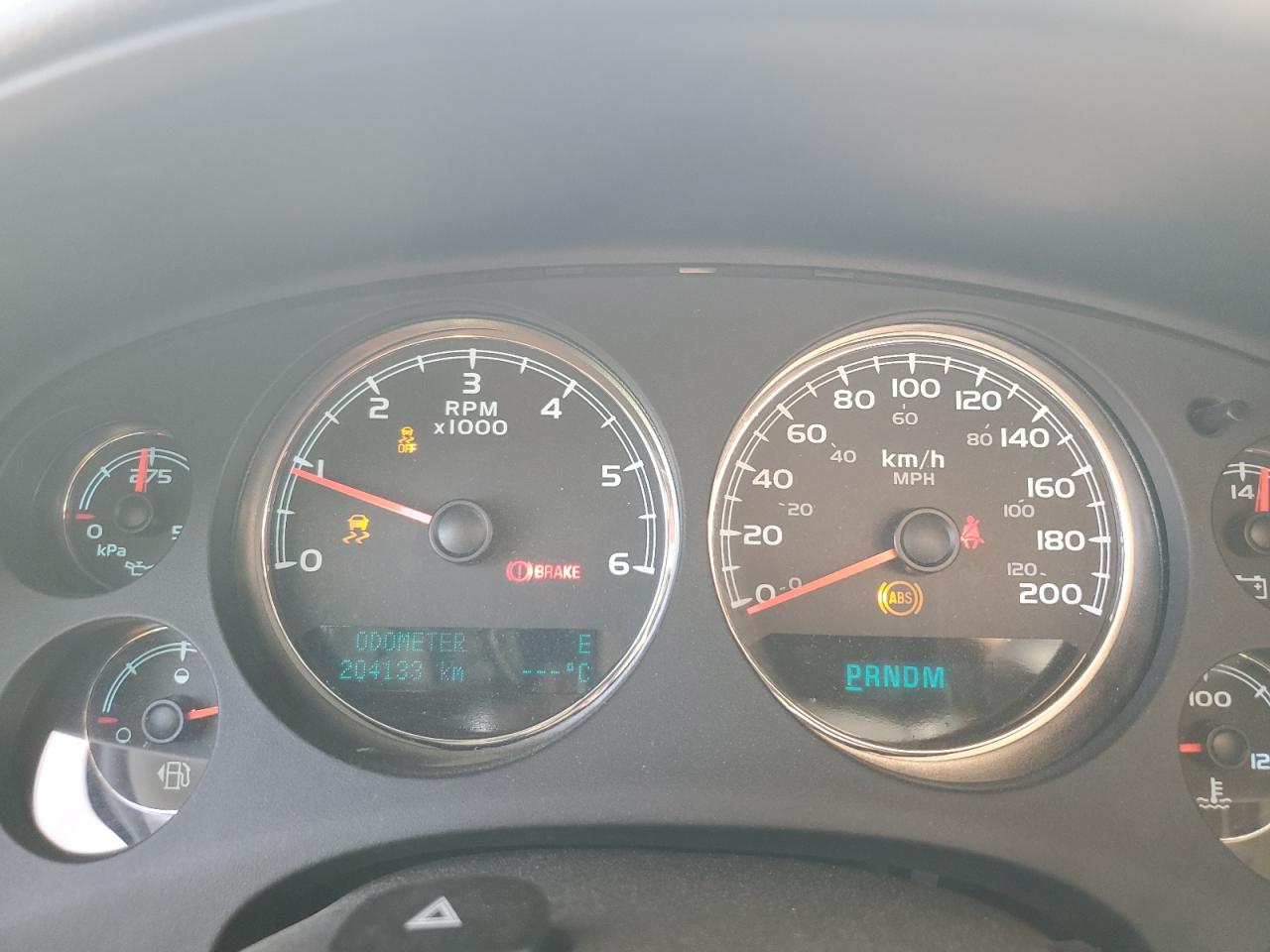

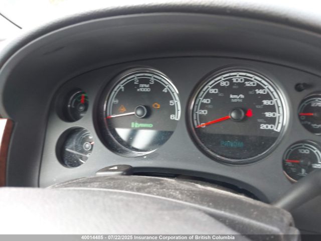

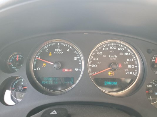

Actually, I would like to have Canadian cluster only because of km/h and Celsius degrees. Like in my Monte Carlo that was imported from Canada and on the pictures I found online.
I see ads on ebay and others that they can program VIN, millage, engine hours etc. Here, for example:
Then, the problem will be to source Canadian cluster itself :)

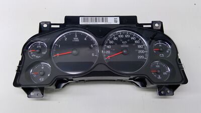

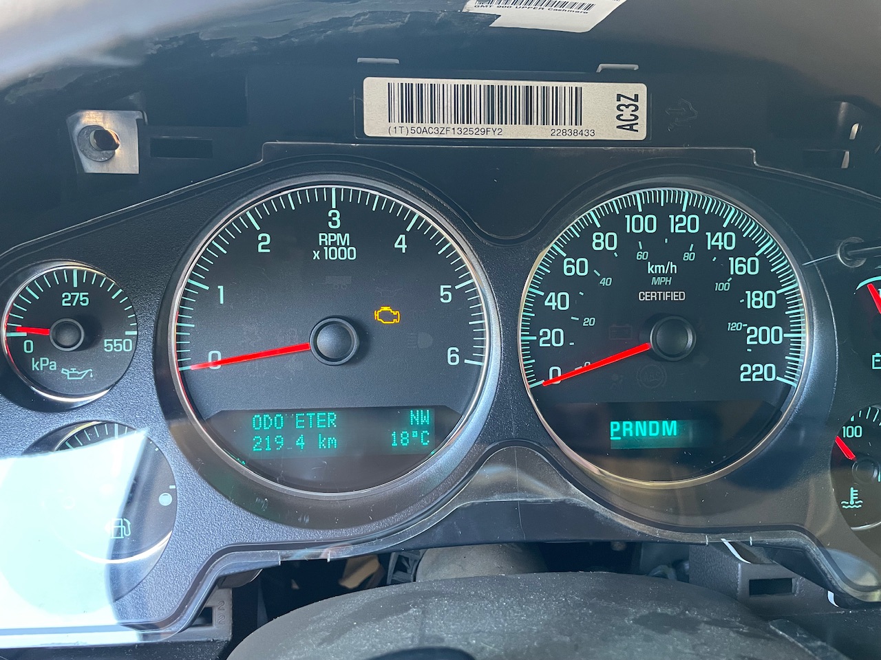

Here's the best one I could find checking out ebay.ca
Says new! (looks new) And he has 3 of them..
BUT, it is the 220 km/h ppv cluster...

Canada cluster installed. Will probably remove it, and save it for a backup.
No problems I can find. IP saves the display settings because temps were metric, until I went into the DIC and changed it back.
