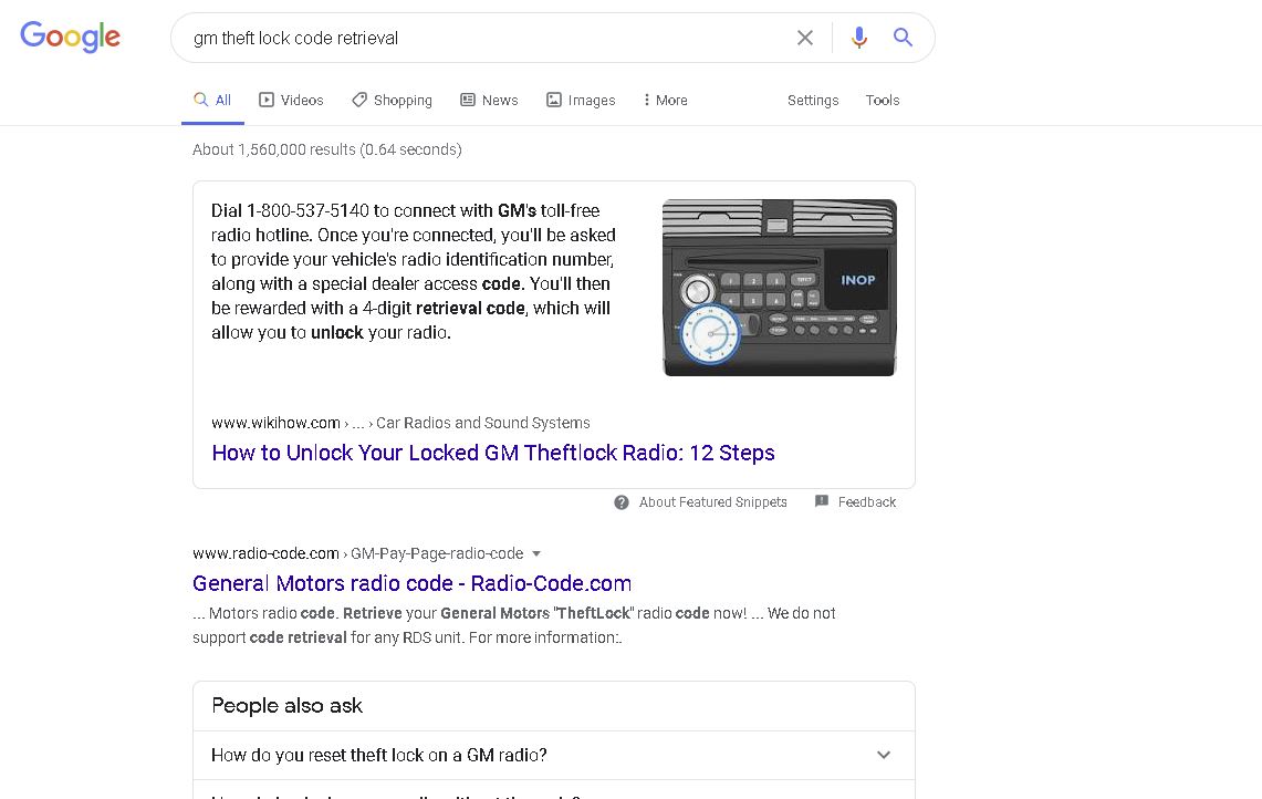

Thank you Doubleleive! Man I got excited when I saw your link. Unfortunately, my stereo is the NAVI kind so they have to hook it up.
I found a place that will do it for $50 (he has a Tech2) but he's wondering if he'll need special software and said that if he did need it, it would raise the price about $90. Of all I've read about it, I haven't seen anywhere that someone needed extra software on a Tech2 in order to make it work.
30,773
48,479
google like I did and follow that first link
The tech2 will have to be connected to a pc serial port, the $40 fee will have to be paid to acdelco tds, this fee gives you 2yrs unlimited programming (per vin) so it is only for your truck.
the software is free and is all java based download thru the internet and there is no additional software needed or required other than windows operating system.
