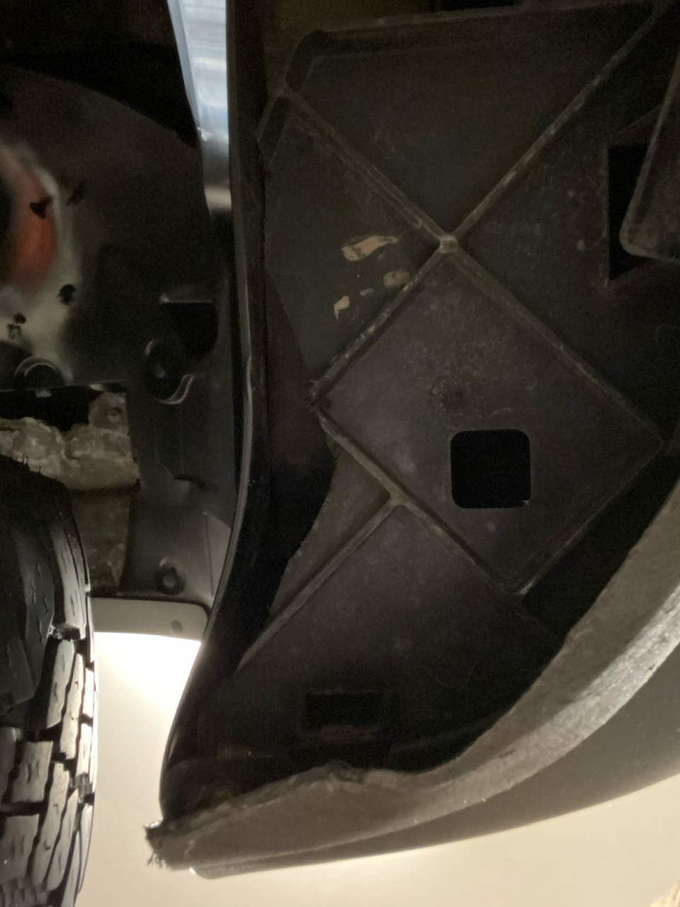

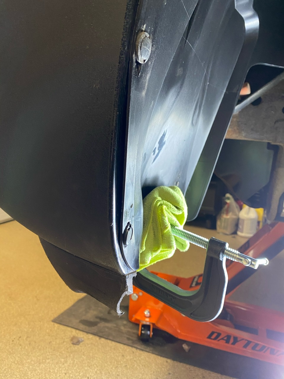

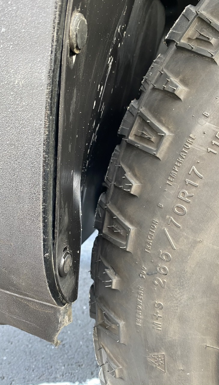

I just wanted to mention that you can do a couple fender tricks in the front to run larger tires and/or more aggressive wheel offsets. The first is to cut the plastic backing, heat, and remold the front (of the front fender liner):
(I have a 2” wheel spacer on).
And here’s good instructions on how to do the rear:
https://norcaltruck.com/2007-5-2013-chevy-gm-large-fender-mod
Just mentioning all this in case you find your tires rub a bit.
