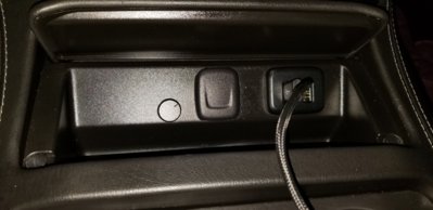

i am in the process of installing a subwoofer and amplifier in my 2016 yukon slt.
I am looking for the best spot to mount my sub remote control knob
Can i have some ideas please

Mounted mine in the space where the 2 usb ports are in front of the cupholders

I like that. Does that piece just pop out?

I just pulled the whole console (cubby, cupholders, etc) and drilled from there. I missed my mark because I wanted it further to the left but whats done is done ahaha. The console containing this cubby and cupholders just pops out.

This what i am going to do i think
But i have a yukon slt not a denali or ltz so i dont have the cover to hide it after but i don’t care
