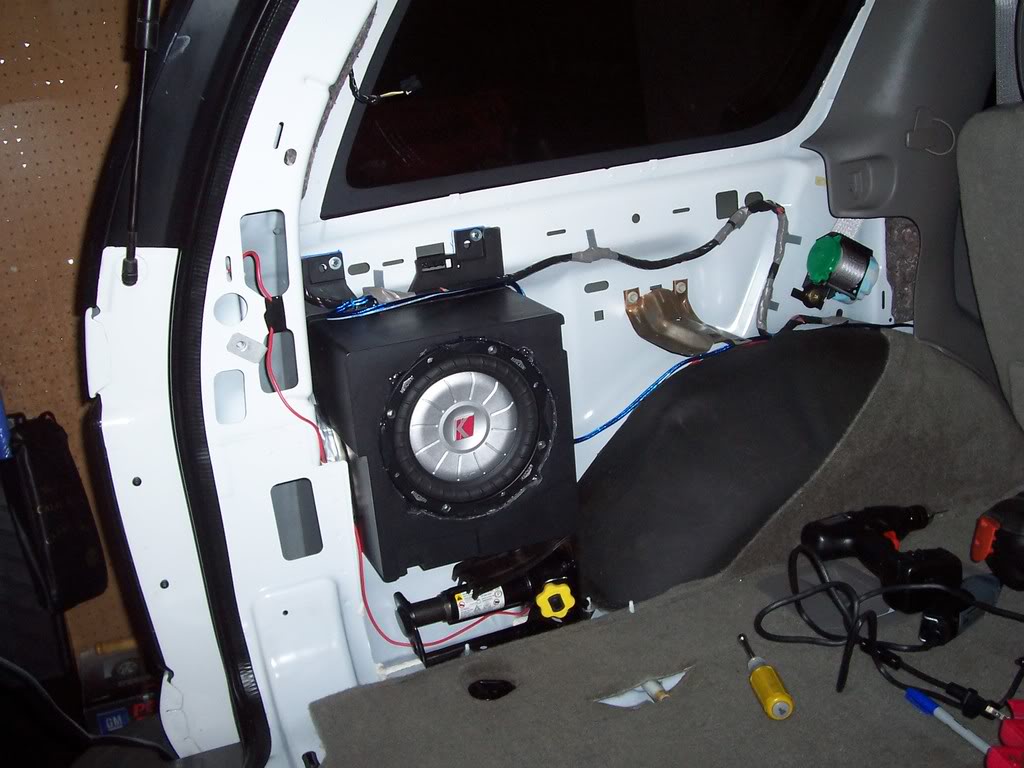

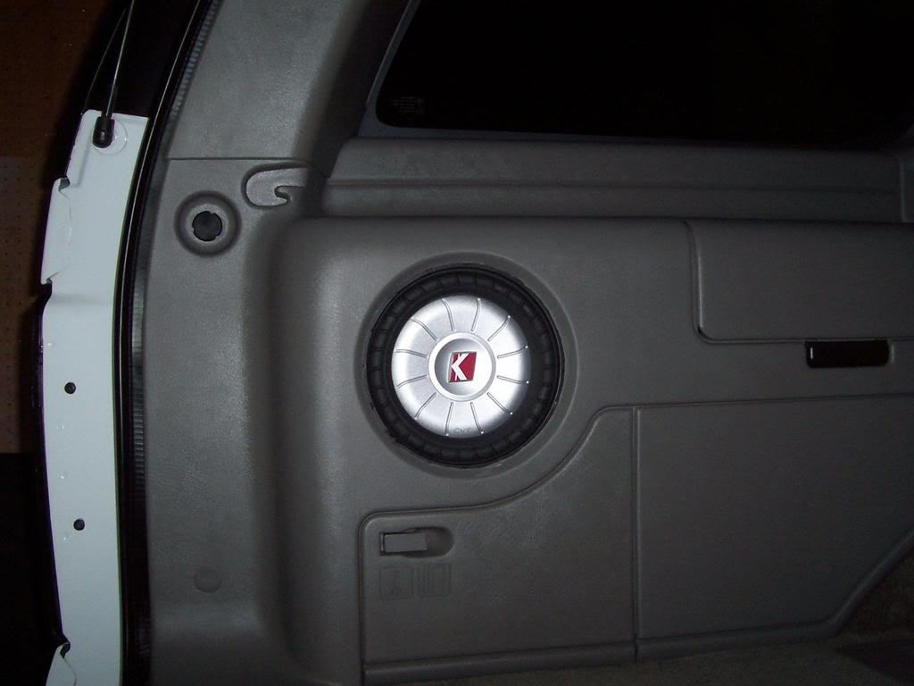

There is space where the 2000-2002 subwoofer used to be.
It isn't much space, so if you want to replace the driver in a factory box, you will need shallow mount. It will tuck out of the way, and completely disappear, just like factory.

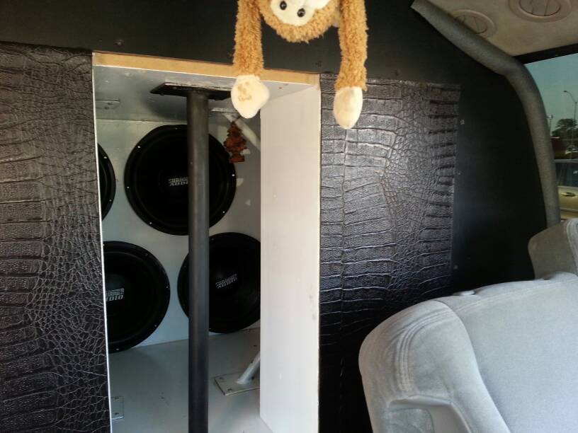

Just do a wall
Sent From Your MOMS Bed
That's nuts. I can hear it from here. Nice rig.

In the process of putting in a rear sub from a 2001 Sub into my 2005 Sub, I found out that while the mounting space is still there, the mounting cleats are not.
There are four metal U shaped tabs that keep the factory sub from rattling around bouncing back and forth between the interior plastic rear quarter panel trim and the interior layer of rear quarter panel sheet metal. One of the holes is already in the sheet metal, and only requires a speed nut and a bolt to install. The other three tabs are MIA. They are U shaped brackets that the factory welds into place.
I ordered these brackets, and plan to JB Weld them, or use 3M Body Adhesive, to fix them into place.
No point in trying to improve sound quality by creating a new vibration or rattle over the bumps by securing the sub with only one mount. One mount is merely a pivot point. It takes a second mount to keep an item from rotating.
The brackets came in the mail today. With shipping, the new mounting brackets cost 3 times what I paid for the used subwoofer. Add to that another $10.00 for the new factory connectors I ordered (shells, pins, sockets, and TPA's) to mate to the existing factory connector on the sub.
It costs money to make it REALLY look factory.

JB Weld did not hold up. I ended up drilling, deburring, self etch primering, painting, and sealing holes for the factory cleats to hold the subwoofer, and then bolting the brackets in place through said holes, and then covering with flexible seam sealer afterwards. Just to follow up on what works and what doesn't. The cheaper way would be Keith's butterfly bolts. Epoxy alone will likely not be enough.
