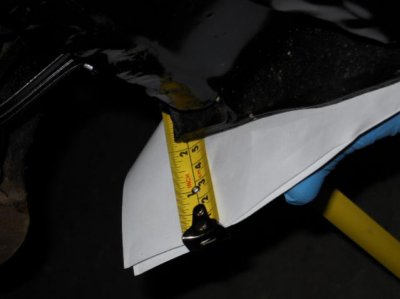

How much did you trim? Just to give you an idea, with 2.5" front lift and 285/65/18s I had to trim about 2 inches off the front well wells. This in on a Z71.

I will post pics asap... I installed the lift/leveling kit today. I cut the metal behind the front tires up until the pinch weld then bent and pounded the pinchweld flat then cut some more. I have done alot of little things to her also.

Here is a pic of of the area I cut out. The paper represents what I cut out. DSCN0174.jpg
