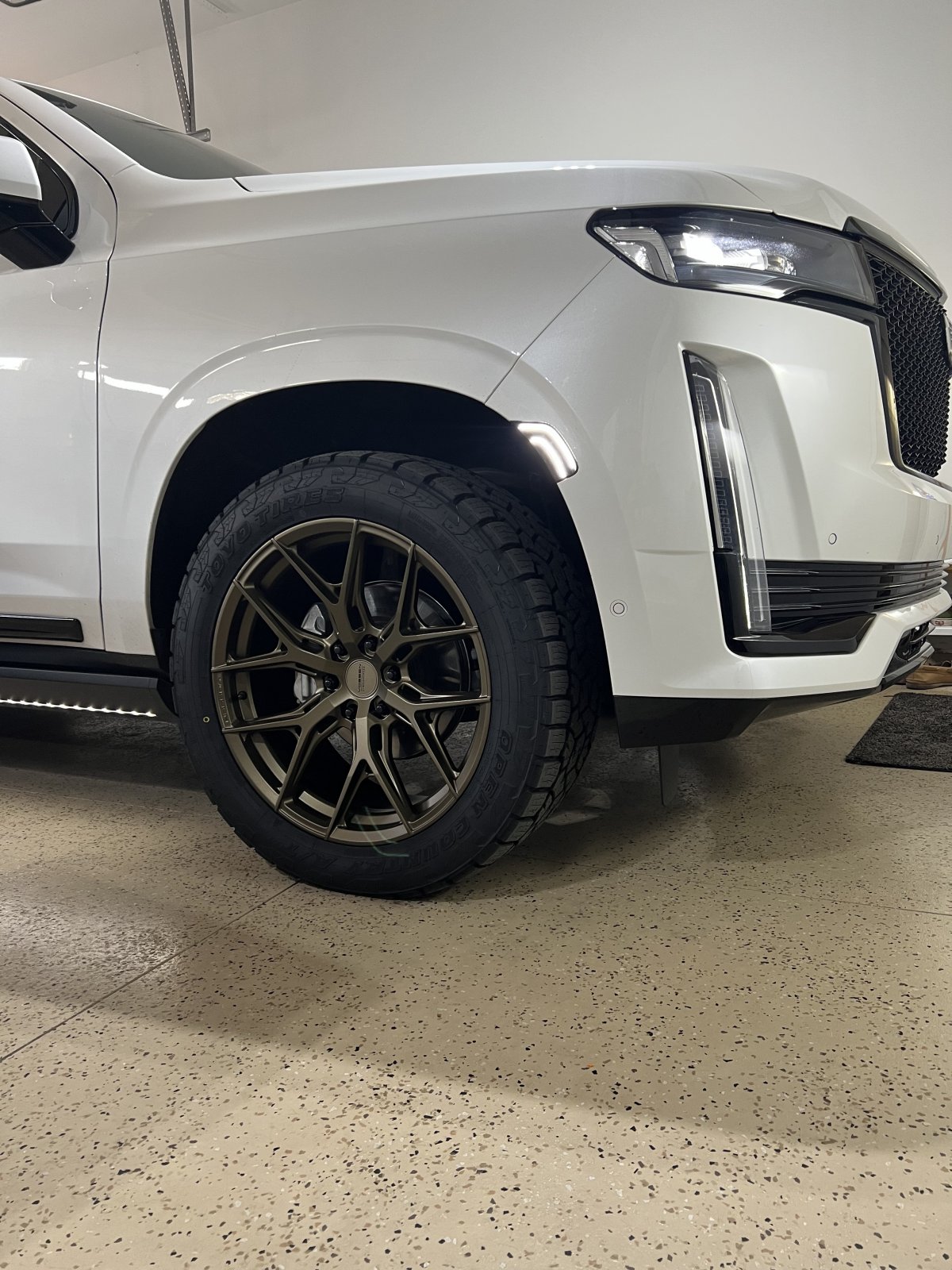

How much clearance is there? Looking at some Vossens that are 9.5 wide with a 20MM offset and wondering if the 305/45/22 Toyo AT3s are going to fit / rub. Seems like the factory wheel is 9 wide with a +28 offset (so this would be ~14MM further out than stock setup).
Would definitely be cutting it close, but probly just need the felt liner pulled back at most.
CharlesC
Jul 26, 2023
The deed is done. 22x9.5 Vossens with 305/45/22 Toyo AT3. It's really close, but haven't rubbed yet.
