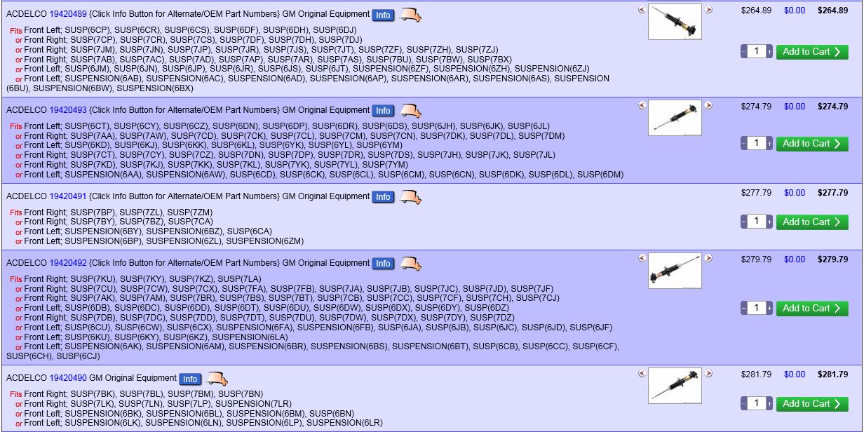

I skipped the ACDELCO ones since they didn't look like ones that fit Z55s, or am i missing something?
yes the ones I pictured are auto-ride shocks, i replaced mine with the 491's on my denali, all those ac delco from RA now have a lifetime warranty as of 2018, i bought mine 2017
just match the code in the list in the glove box
