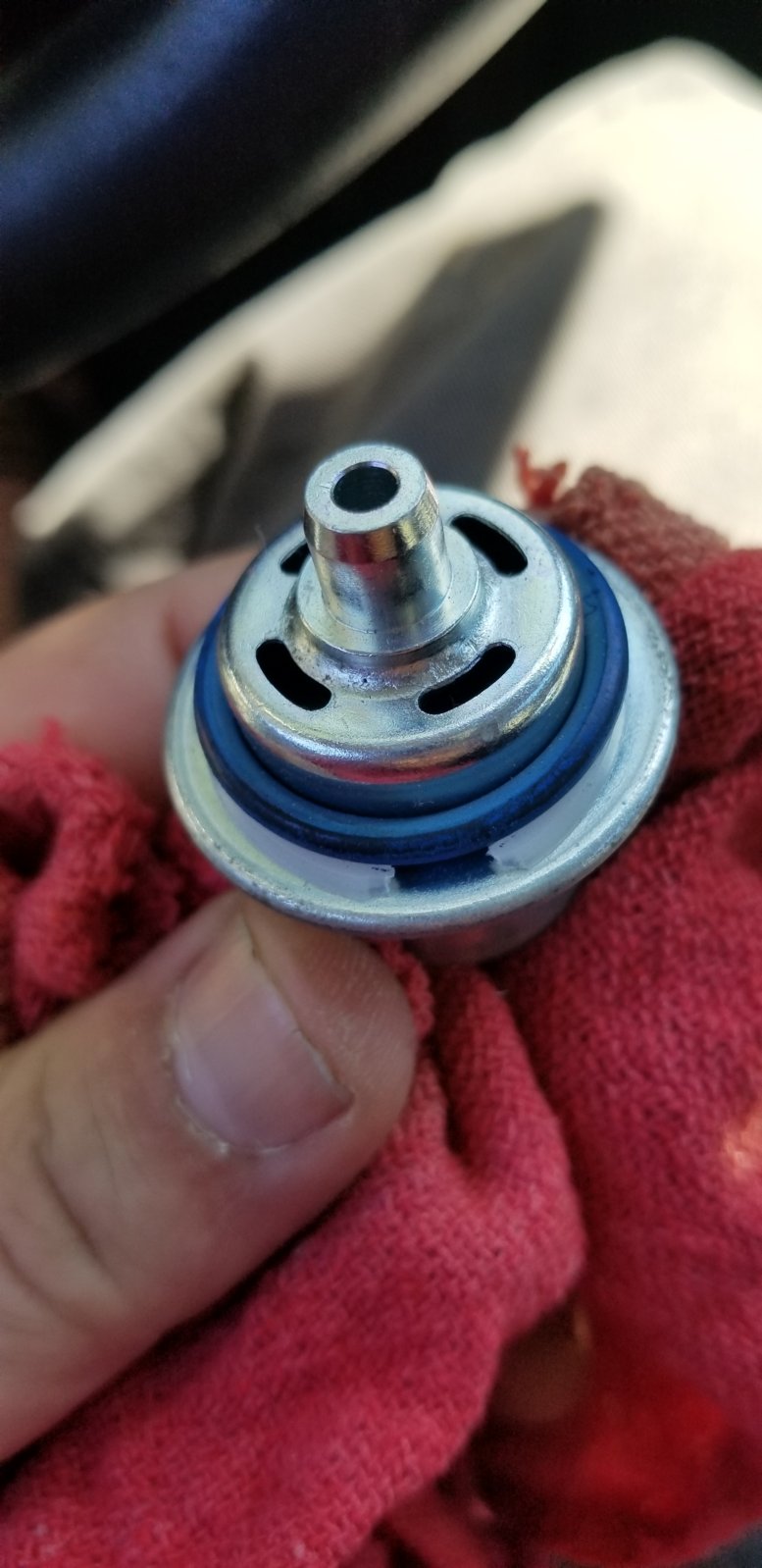

Problem with the gas smell solved. Pulled the fuel pressure regulator and you can see the back plastic gasket is broken.

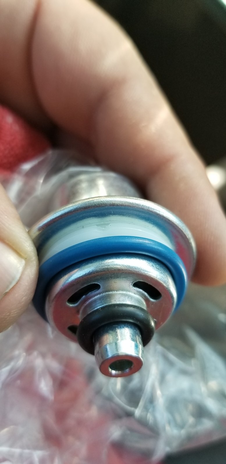

Took it to autozone and of course they dont stock that gasket, but the part was still under warranty so they just swapped the whole part out. Looking at the new gasket you can see the plastic ring has a small notch in it. Looks like a probable fail point, is this a manufacturing defect or designed this way? See below.
Any thoughts? Would there be an underlying problem that would cause this failure?

Did you lube those orings up with some petroleum jelly or at least some oil when you installed them?
The plastic is probably just a spacer to put the oring in the correct place in the bore.
I have seen those regulators leak through the vacuum hose before. Hopefully it didn’t slowly over fuel the truck and burn out the cats.
Get the regulator back in and clear the codes. See if they come back before you buy more parts.
