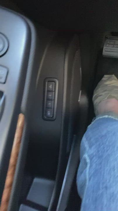

This is my wifes 2018 Tahoe. 17k miles. We purchased it about 2 months ago. About a week after we had it home it started making this horrible sound. The sound is random... some days it's worse than others. Some days it won't make the noise all day.
We thought the sounds was coming from the drivers side vent (wife is holding the end of the phone up around the vent, just so happens the video is pointing down at the floor).
Here are some of the things I have observed....
- Sound happens at very low speeds, around 25-35 mph.
- Only makes the sound when moving, not at a stand still.
- Happens even when all of the climate control things are turned off or on.
- Seems to happen most of time when coasting and down hill (not accelerating).
Since making the video I have removed the drivers side dash vent... still makes the noise. Stuffed a towel in the vent tubes, still makes the sound just as loud. Pretty sure it's not coming from the vent.
So then I removed the side dash fuse cover, the lower trim cover (under the steering wheel), the light switches, then the door panel, the trim around the inside of the window and then last was the drivers side mirror. I also taped up the outside of the door seems. STILL MAKES THE NOISE!
I can hear it so clearly but for the life of me can't figure out where it's coming from. I can't even tell if it's a wind noise, vibration noise or mechanical noise.
It is going to the dealer tomorrow, but my fear is they will say they didn't hear it. I sent the below video to them last week and the service manager said... "sounds like normal wind noise". What sucks is with all of this Coronavirous crap I can't even do a test drive with them.
My wife said if the noise can't be fixed she doesn't want the truck (I can hardly blame her, it's annoying as hell).
Any thoughts or suggestions on what I can look for or have the dealership do? Should I contact GM if the dealer gives me the run around. Any help would be greatly appreciated.

doesn't sound like normal wind noise at all, it does sound like maybe it is coming from outside though, do you have a bug shield or any window visors installed? anything aftermarket on the vehicle?

could be a vacuum leak - possibly one of the hvac components.

I don’t believe it is wind noise. The fact that it happens mainly on deceleration and coasting, it could be a vacuum leak somewhere as Derek suggested.
Might try holding or taping the phone in different positions like under the dash or if you’re brave to the top of the fuse box cover under the hood to see if that helps pin point the sound better.
If you roll the window down and stick your ear out the window can you hear it from outside the vehicle? If your wife drives past your house and decelerates, can you hear it while standing beside the road?

I was thinking an exhaust heat shield or something when the wind and vibration is just right, maybe something in the engine compartment, like a piece of plastic (fuse box cover, etc.)

There is nothing aftermarket on the truck. You can not hear it outside of the truck, it's definitely coming from inside . I'm leaving now to drop it off at the dealership. Hopefully it will make the noise for them (as I mentioned it is random). I told them they can have the truck as long as needed. Need this fixed.... driving us (especially my wife) crazy.
