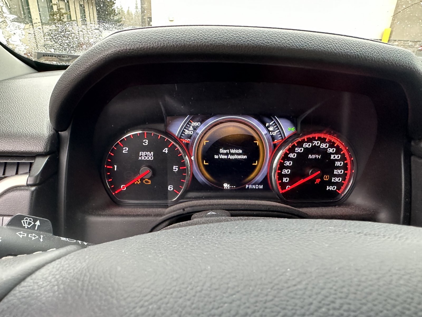

This lead to the car finally failing on my wife she was leaving work one day. She started the vehicle and went to drive off, and the dash popped up with a notice saying Start Vehicle to View Application, but the engine was already running:
The vehicle was already driving so this warning didn’t make sense. All of the gages were as shown as she drove. She stopped on the way home to do an errand and when she got back in the vehicle, it wouldn’t start at all. This lead to having it towed to the dealership for them to diagnose. I was not unable to do it myself because I was away for work.
