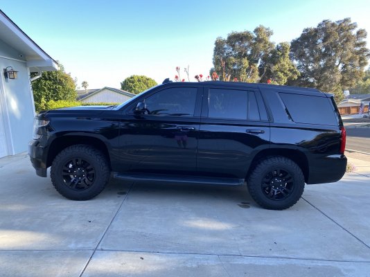

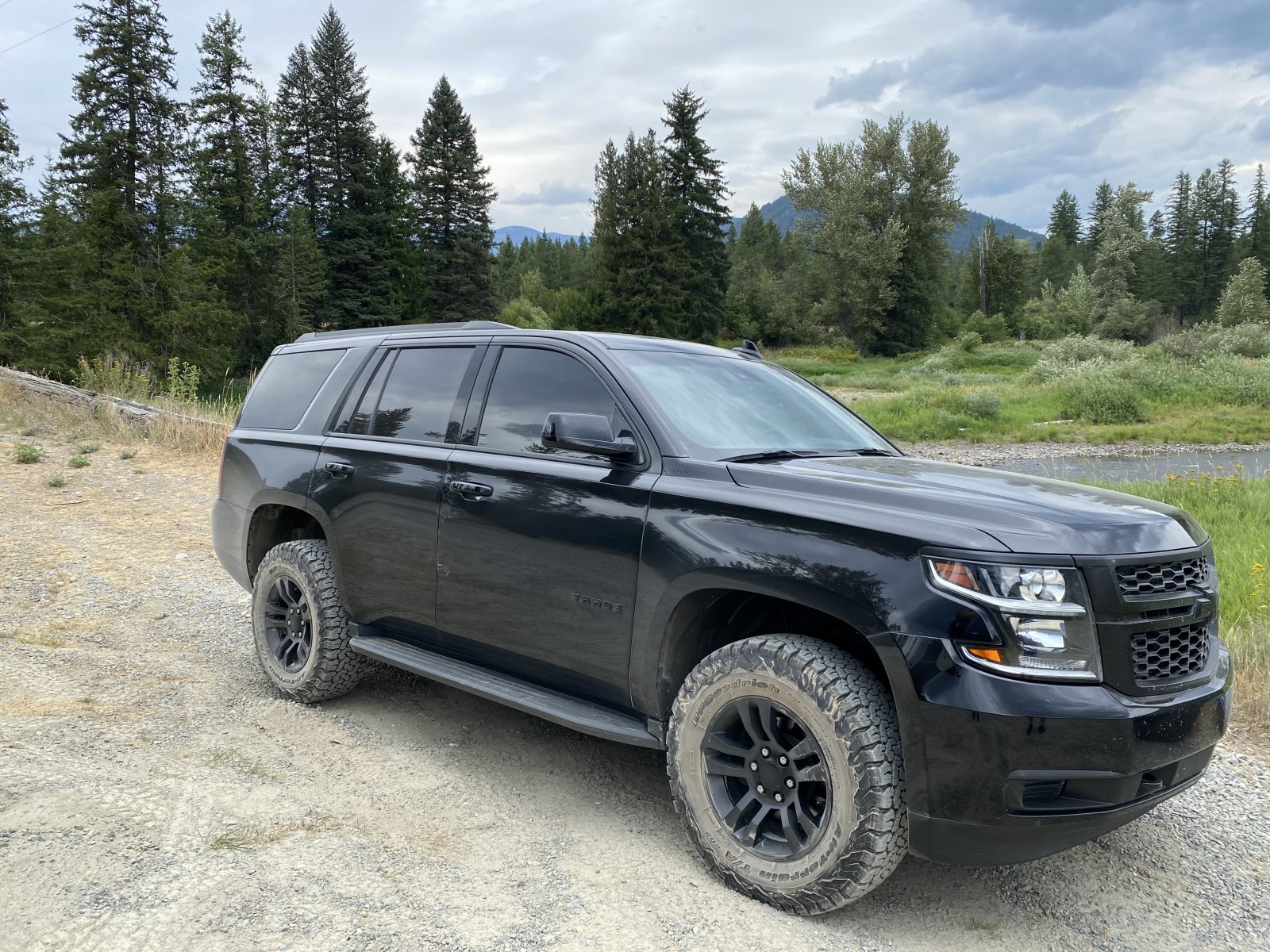

To go any much bigger than the stock tires, you're going to want to do a front level.
I have a 1.75" front level (achieved with Bilstein 5100's) and run a 275/70/18 BFG K02 tire on stock wheels, and it looks great and I have no rubbing here.

I hear your concern but you’re not going to void any power train warranty by leveling the front of your Tahoe 1-2 inches.
I like the bilsteins. They ride very very smooth. Much better than stock - which is to be expected for their price compared to the stock GM struts.
I daily drive my Tahoe and also take it on road trips and to the mountains in summer and winter. I appreciate the added front clearance with the bigger tires, the level, and the trimming of the air dam.
As far as spacers and coilovers vs the bilsteins… the spacers will be the quickest and easiest to add and remove as you please. The bilsteins will level the front almost perfectly with the back and for the price they’re great. Coilovers cost much more and from my understanding will come with a much more tunable ride. Aka they probably can be softer and smoother etc
There’s no right way to go about it. Just think about what works best for you.
