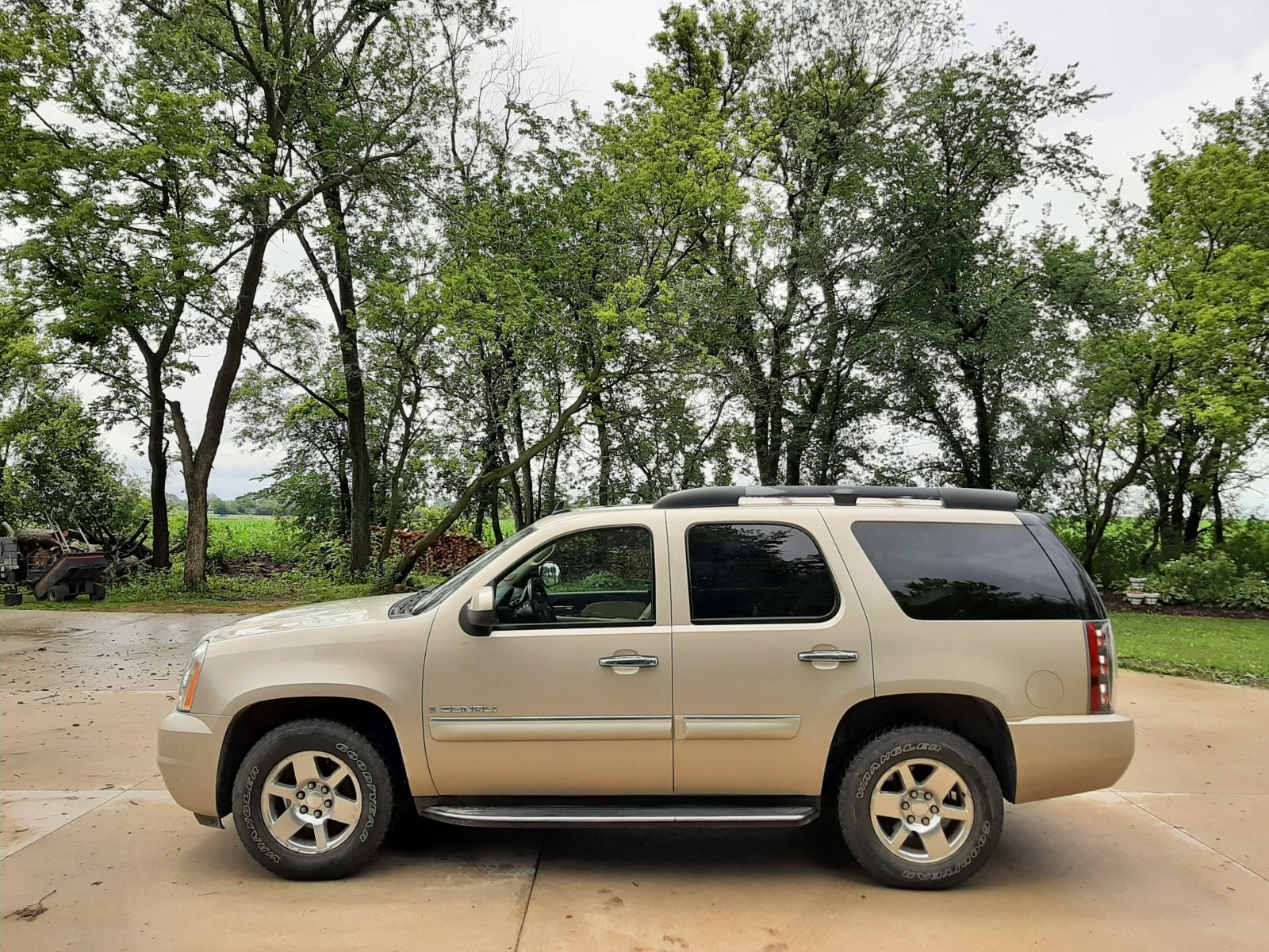

These are my factory 18 denali wheels. They were from my 2007 years ago. I keep them as winter wheels for my 2017. They had the same white crap from salt that eventually got under the clear. I stripped them and attempted polishing but found that some of the corrosion spots were too deep to polish out. So, I wet sanded them until they had a uniform brushed look. 3 coats of clear and back in business. They aren't as shiny, but they are clean.
