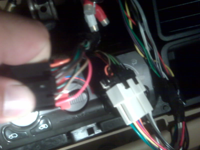

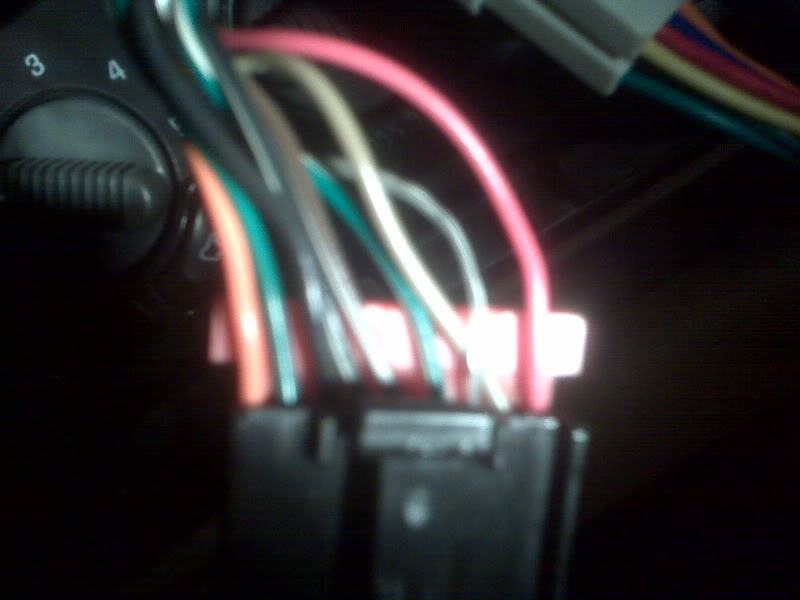

ok, tried that..... still nothing. Below are the pics of my wiring harness. The wire on the outside is a red/pink one. I assume this is the one you are talking about needing to jump. I haven't cut the wire yet, I just tried running it to a (HOT) point in the fuse panel. Still after doing that, no sound still. I even tried attaching the black (ground I assume) to a ground and the red to power, still nothing. Any other suggestions...... I really want to get this working so I can do a 2din mod after I get the flip out working. Don't really want to start cuttting the dasn bezel until I know I can get it working. Thanks.....

I believe you have the wrong harness. the other 9 pin harness is for the on star ( if you have it) the correct part number is GMOS-11 from metra 2000 GMC YUKON 4DR SUV WITH STANDARD AUDIO SYSTEM. Hope this helps

Is pin 8 (orange wire) powered up also on the main harness? Your aftermarket wire harness adapter should have the blue remote turn-on wire in this location. That will need to be hooked up also.

All you need is the standard 1858 harness from Metra, wire up the remote turn on wire from your deck to the blue wire on the metra harness and the pink wire on the secondary harness.
