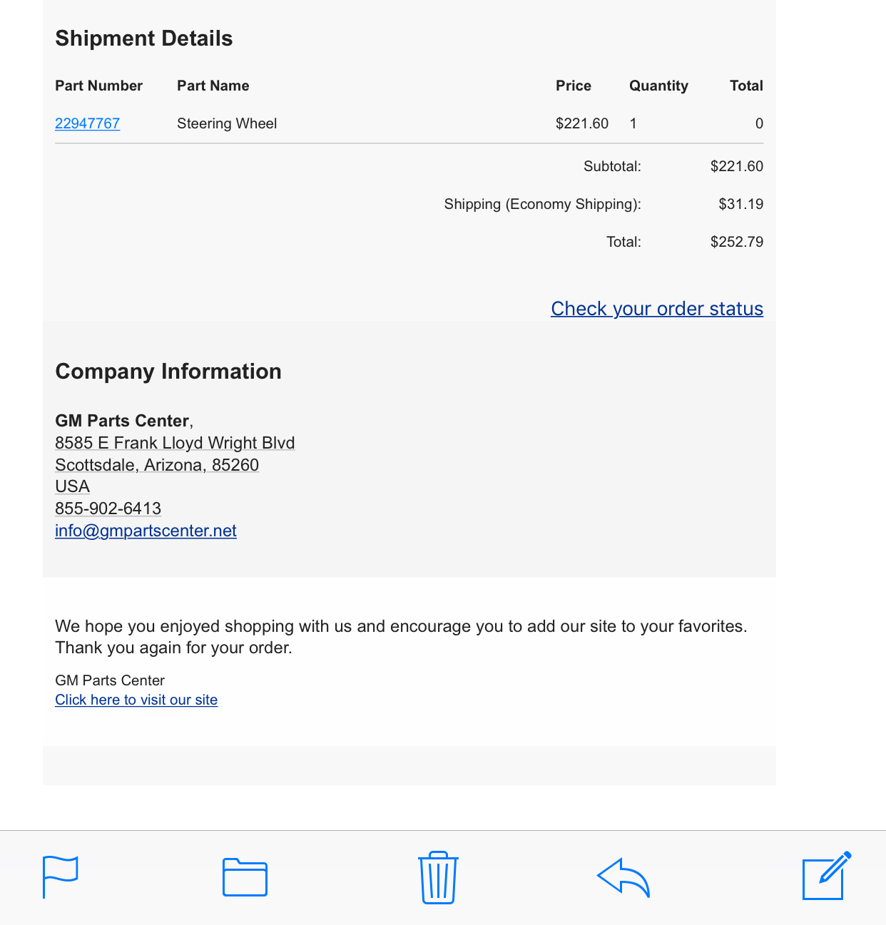

I really like the heated wheel in the ‘19 yuk so on 5/30/19 after reading these posts i google searched 22947767 and came up with many discontinued part etc until i saw gm parts center in scottsdale arizona....didn’t think any were available so put in an order thinking it would be cancelled......also for ***** and giggles just to see what happens ... got an email next day saying they were on backorder from GM and I would get and email when shipped....check bank account and paypal took the money the same night....... well thanks you two because now it’s being shipped and NOW i have to buy a clock spring and harness....smh

Lucky dog and they are inexpensive too! That's about the same price as a regular wheel assembly! I've been wanting to upgrade just because but too many other things in front of that expense.
Here's what I came up with for the extra parts needed to retrofit:
Harness 25807858/60296271, SIR Coil 25966964
Let me know if you think these are right or wrong.
Oh, GM Parts Center has been great! Nearly always the lowest price and all orders executed flawlessly! Just got my third finish panel from them yesterday!

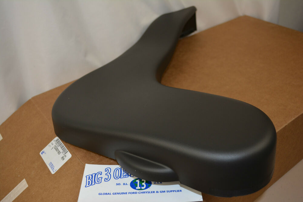

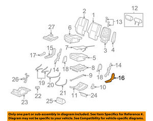

What's a finish panel James?
21,287
30,223
On the side of each seat is a plastic panel that covers the internal workings to allow it to recline and fold. The passenger side inner one has been replaced 3 times in two years! People keep stepping on it, kicking it or slouching off the seat and breaking it with their behinds. First was broke when I bought the truck, my oldest daughter broke two of them and then some drunks broke the third. Their are two retainers and a long threaded pin that do most of the holding power. The long threaded pin doesn't grab anything anymore, so it was sticking out a little bit. We can take the seat out and apart but I think some RTV and a bungee will suit these sore muscles and bones better today.

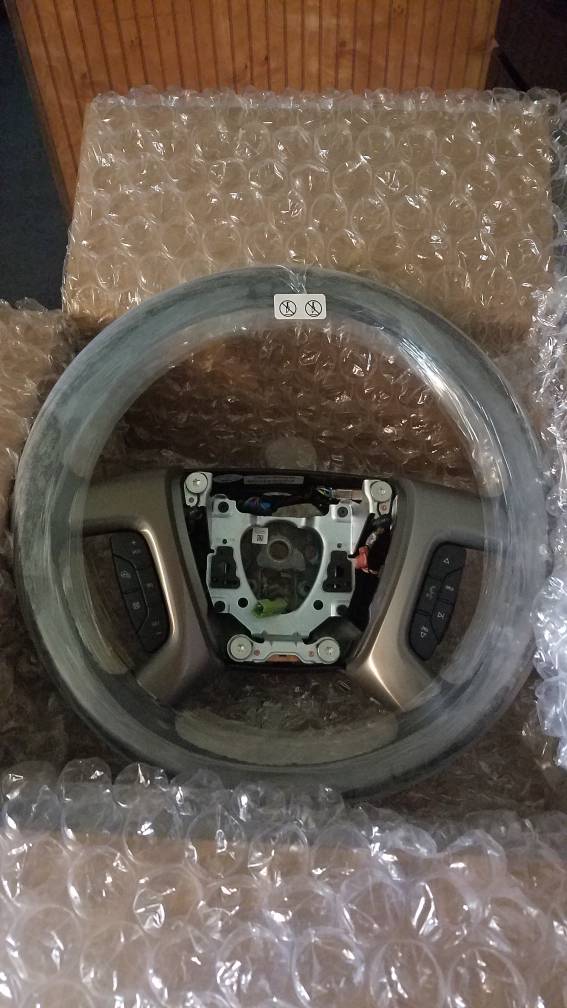

Wheel was delivered today! Probably install it this evening or tomorrow.

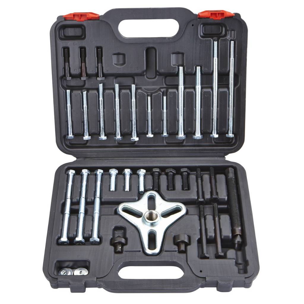

I don't have a steering wheel puller specifically but I do have a threaded universal type pulley/wheel puller. Anyone know if this will work?

I used to pill the wheel on my Firebird with the same kit. I think it should work.
EDIT--,My bird didn't have an airbag.

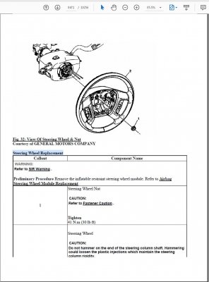

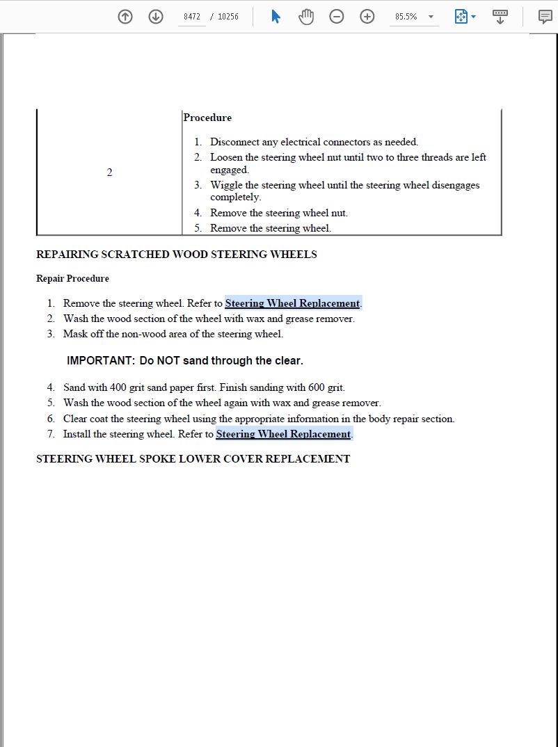

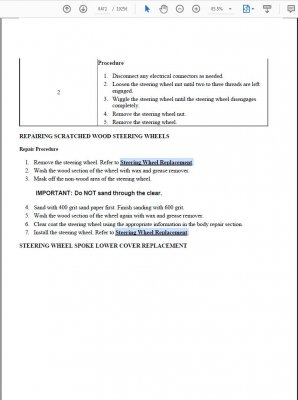

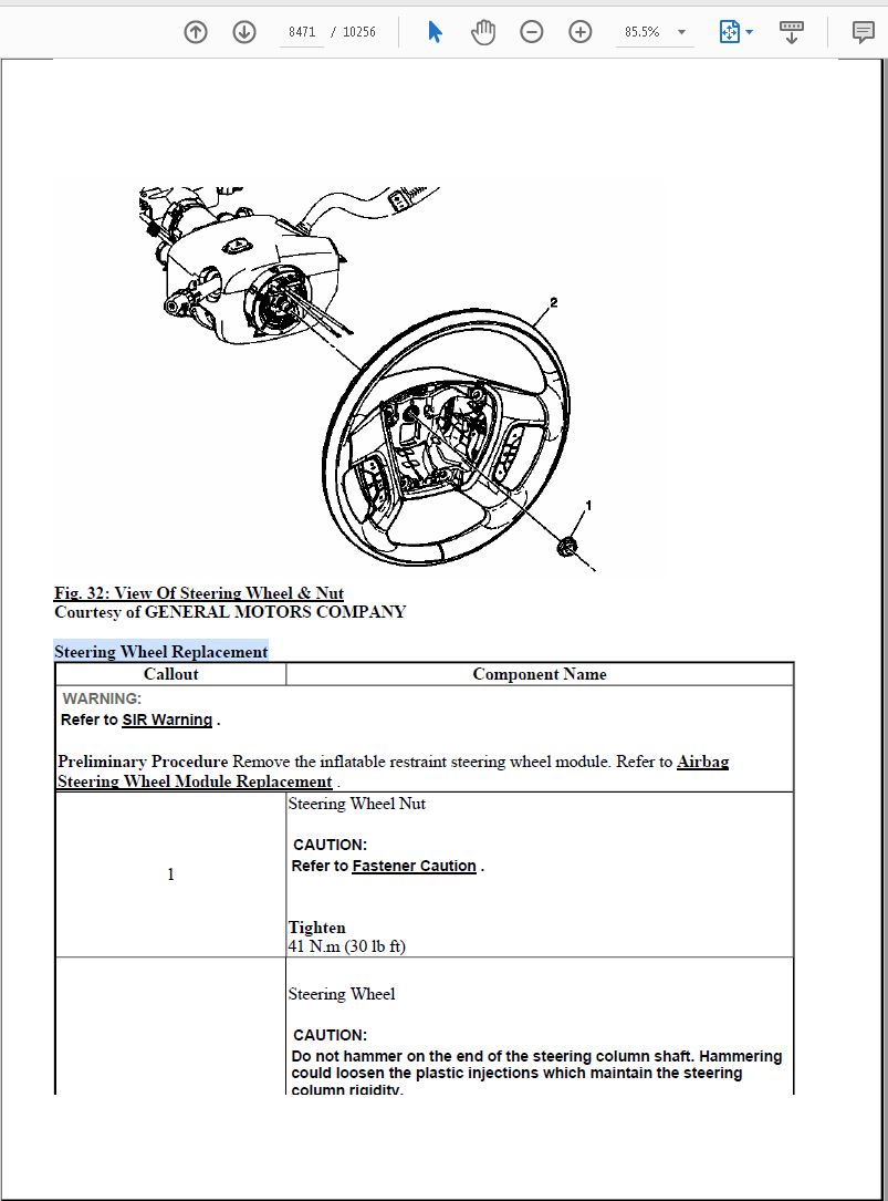

I haven't done mine yet, but after you have disconnected the battery and take off the airbag, the service manual says
Procedure
1. Disconnect any electrical connectors as needed.
2. Loosen the steering wheel nut until two to three threads are left
engaged.
3. Wiggle the steering wheel until the steering wheel disengages
completely.
4. Remove the steering wheel nut.
5. Remove the steering wheel.
when putting it back on the torque spec is 30lbs
***it also states not to bang on the center column with a hammer as it can loosen the sleeves that keep the column rigid.

That will work.
Also, you can put the nut on a few threads and give it a rap or 2 with a rubber mallet, it will be fine.
It will come off with that puller though.

Thanks guys, got it on. I was going to use the puller at first, but I didn't have any oval headed bolts to use and I didn't feel like grinding some down on the bench grinder. So I did like Doubeleive posted, leaving the nut on loose, and pulling side to side. Torqued new one down to 30ft lbs
