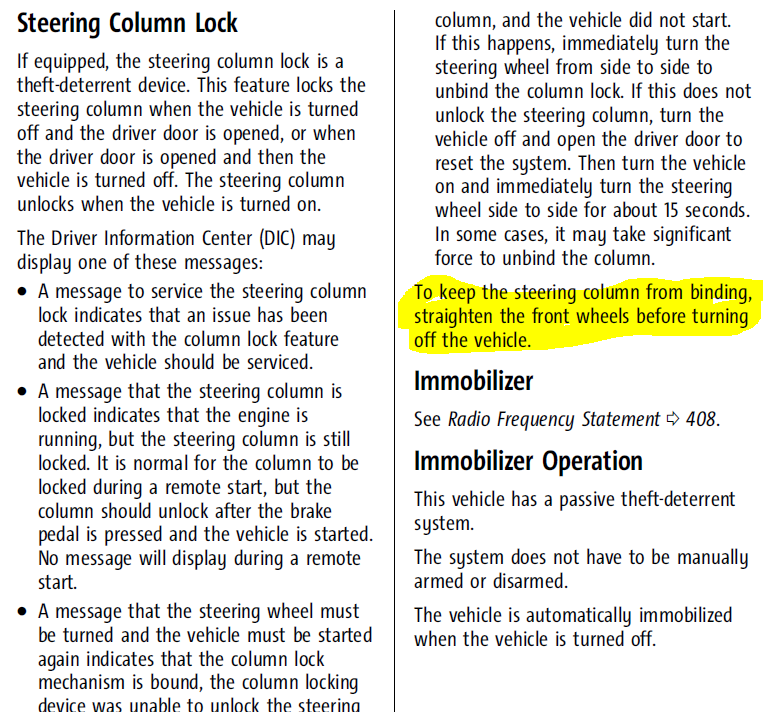

Hey all,
Had a big problem today on my brand new Yukon Denali, when installing my WeatherTech mud flaps. I needed to turn the wheel to full turn to get access to the screws in the wheel well. So after I get the passenger side installed I proceeded to start the vehicle and it is a no go. So I'm like WTF, keep trying to start and nothing, then a message pops up about turning the steering wheel. So I tired to do that and no way, steering wheel is locked up tighter than a drum with no movement at all. Did a quick google search and found some info about this safety feature but still a no go. But did find something about trying a different key, so I grabbed the 2nd key fob. Tried to start again but at first it didn't work, then tried again and then a very loud snap and the steering unlocked and I was able to start the vehicle. Not sure what the hell this safety lock for the steering wheel is needed but to me it's a big problem. If I didn't have that 2nd key fob handy, I had no idea what to do or how to start the vehicle, just wondering if anyone else has run into this problem,

No way, I have had a lot of vehicles and they didn't have this feature, after reading the manual and the info for this feature and it suggests to not turn the wheels and shut the vehicle off. It even states that it can bind up as in the case I had, and what it suggested to "un-Bind" didn't work. Here is the info from the manual,
And to add, I have a 2015 Yukon as well as the 2016 Tahoe, and this so called steering lock never did this as they all had the mud flaps added, so I don't get where you talk about a driving career,
It's a common feature on almost every car. Idk why you highlighted that. I said Jimmy the wheel after it was 'locked' your highlight says to keep the wheel straight to avoid it binding when turning off.
