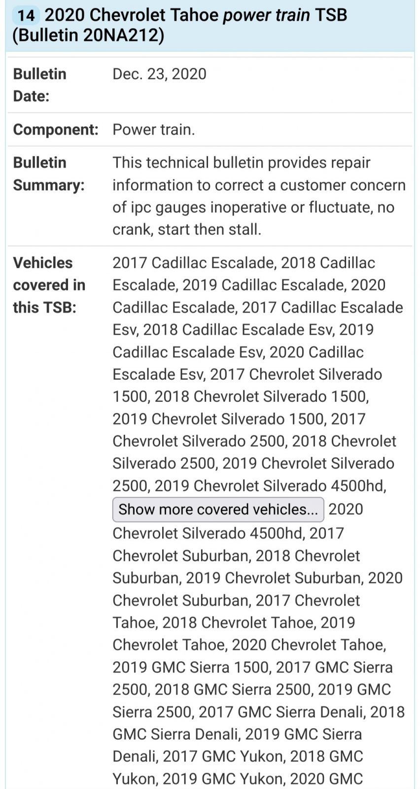

I believe there is a tsb for that. This one rings a bell.
TSB #20-NA-218​
If its not that one search for more or one with your year truck. There are several.

Here are a couple more.

Thank you very much. I'll look into these and see if the stealer can see if our vehicle needs these updates.
