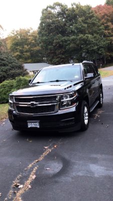

Newbie to the Chevy world. Brought a 2016 Tahoe LS with 70k miles about 3 weeks ago.
Didn’t notice at first, but there’s a squeaky creaking noise coming from the rear suspension every time I go over a rough patch of road or speed bump. The more travel on the suspension the louder.
I’m still under dealership warranty but they’ve had the truck for 4 days now and can’t figure out what it is (dealership is a Toyota dealership).
The truck is only 2 yrs old but sounds like it has a 20yr old suspension! Anyone run into this problem? They first said it was the rotors but now they think it’s coming from the drivetrain.
I did install a magnaflow exhaust about a week and a half ago and have noticed the noise getting louder. Doubt that has anything to do with it but who knows.
Help! I want my truck back.
