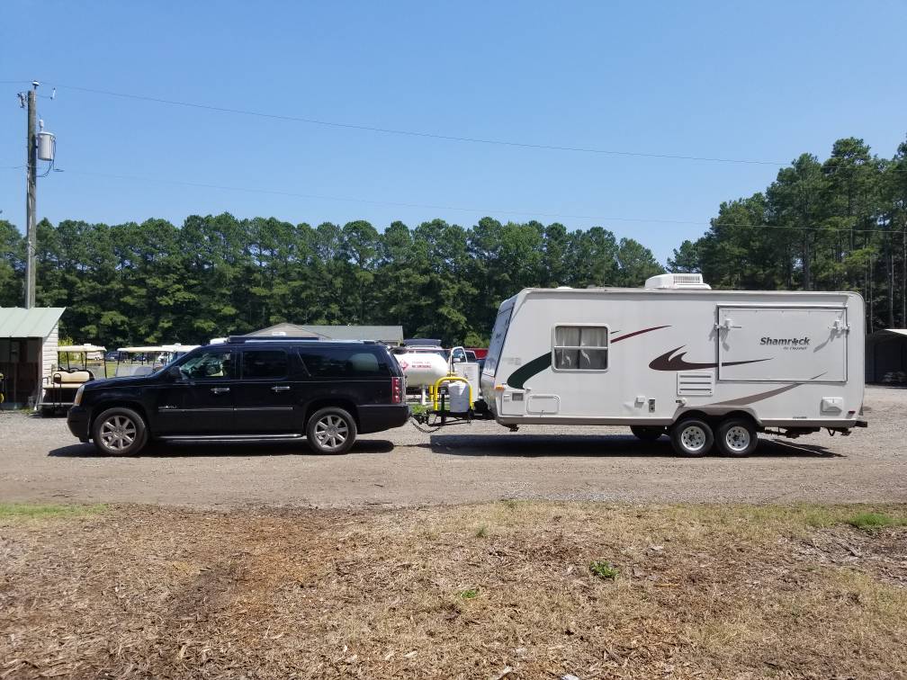

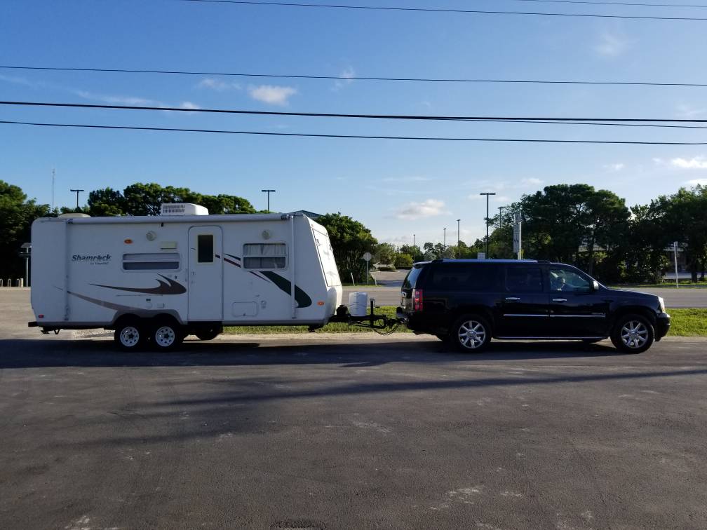

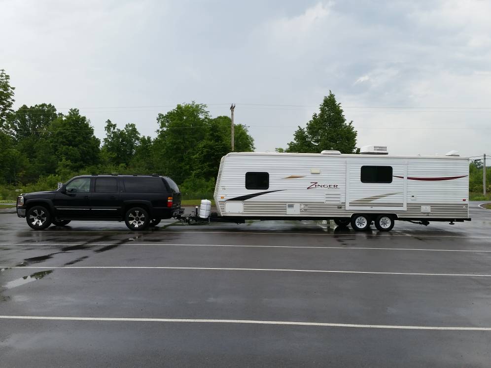

Well, unless you've swapped out the axles and put in freefloaters, installed higher-GVWR brakes, put in stiffer springs, replaced the frame, and installed a new receiver, I guarantee you're overloading something - GVWR, RAWR, GCWR, or all of the above. 8k is way too much for a half-ton truck. You're going to break something, or cause an accident. Hell, my 3/4-ton Suburban is at its limit pulling an 8600-lb trailer.
BB tune, efan, intake, exhuast, and a few other things I can't remember.
But with 3 kids and a great dane I definitely need the space.
None of these mods addresses the weight you're towing - suspension and brakes are the biggest concern. You have a 1500-lb payload, the trailer and hitch probably contribute 1100 lbs. So you, your wife, 3 kids, Great Dane and gear are less than 400 lbs?
M3kanic
Jan 28, 2015
488
289
Well that was the old set up and the picture of what happened to it. Also here is a pic of the new set up.
