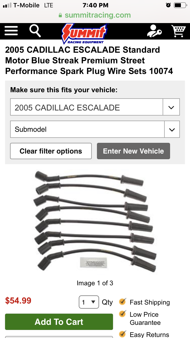

I agree with Ron on the wires but would run the 41-985 or 41-110 or 41-162 Iridium spark plugs. The first two part numbers have been superceded to the 3rd. The first was original equipment.
amazon shows that those wires don’t fit my vehicle
I looked them up at RA and the 6.2 and the 5.3 2007 Yukon took the same wires. Even calls for the same wires for a 6.0 engine.
When I check the vehicle application at Amazon it does say that the wires do not fit but the number came from RA and then I crossed it at Amazon.
At GM Parts Giant the set calls for 19351593 and when you cross that it goes to 748RR.
https://www.amazon.com/General-Moto...r_1_1?keywords=19351593&qid=1579049658&sr=8-1
