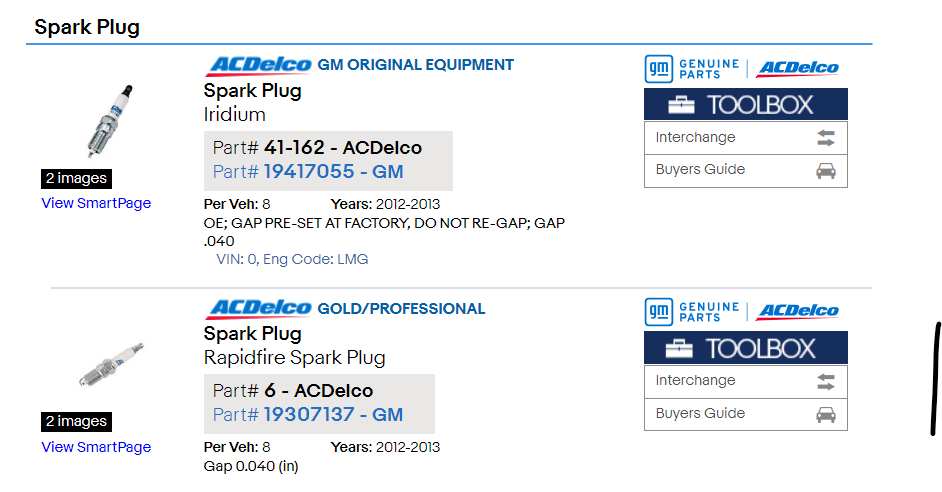

I first ordered from Amazon: 8 AC-Delco 41-962 platinum plugs and 9748HH wire kit which includes the plug boot metal heat shields. I have this in my possession now, and it all looks legit. But shortly after ordering I did further research and most, but not all, recommendations were to stick with OEM iridium plugs, as a perf degradation may occur with platinum. (longevity not a big issue, it will take me a long time to wear out either of those) so I then ended up finding the same wire kit (minus the heat shields) and (8) 41-162 iridium plugs for about the same price, $150, on RockAuto. My thought was I'd send the Amazon stuff back, since it's pretty easy to do returns.
Well now I have the Amazon stuff, but not the RA stuff, even though they were supposed to arrive on the same day. (Not RA's fault, Fed Ex - Grrrr)
I will probably just wait patiently for the RA order to arrive at end of this week, but wanted to check in here. What's the vote: wait and go with the Iridium plugs or just install the platinum now? Would I notice any performance or MPG loss with platinum? I know everyone loves debating spark plugs.

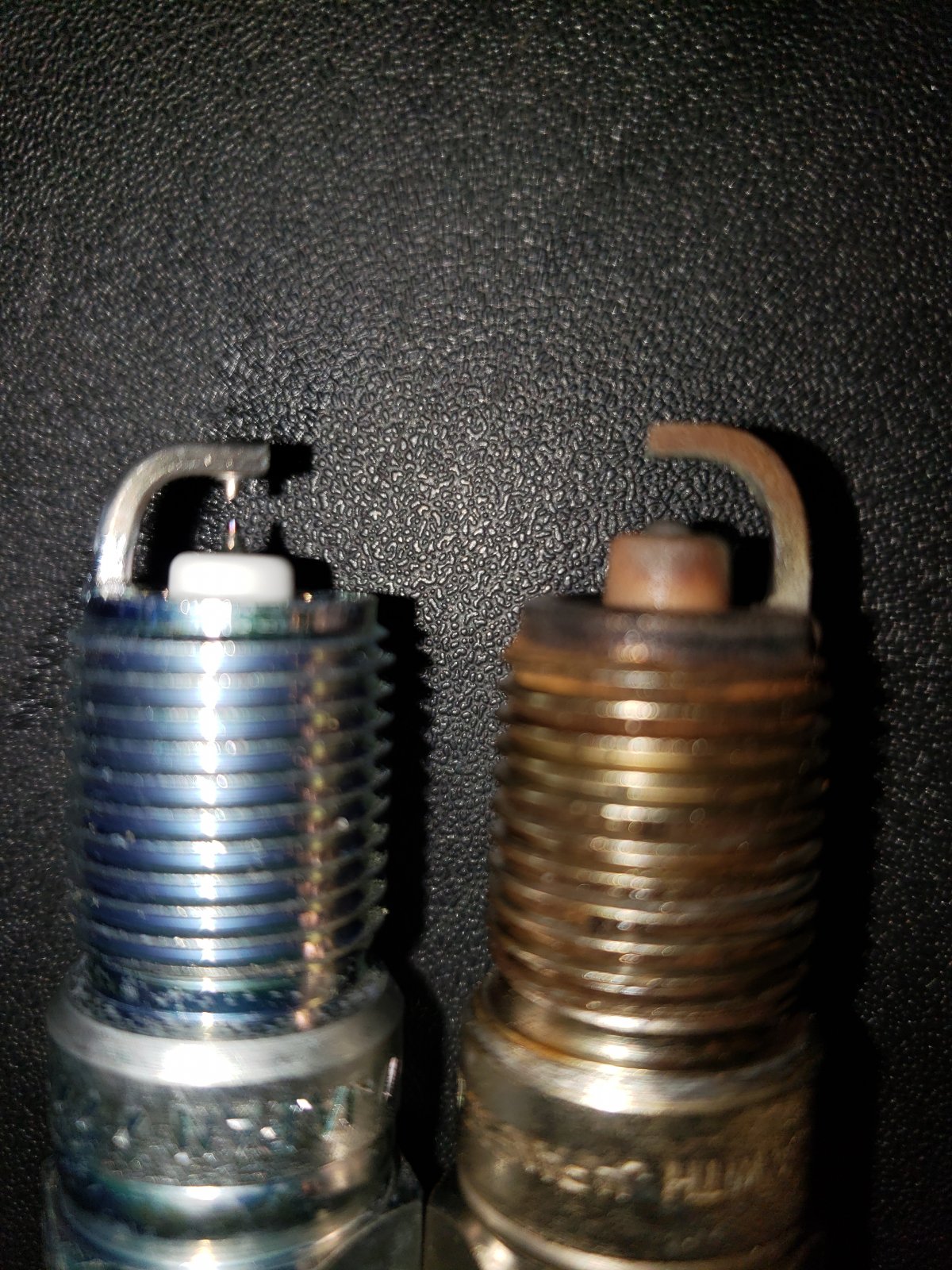

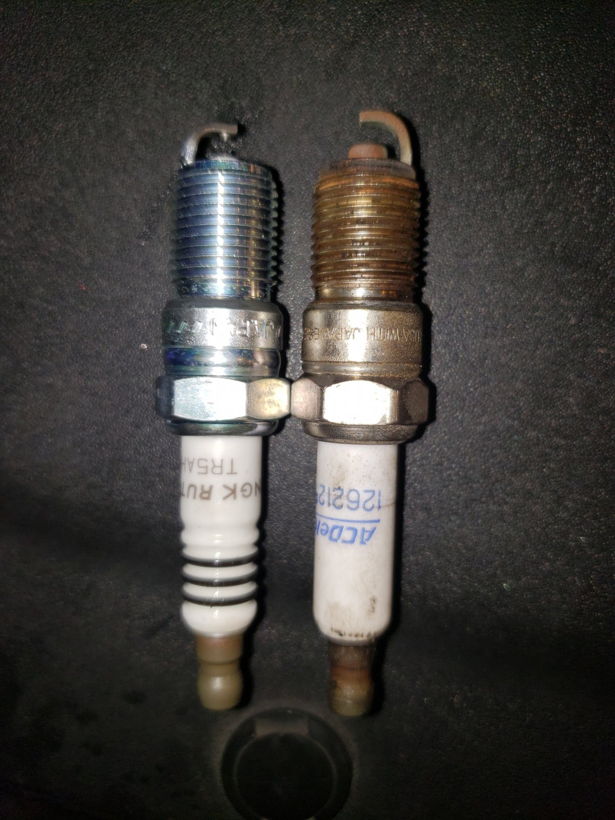

I would wait on the RA plugs.
There are a ton of very convincing knock off plugs on the market.
I bought a set of "iridium" AC Delco plugs from either Amazon or Ebay, can't remember which and when they arrived they looked absolutely legit comparing them to the originals i pulled out. I drove on them for a while and decided I wanted to try something else so I bought the Ruthenium plugs from RA. When I pulled the "iridium AC Delco" plugs out they were so worn down it was shocking.
I have pulled many sets of Iridium plugs at 100k+ miles and they could have been cleaned and reinstalled without any issue. These knock offs were worn down to the porcelain.
Knock off Delco on the right and New NGK Ruthenium plug on the left.
I don't know the exact mileage but I know it was somewhere between 25k and 50k miles on these plugs. So roughly half or less of the recommended service life of Iridium plugs.
View attachment 411641View attachment 411642
