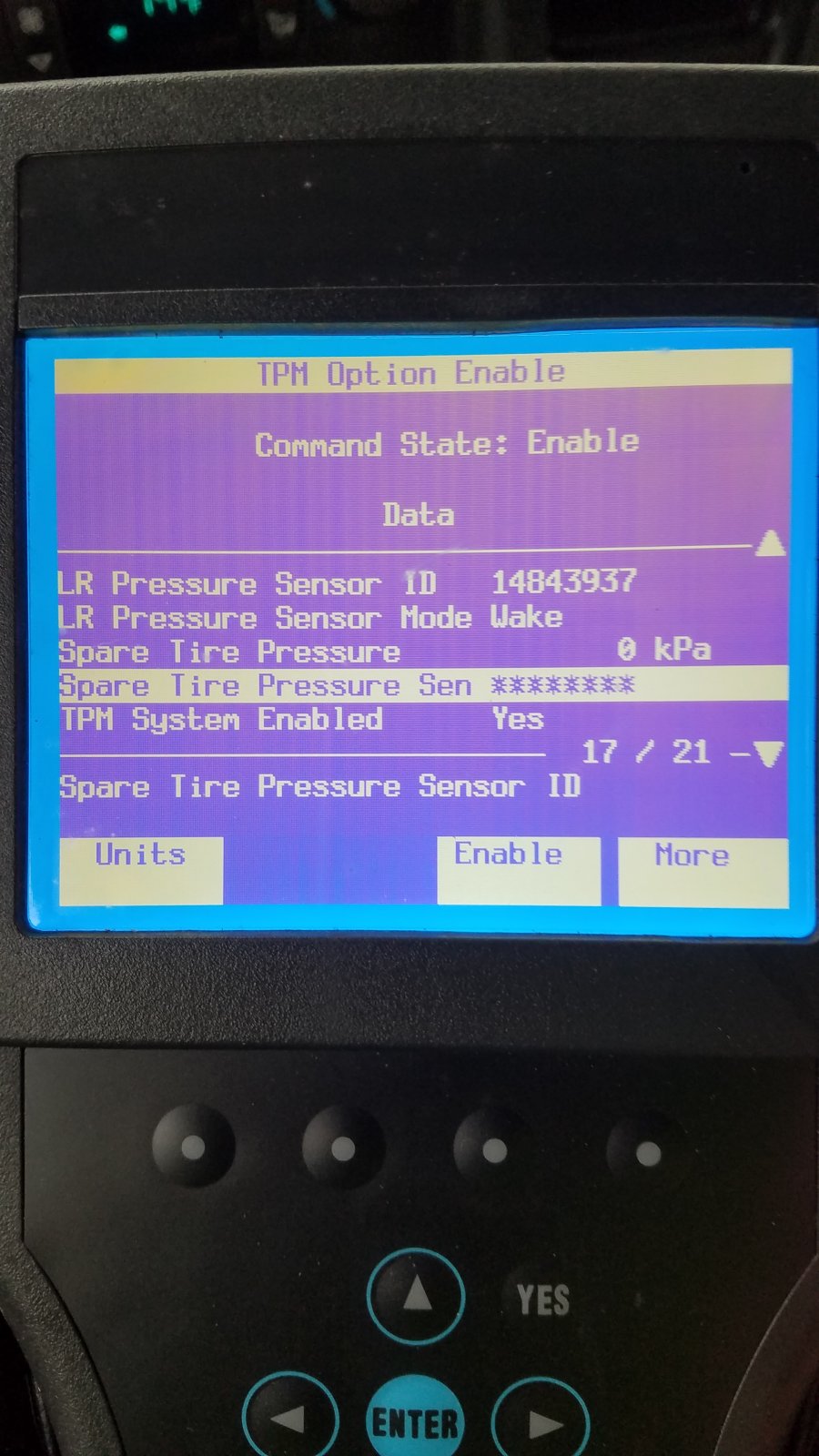

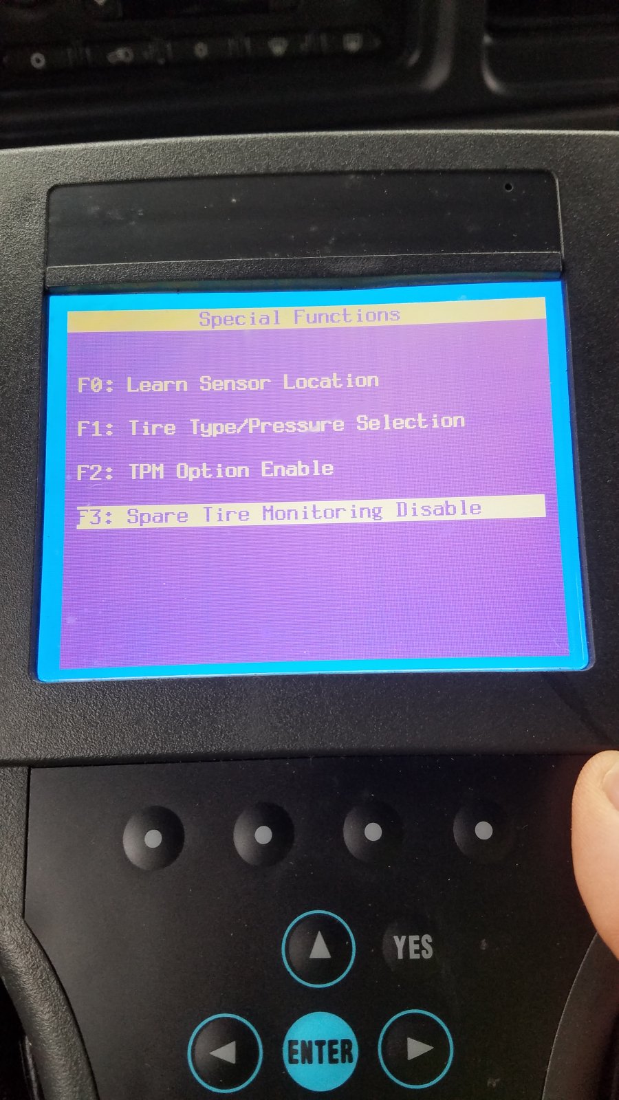

I tried to enable it, every time I use this tech 2 I am bewildered by how hard it is to figure out what it can do.
I found a sub menu that has spare tire Disable, why have a menu item to disable it when it isn't enabled to begin with? Makes no sense to me. So I dunno it's either you can't enable it or it is user error on my part...

There's the button right there to enable it. It's the 3rd button from the left, top row buttons.
Yeah I pressed that but I am trying to remember what it did if anything.
it's just mind boggling to me why there would be a menu item for Spare Tire TPMS Disable, so if the menu item is enabled that means it is actually disabling the function?
So I see the button to disable the function which (theoretically) if I press that it would change the spare tire TPMS disable function to disabled which would actually enable the spare tire monitoring function.
I mean who wrote this code? Translated from Chinese?

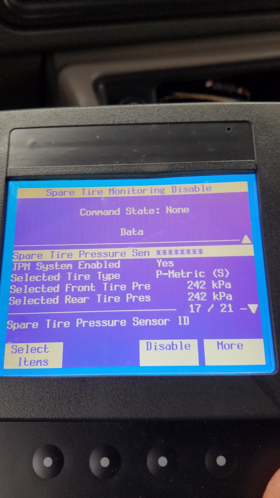

I will hook it up again and try it, so when I press the disable button the command status that reads none right now should change to something? and then I just back out of that menu and go back into the TPMS part and see if anything changed?

I would think that if you enabled it, you would have to relearn all the sensor positions to get a reading on the scan tool.

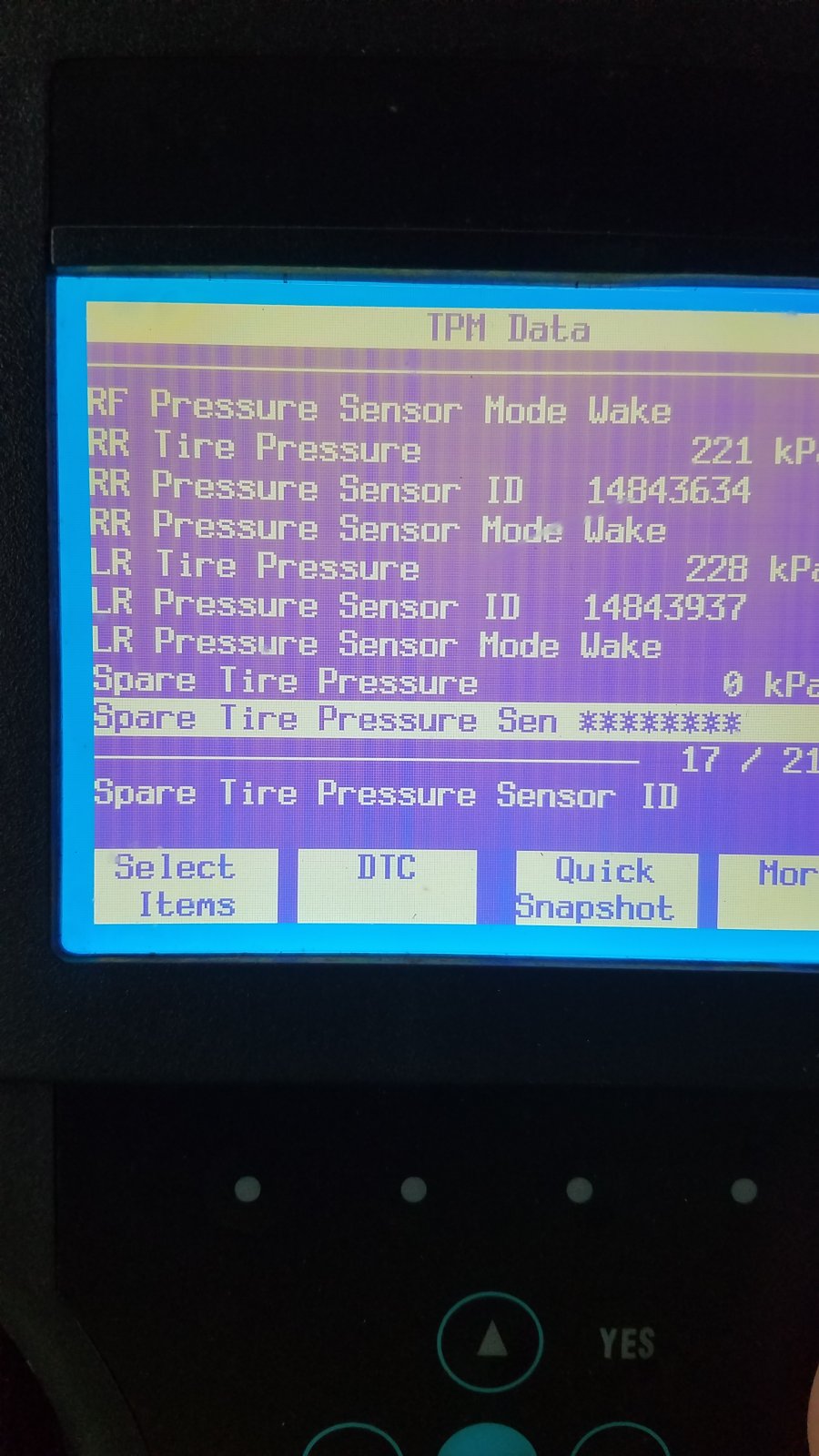

I don't have a sensor in the spare tire but I kinda figured what someone mentioned that if I enabled it I would geta tpms warning that it couldnt communicate.
