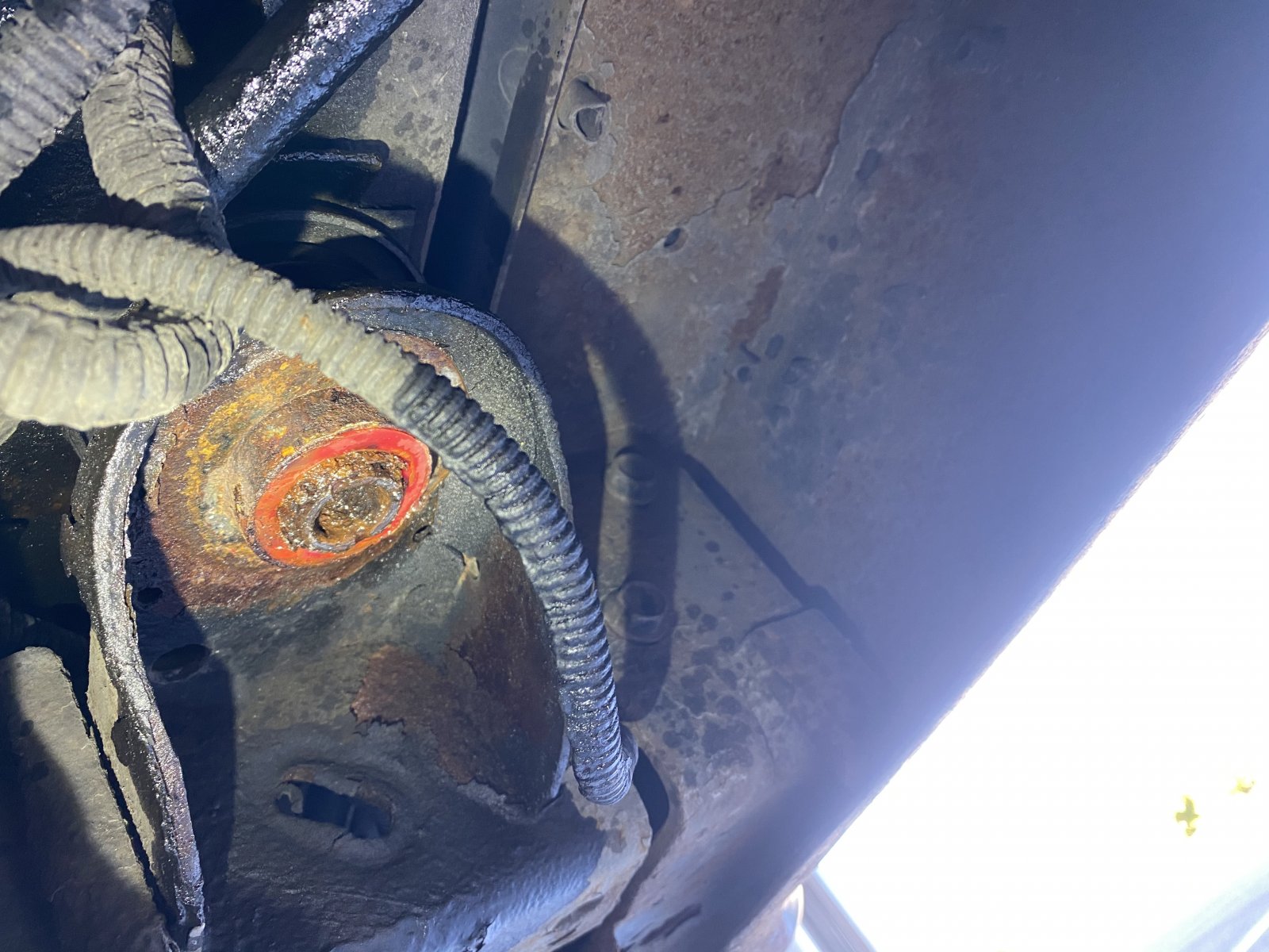

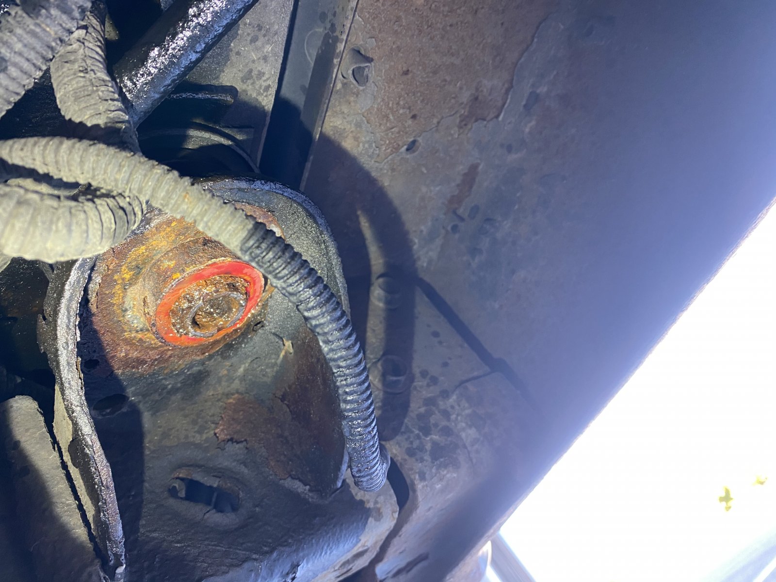

I sheared the body mount bolt off when trying to remove it. It is the rear drivers side just forward of the rear bumper. I got it turning with a 1/2 breaker bar, and the crack! Can I gain access from the top? 1997 Yukon GT.

I verified that there is no access from the top. I am going to try Center punching the bolt and drilling from the bottom....then thread chasing. I borescoped the captive nut through a hole in the frame. It looks quite rusty and dirty. I tried soaking in penetrating oil as best I could.

I got some long small diameter drill bits up to size F. I automatic center punched the bolt from below. I used an air drill and gradual stepped up the bit size as I drilled out the Center of the bolt with lots of cutting fluid to cool and lubricate. All went well until the side wall of the bolt chipped off. I ended up using a pencil grinder with a chainsaw sharpening grinding stone, to grind the rest of the bolt down. I ground it until there was enough of a recess, I could start drilling again. I got down to the tap drill size. I bought a Lisle socket set that adapts taps to a 3/8 drive wratchet. I used a 12mm x 1.75 tap. I Cleaned out the hole with air. I bought new bolts from LMC, coated the shank with corrosion preventative paste, and hit the threads with antiseize. I had a good face shield so I didn’t get a lot of shwarf and dirt in my face. Dare I try and remove the rear passenger bolt next!?

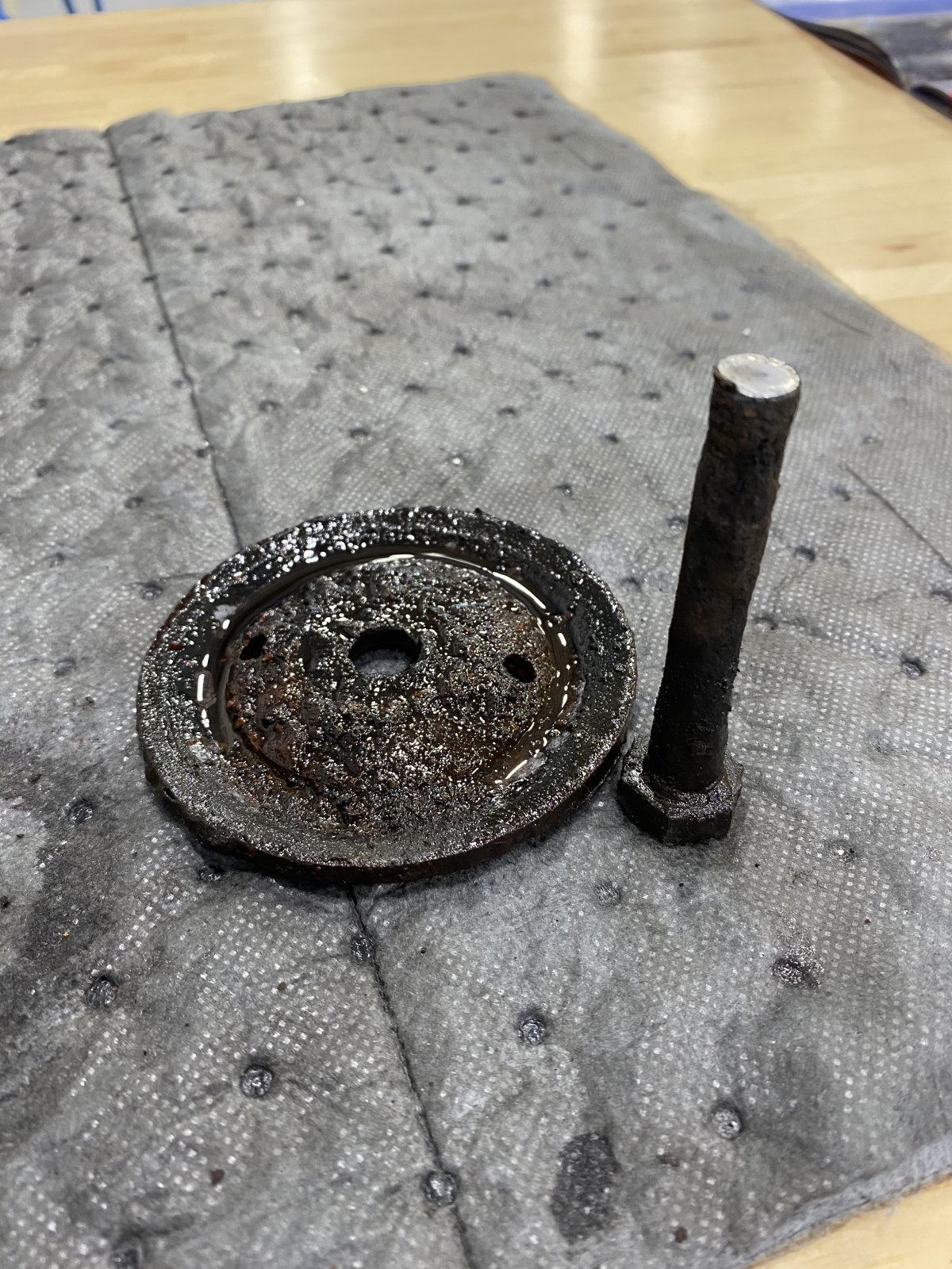

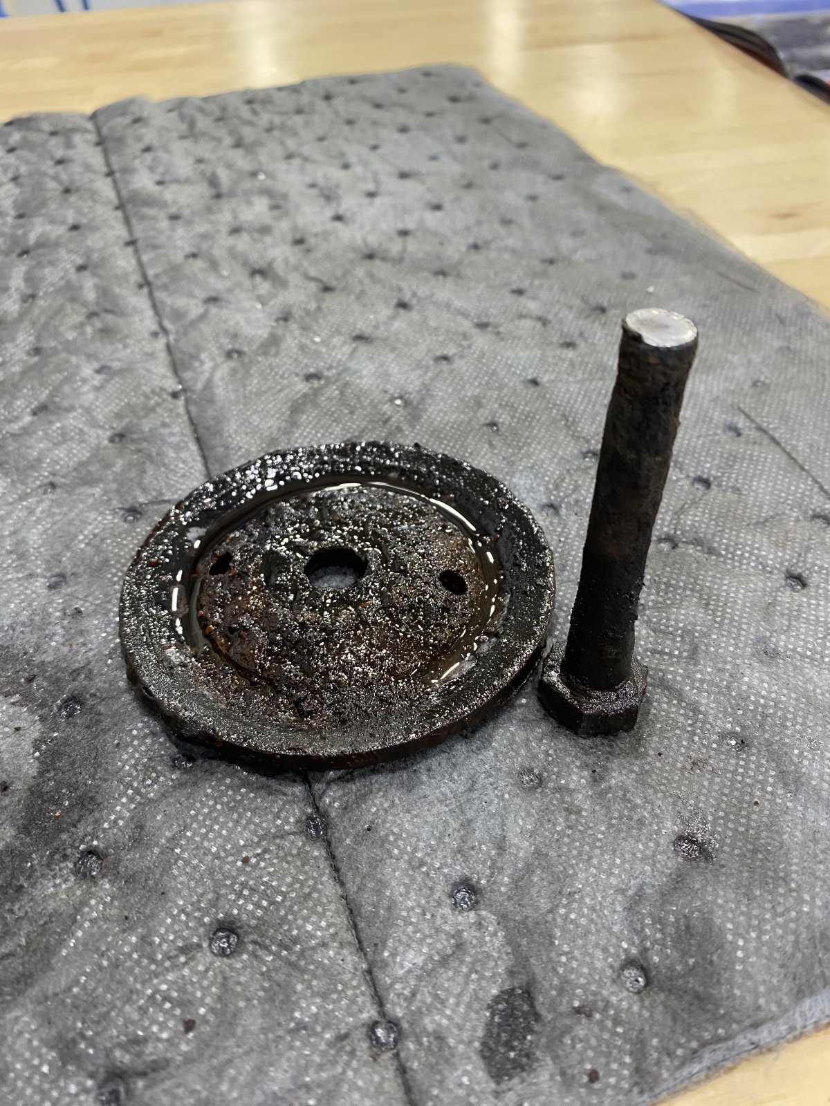

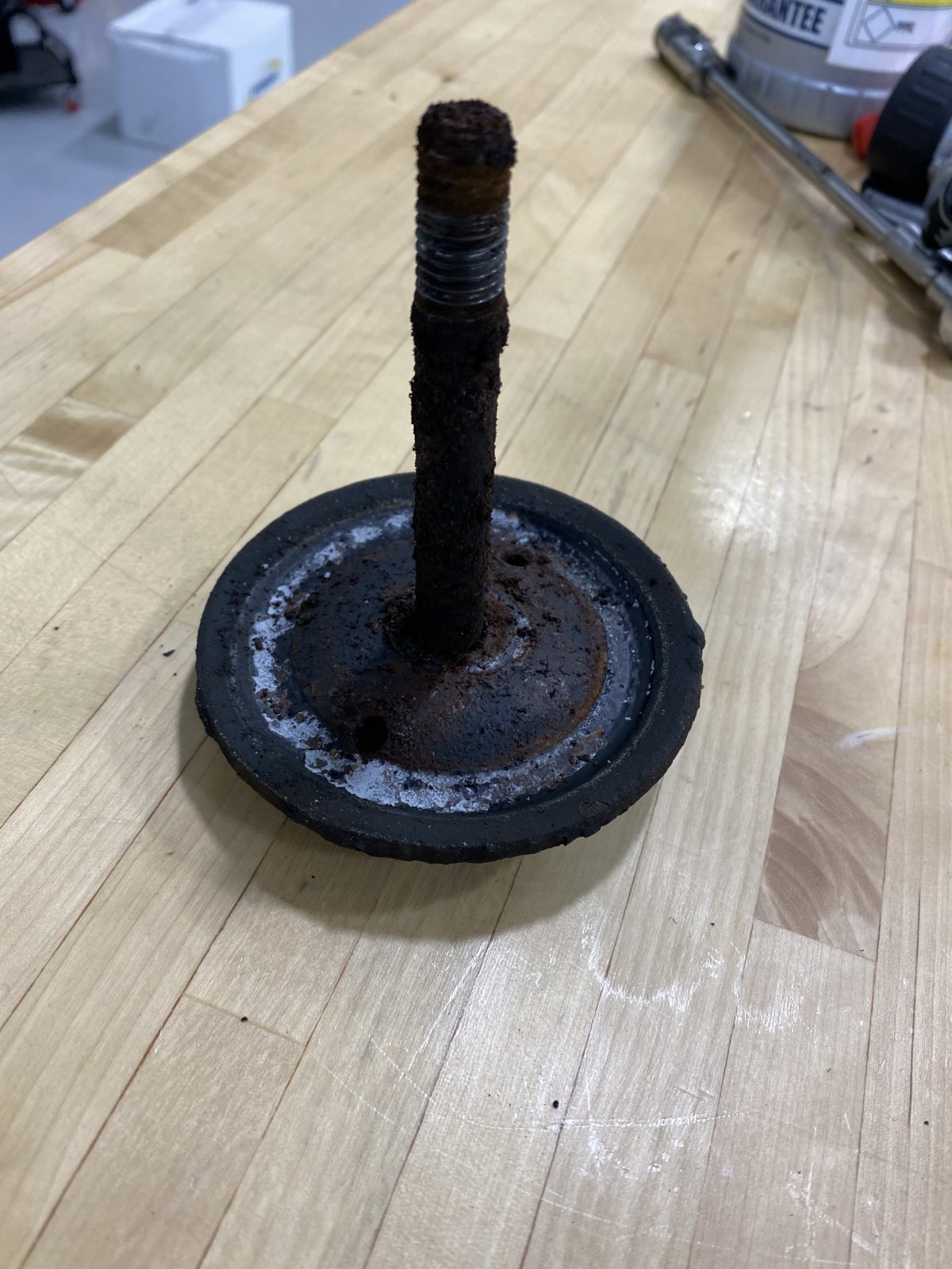

I blindly sprayed penetrating fluid through the lightening hole in the frame in hopes some would hit the exposed threads on my remaining bolt. Like you said I backed the bolt out and every so often would reverse the ratchet and put it back in. I am happy to say it came out, and the bolt was in very rough shape! Thanks for all the advice!
