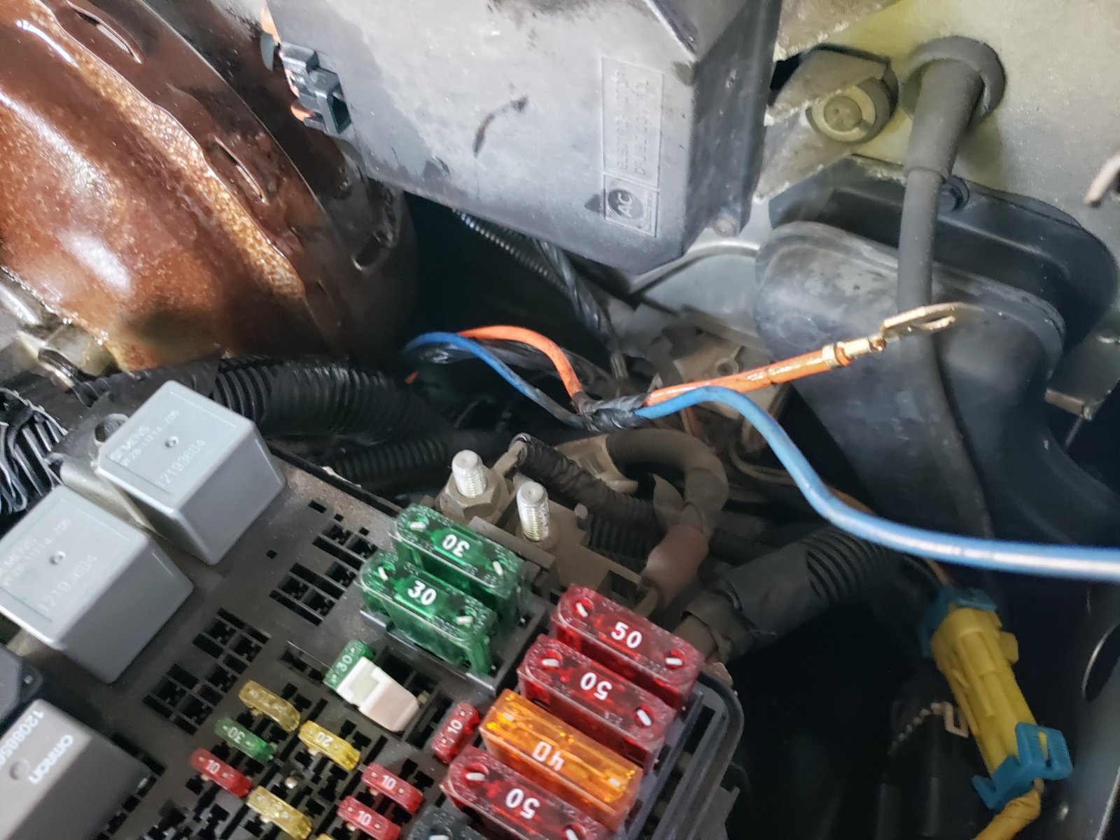

Many times GM left the 2 wires unconnected at the front near the brake booster. I can't swear if a 99 is the same but on my 98 and 97 the wires for the trailer brakes and the auxilary power were looped and taped near the booster. There are studs at the fuse/relay box on the left fenderwell to tap fused 12v that can handle the amperage.

under the hood it's disconnected at the factory

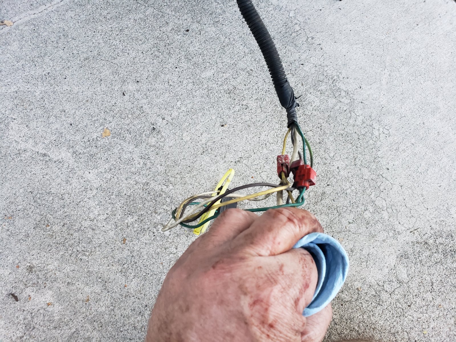

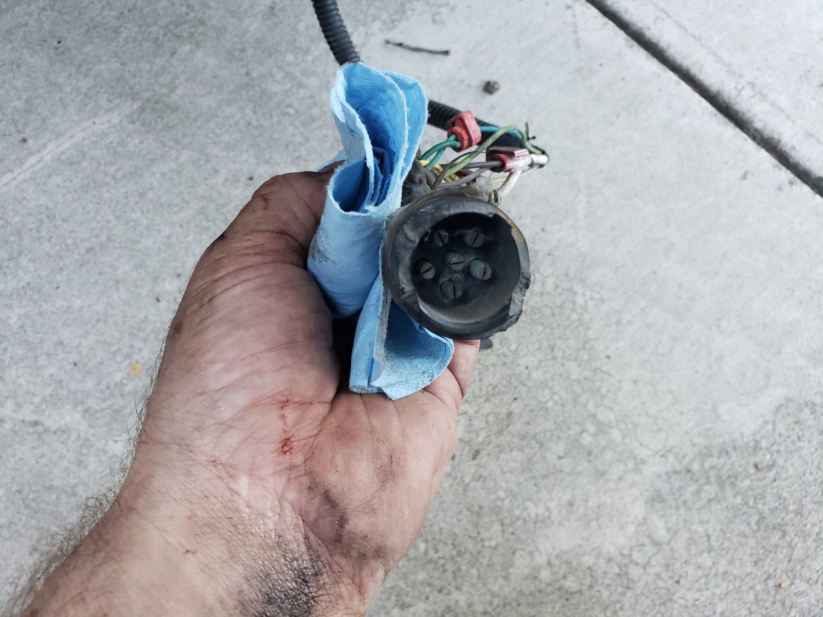

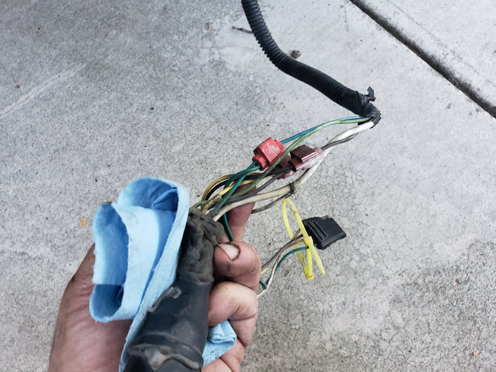

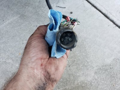

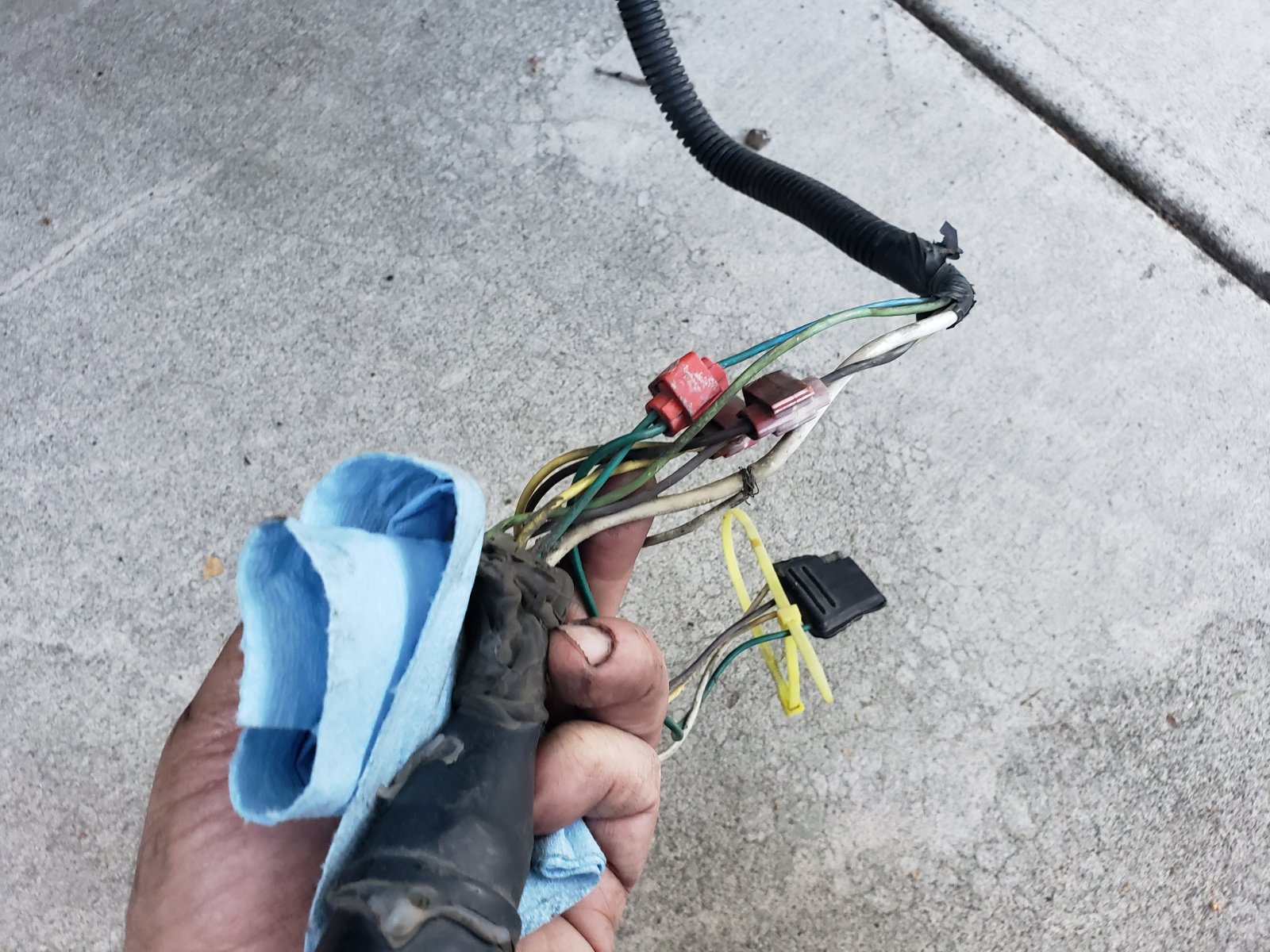

OK I found an orange and a blue wire tucked away behind the brake booster. I checked the two terminals behind the fuse box and noticed they are always on. Great now where in the world do the two wires orange and blue terminate? Here are pictures...
Under the hood and wiring in the back. Where is the blue and orange wire in the back.

Blue is typically the hot line to the brake controller, probably goes to the underdash wiring if you have it, then on to the trailer wiring. You have only 6 conductors in that connector and are probably missing the brake wire, or the auxiliary power wire at the connector. Those would be two heavier wires.

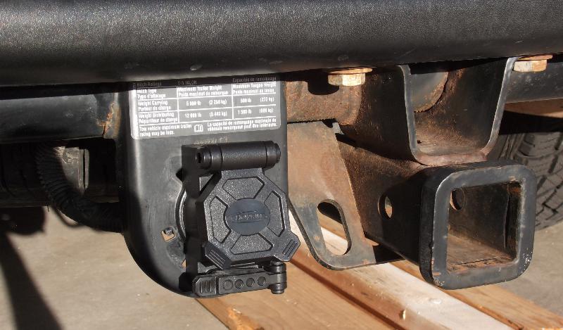

I replaced my whole 7-blade with a Hopkins combo - 7 blade and 4 flat. #40920. Snaps right in to the OE 7-blade connector hole, no screws, and to the OE harness. My towing is either with 7-blade or 4 flat.
https://hopkinstowingsolutions.com/products/vehicle-wiring-kits/vehicle-specific/40920.html
Ignore the rust, I've since sanded and painted everything...
that little surface rust. lol
but yes it is odd, most have a 7 blade stock. i believe i was having issues somewhere in the connection of mine and i was always having issues, i finally got fed up and cut it off and installed an aftermarket 7 blade. now i just need a hole saw to put it where i want it.
