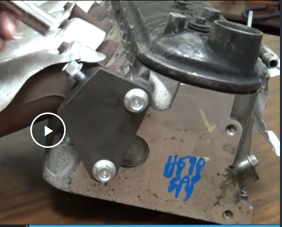

Make sure you chase all the other threaded holes in the head and clean gasket surface thoroughly. Get and install a Dorman exhaust clamp kit and use that and leave the broken piece in there. Or pull the head.
I'm not familiar with the Dorman exhaust clamp kit and just looked it up. This could be a solution, permanent or until I have a reason to pull the head for lifters, etc. It's definitely worth a try. Thanks for the tip!

Yeah, they make a clamp for the right front as well. Sure beats pulling the head off.

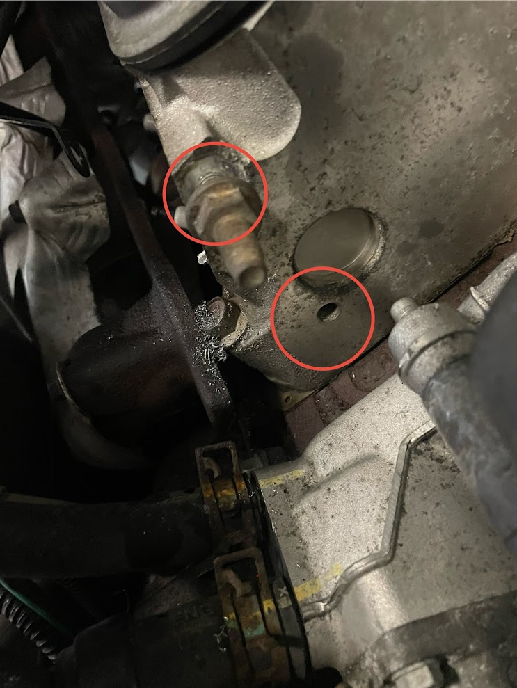

Looks like the front right is only for the 6.2l. I don't have any extra threaded holes on my right head near the front bolt so back to head removal.

I don't believe so. The Dorman catalog notes the right front is only for the 6.2L. On my 5.3L head, there is a ground bolt on the front.
You can still use it as a ground, with the bracket there. If the bolt thread configuration is the same, it might work, but you are gonna want 2 bolts to hold the bracket securely.

My head has the same two holes with a ground bolt in the upper hole. I'll try to track one down locally but I would think Dorman would spec it for both the 5.3 and 6.2 if it worked on both, unless the ground location is the reason.
I think if you get creative, it may work.
Moderator
16,623
34,409
People's Republic of Colorado
If the ground bolt/stud is long enough, use it for the bracket -- along with the other bolt below it -- and put your ground wire on the exposed stud.

if you really wanted to drill it there's a fixture they sell that bolts in the other holes and centers the drill but. the do also sell bits meant to drill out broken taps and extractors. I don't remember the name thou.
the clamp is the way to go. I have a cheap Amazon one on the back drivers side of my cathedral port 6.0. I believe it's the same head as the 5 3. heads are the same both sides, back of the drivers is front of the passengers side. so it should just bolt on.
ground can be anywhere that is able to be clean and makes good connection to the block. no biggie.

Success. The Dorman 917-107 clamp works like a charm. I relocated the grounds to an available hole to the right and the wires were long enough to reach with no modification. All the holes were M10x1.5 threads which matched the clamp kit bolts. The only reason I can assume this part is listed as not compatible with the 5.3L is the ground location but it's an easy solve.
Thanks to everyone who chimed in and particularly for the Dorman kit info. It saved me hours of work pulling the head.
