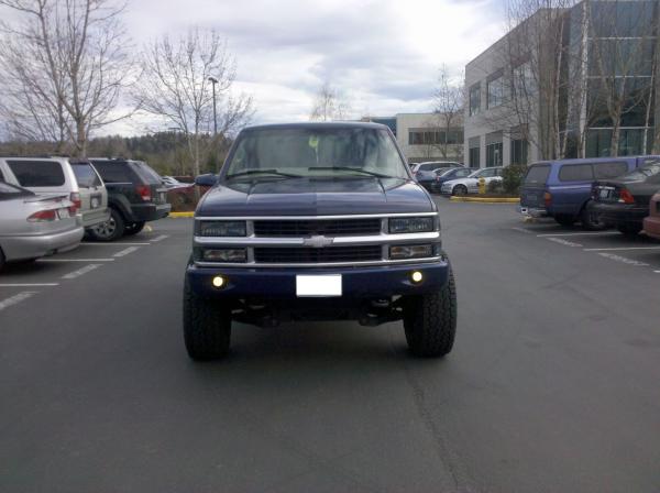

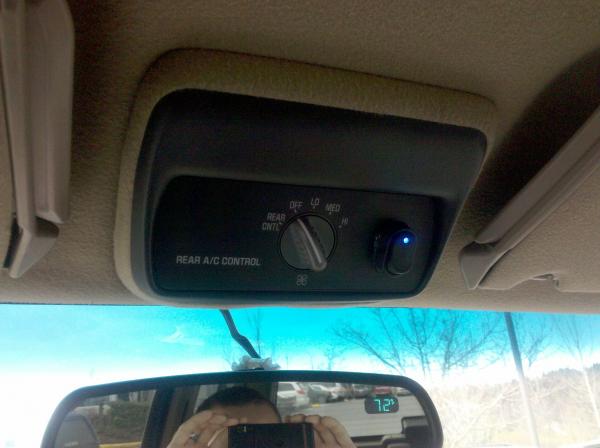

Thanks!! The fog lights were the $25 black plastic ones from Schuck's. Mounting them in my bumper was the hardest part, because there wasn't anything to screw into. The switch was also from Schuck's, because the switch that came with the light was too 80's for me, and wouldn't fit anyway. The upper console has one screw in the bottom you have to remove, and then it just wiggles out. It actually already has a hole for a switch in it already, it's just covered up. Run a drill bit through it, and you're set. The trim along the A-pillar just pops off. Grab a hold of it, and work a screwdriver behind it. All the wiring hides very nicely.
I'm contemplating a set of off-road lights above the bumper, but it will complicate taking the grill off, and might look stoopid. I want to mount the switch overhead as well, but it will either have to go sideways, or cover part of the labeling. Oh well. Decisions, decisions....
