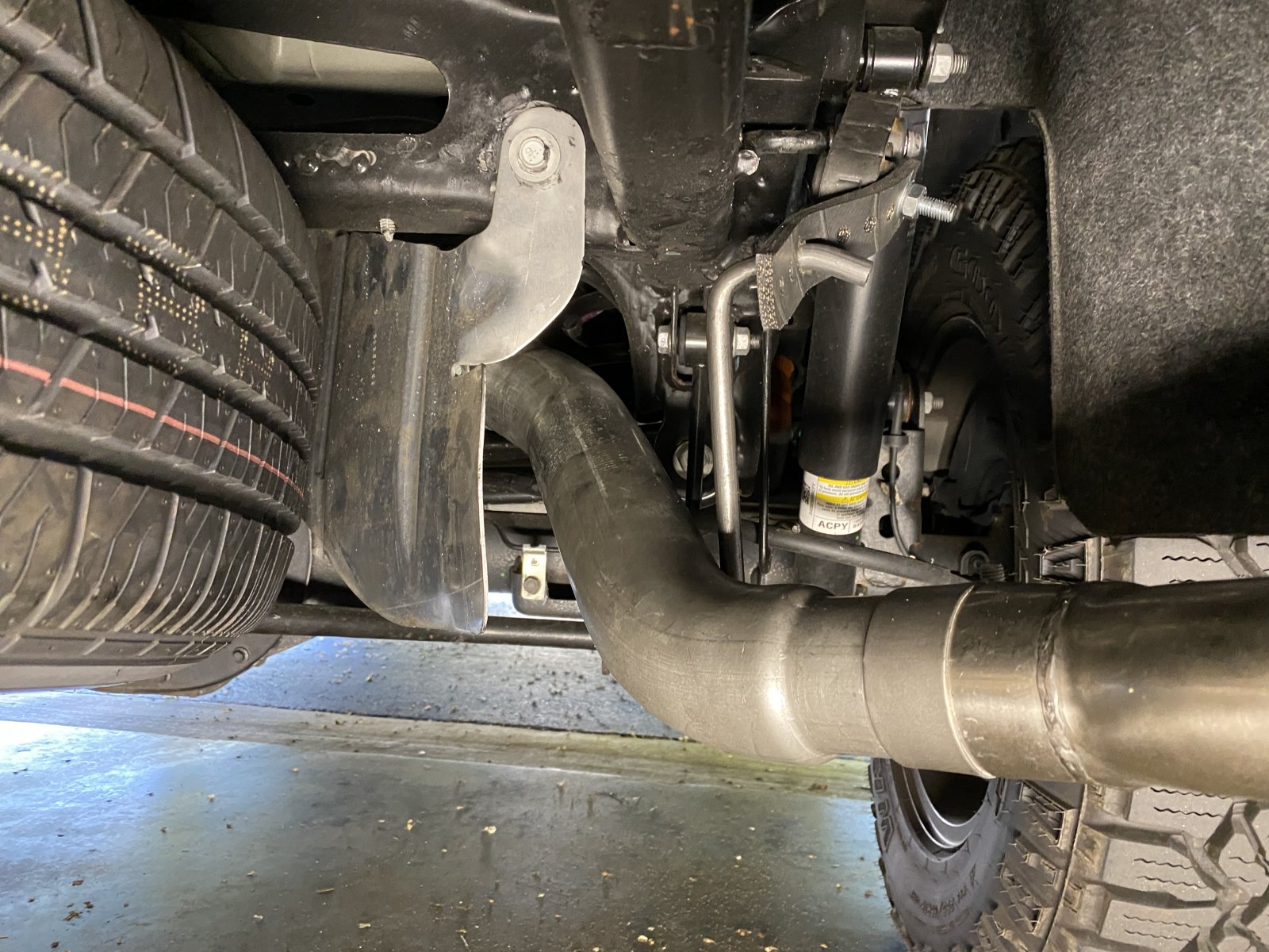

Well its definitely not a direct bolt on for the 2015+. BUT I made it work. The tips are kind of sunken in, would like them to come out a little further. Will end up cutting off the hanger on the new pipe and welding a new hanger on to line up better instead of the rig job ive got going on now.
View attachment 256405 View attachment 256403 View attachment 256406
Do you have a picture from the outside/side? Looks really good. Did you notice much difference in sound? I definitely want to do this on mine as well.
