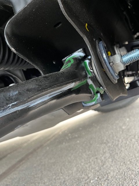

New 2025 tahoe. Wondering what the paint on the front control arm is about? Factory QA?

Visual inspections of the welds - paint marker is used to show that after the control arm was manufactured, a person laid eyes on the welds and it passed a "visual inspection." You'll also see marks like this on brake caliper bolts, tie-rod nuts, etc. Usually any safety critical components.
Thanks

That’s what I was thinking, checking the checker.
