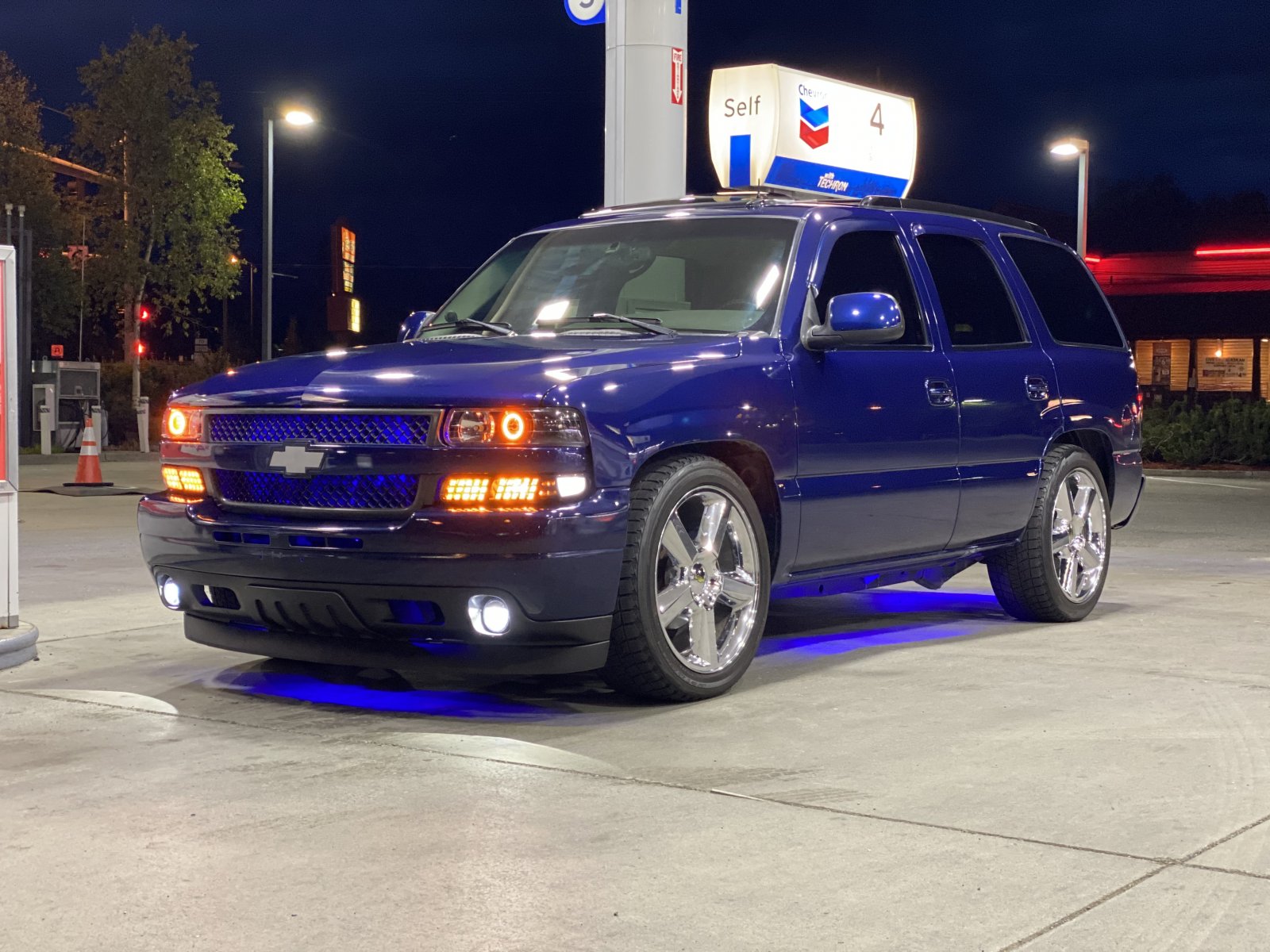

All of my lights are now LEDs. Did the 4 switchback mod with amber corner lights. All switchbacks light as DRL and parking/turn signals. Also used the Novita electronic flasher so no resistors are needed, and I previously did the diode modification so I have All-On-High. I like the result.

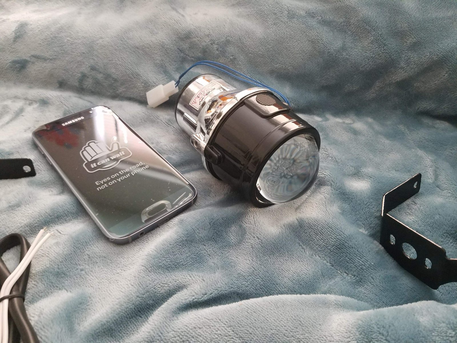

o5single.... I just got my TRS Morimoto HID 880 fog kit with 35w / 5500k bulbs.
Trying to mentally install the kit (first).... Not sure where the "OEM input" plugs into??
Uh, yes..... I will be calling TRS for help.....
But I was thinking, to rig the harness, I might begin by installing the bulbs, and run from there, to see where / how to locate the cute little boxes -n- such.
The kit plugs straight into the harness , unplug your stock halogen 880 bulb and plug the hids directly into the plug that was hooked to the 880 bulb. I mounted my ballast (cut little box) on my frame horn with just zip ties

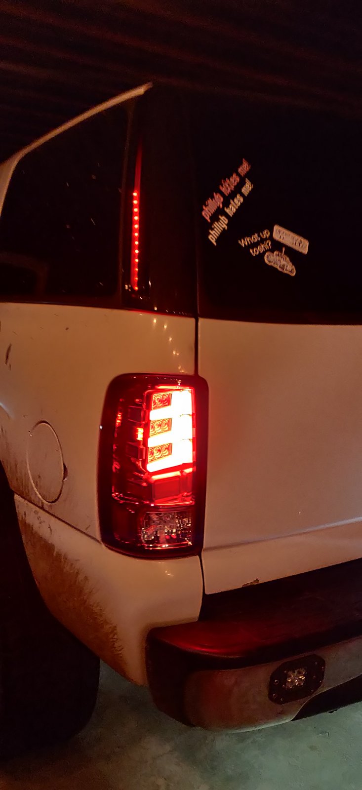

Too many LEDs and too much free time
Tail lights are the newest dress up
