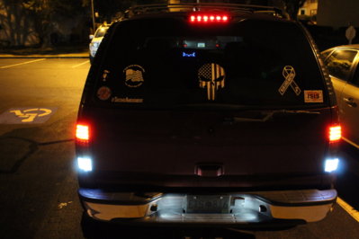

Front:
Hikari 6000k LED low beams
"Stark" Phantom 6000k fogs
Nilight 6000k 20" light bar
eBaytastic LED bumper lights
Rear:
eBaydiculous LED tail lights
eBaylorious LED 3rd brake light
eBaylicious 6000k spotlight reverse LED bulbs
Philips 6000k license plate LEDs
Other:
Xprite 3rd Gen 8-pod rock lights

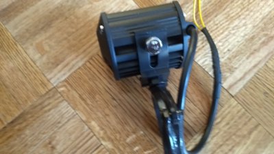

I installed rear fog lights to the car. Just wanted throw this mod out for those who want to add backup lights but not drill into anything.
I used
-2in pipe clamps from home depot
https://www.homedepot.com/p/Cramik-...anized-Split-Ring-Pipe-Hanger-20007/100182521
- 3/8 bolt
- Fog lights from amazon
https://www.amazon.com/gp/product/B01EJWB62U/ref=oh_aui_detailpage_o06_s00?ie=UTF8&psc=1
- and Rubber mastic electric tape
https://www.homedepot.com/p/3M-Scot...ic-Electrical-Tape-Black-50727-BA-5/202195402
All i did was drill out the fog light whole to fit the 3/8 bolt and attached it to the pipe clamp(also used a 3/8 nut for spacing). Added mastic tape instide the clamp for grip and then took the pipe clamp and attached it to trailer hitch of the car
