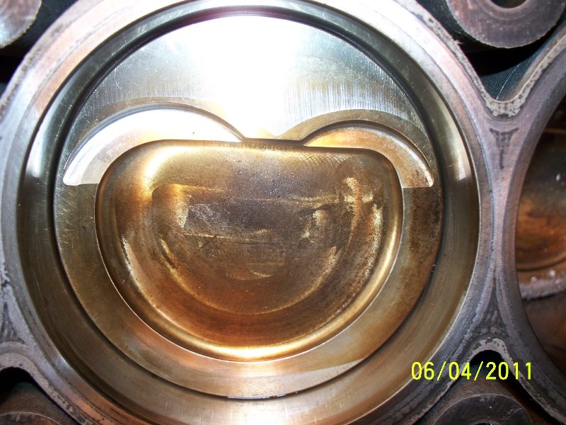

However, independent of cost, it might be worth running a few tanks of E85 back to back every few years. Ethanol is extremely clean burning and does a great job of cleaning up carbon left behind by E10 fuels.
This is after a 3k mile run of e85. Clean as a whistle!

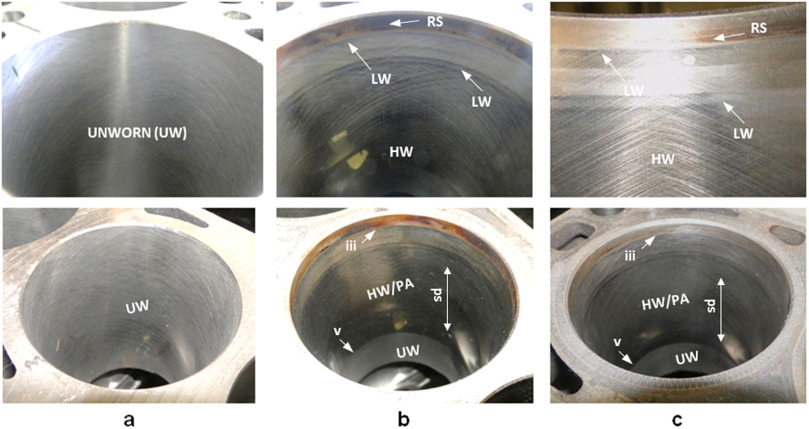

I did some more reading into this. Found a head after a year and a half of E85. Definitely seems corrosion is a valid concern. Also saw some dyno videos on youtube where E85 cooled the intake charge so much the supercharger built condensation on the outside
And here's from a block off a different vehicle. Seems to support the corrosion issue in a DD scenario.

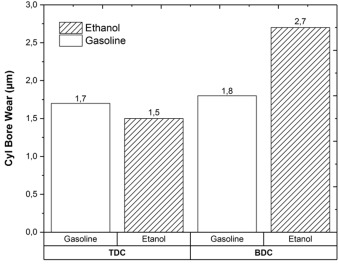

I also found this video, which seems to support the clean burning nature of E85. The engines were ran for 500 hours, but I suspect this was a continuous run and won't show the affect of thermal cycles like shown in the head above
And this neat little comparison where ethanol and gasoline were run, then wear numbers compared
Full paper here: https://www.sciencedirect.com/science/article/pii/S0043164818300450
So, my conclusions are this: Run a few tank fulls every couple years to take advantage of the cleaning abilities of E85. However, due to an increase in wear and corrosion concerns both with the engine internals and metallic parts of the fuel system, I wouldn't find it suitable for daily use where long term vehicle reliability is a concern.

That was after 450h of run-time. Equivalent to 10-12k miles of normal driving.
I think the info on cylinder wall wear tells much more of the story

I couldn't find anything about a difference in ring wear, just that paper on bore wear. And as it is, wear is cumulative. An uptick in wear doesn't mean worn out, only a reduced lifespan. How much, however? I couldn't tell you. Information is just that... It's... Information. What you do with it depends on your scenario.
What's appropriate to use depends entirely on your usage case. If you don't keep a vehicle long term (less than ~175k), minor variations like that are of little to no concern. If you're like me and like to keep things long term, then it's appropriate to dig into discussions like this a little more.
