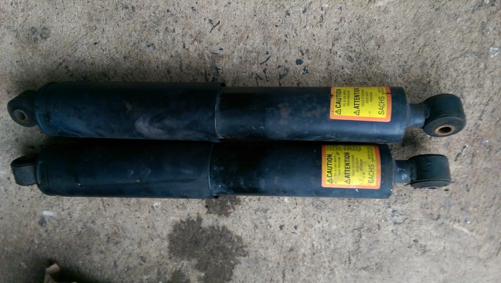

This is what rockauto.com shows; only 4 that I know of that make them. If you want to be certain you need these look at your RPO list in the glovebox, it's a sticker with a bunch of 3-digit codes on it. You're looking for ZW7 & G65. If you have both of those you should have these shocks or you should replace your rear coil-springs if you want to use another shock type.
$244.79
KYB SR2004 SR Series; Self Leveling / Self Contained (Nivomat design) Info
Rear; w/ ZW7 Premium Smooth Ride suspension; Except Z55 Autoride suspension
$277.79
ACDELCO 540532 {#12477517} GM Original Equipment Info
Rear; RWD; SELF-ADJ MANUAL LEVEL CONTROL(G65), PREMIUM SMOOTH RIDE Chassis Package(ZW7); EXCEPT "OFF ROAD" APPEARANCE package(BPH)
$317.79
SACHS 444232 {#15756794} Info
Rear; w/ ZW7 Premium Smooth Ride Suspension; Nivomat
$281.79
MONROE 40209 {Click Info Button for Alternate/OEM Part Numbers} Specialty Info
Rear; w/o Z55 Electronic Suspension; w/ ZW7 Premium Smooth Ride Suspension
AFAIK Sachs is the OEM so the Sachs part should be just as good as the Delco, I wonder if they've made some improvements not taken into account in the cost of the ACDelco? I don't know why the price difference otherwise. This is the one I was thinking of when I said OE was over $300. Looks like the ACdelco is less.
