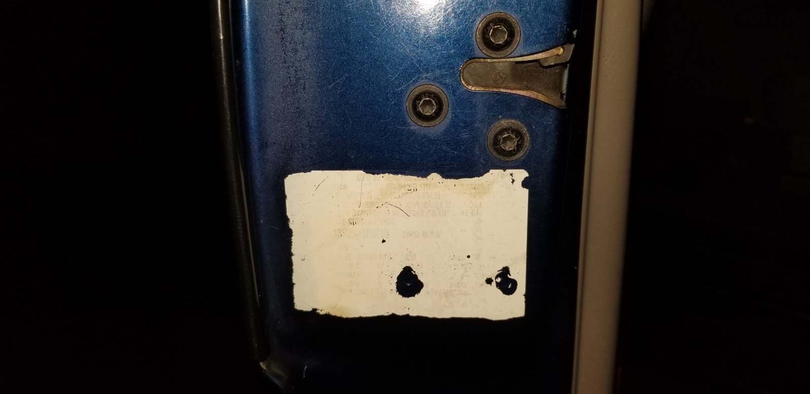

I forgot the previous owner ripped the tag off the door.
