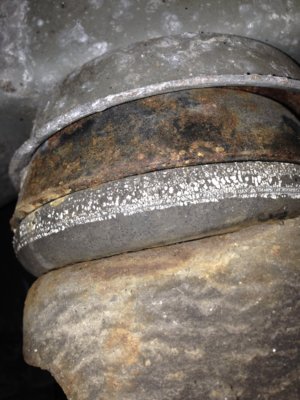

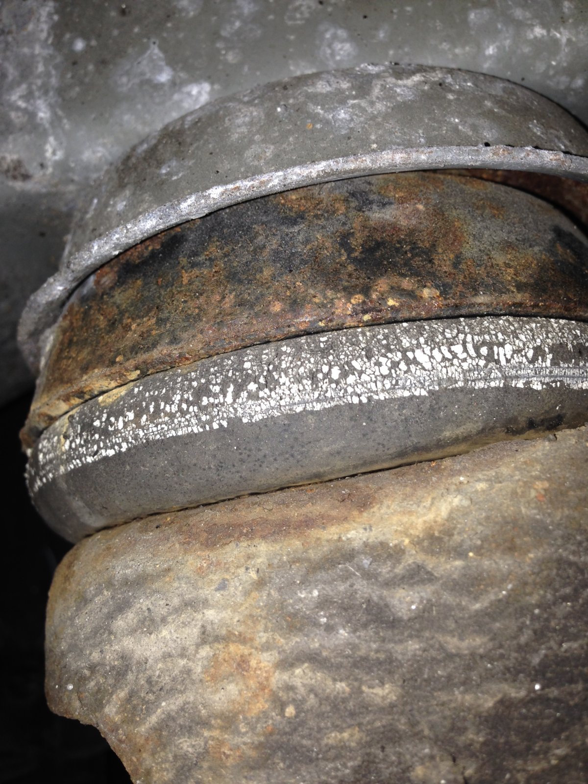

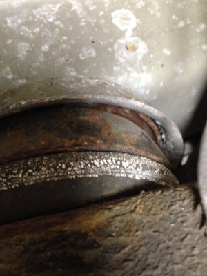

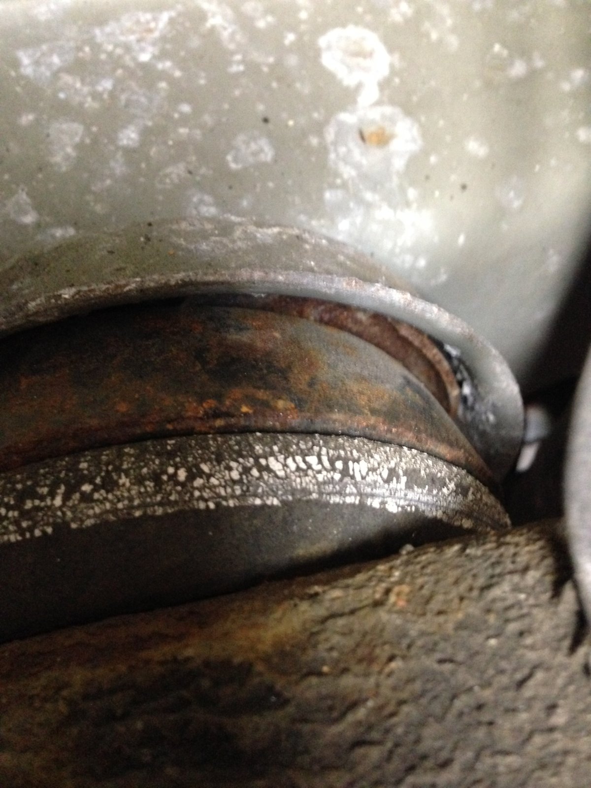

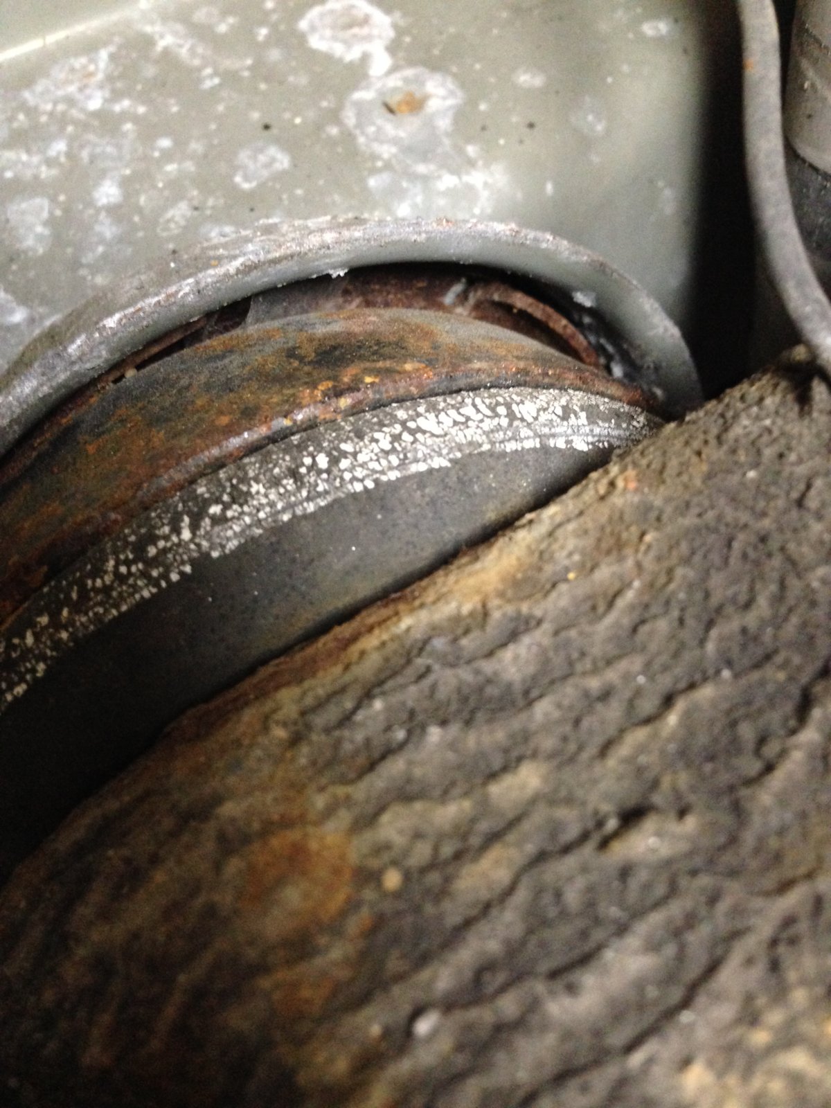

I replaced both sides with timken yesterday. No change. There was bushing squeak from one and some bearing noise from the other. No play in my hands. I even hit the old ones with a 4 pound hammer to see if they had any play. Nope.
So I started to think about the conditions and dampening. I might have found my problem.
Massfloefi
Massfloefi
Jun 3, 2018
212
170
The bottom part of the bushing is completely shot when you squeeze it and you can clearly see that the metal cup the upper bushing is sitting in is bent away from the body mount.

I don't know much about all this, but you may check your body mounts. Maybe one rotted and is causing uneven vibration distribution around.
I think you may be right. I posted pics and made a video on page 5 with noise heard and shaking at the suspected bushing. I'm sure they all need to be replaced on a 13 year old northeast vehicle.

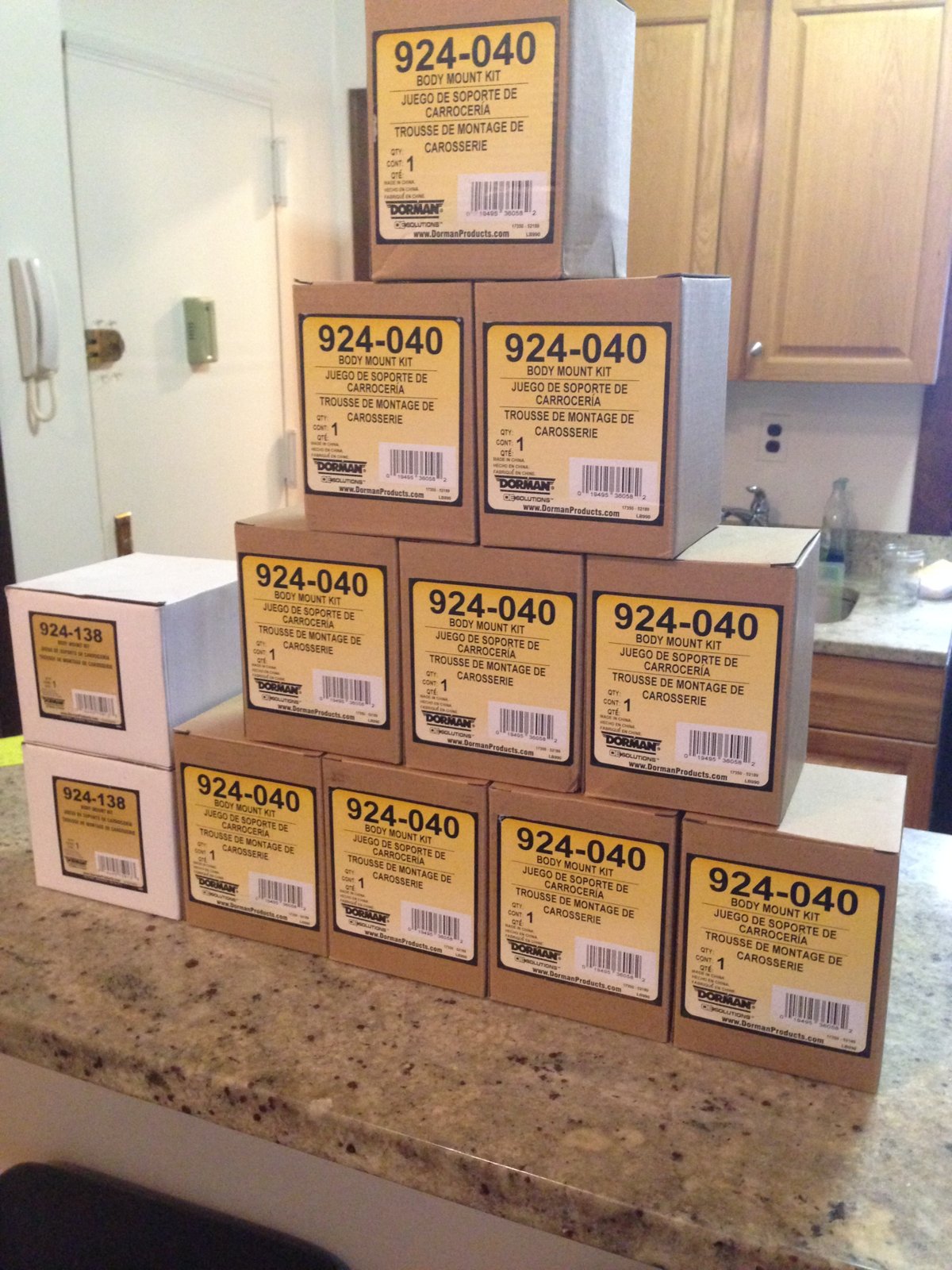

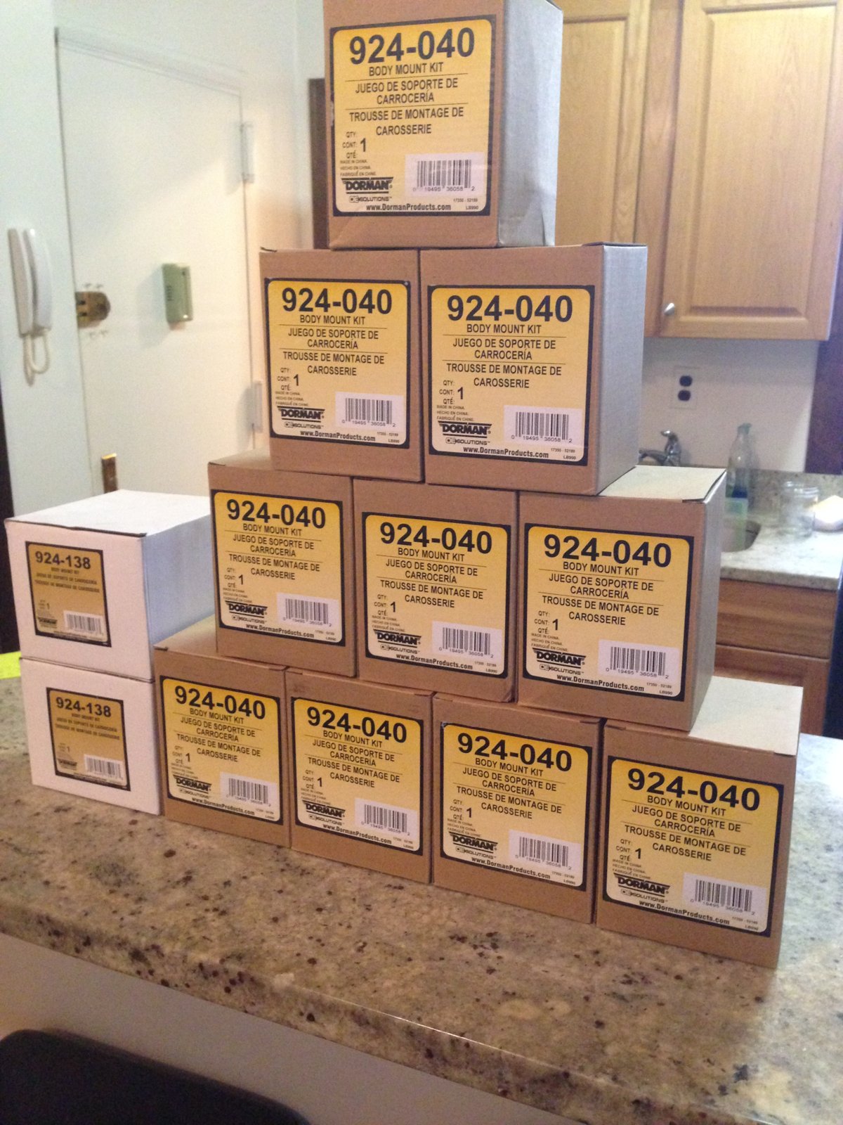

Where'd you get them and what was the cost?
I thought I was going to only change one at first so I purchased it from Amazon for $48 and the rest from Rockauto for $430 including express shipping. You can save a couple dollars if you choose to a slower shipping time. Doesn't make any sense to just change one since you literally have to loosen every body mount and lift one entire side of the truck in order to change one.
Dorman claims that the 924-040 bushing is only applicable for positions 1 through 4 on my application. After consulting with them directly they can only guess that the upper bushings has a different compression rate and should be fine if I change all of them. I agree since polyurethane kits are all the same compression.
Reason for choosing Dorman over GM bushings is because of price and the fact the GM claims some of the bushings have been discontinued. Well I asked GM Parts Giant if I could just use the other stock bushings in place of the discontinued ones. Their response was useless with no info either way.
I will post after install with results.
