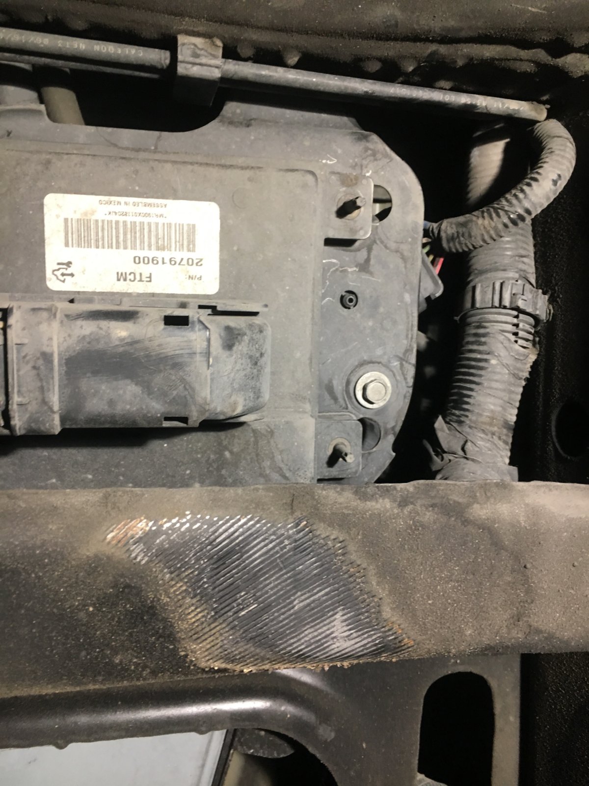

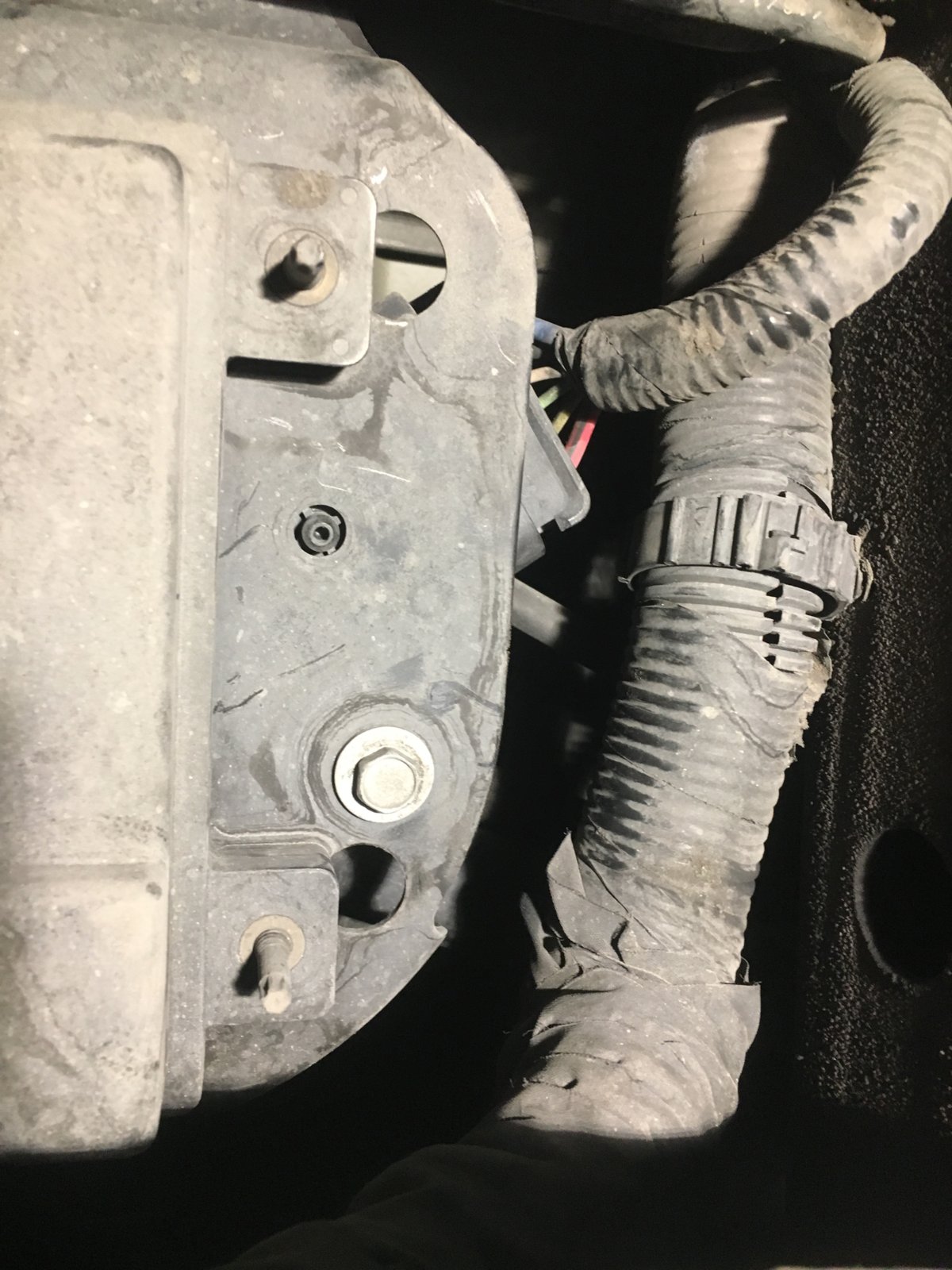

Can anyone look at these photos and tell me where the trailer brake relay is to swap it out?
View attachment 191606 View attachment 191607
It is where the plug is with the red and blue wire on either end. Should have a screw on either end holding it in place. Remove, unplug, plug in the new one, screw in place, and then do something fun... that's it.

I tried and I can remove one screw but the others are some weird torx socket.
