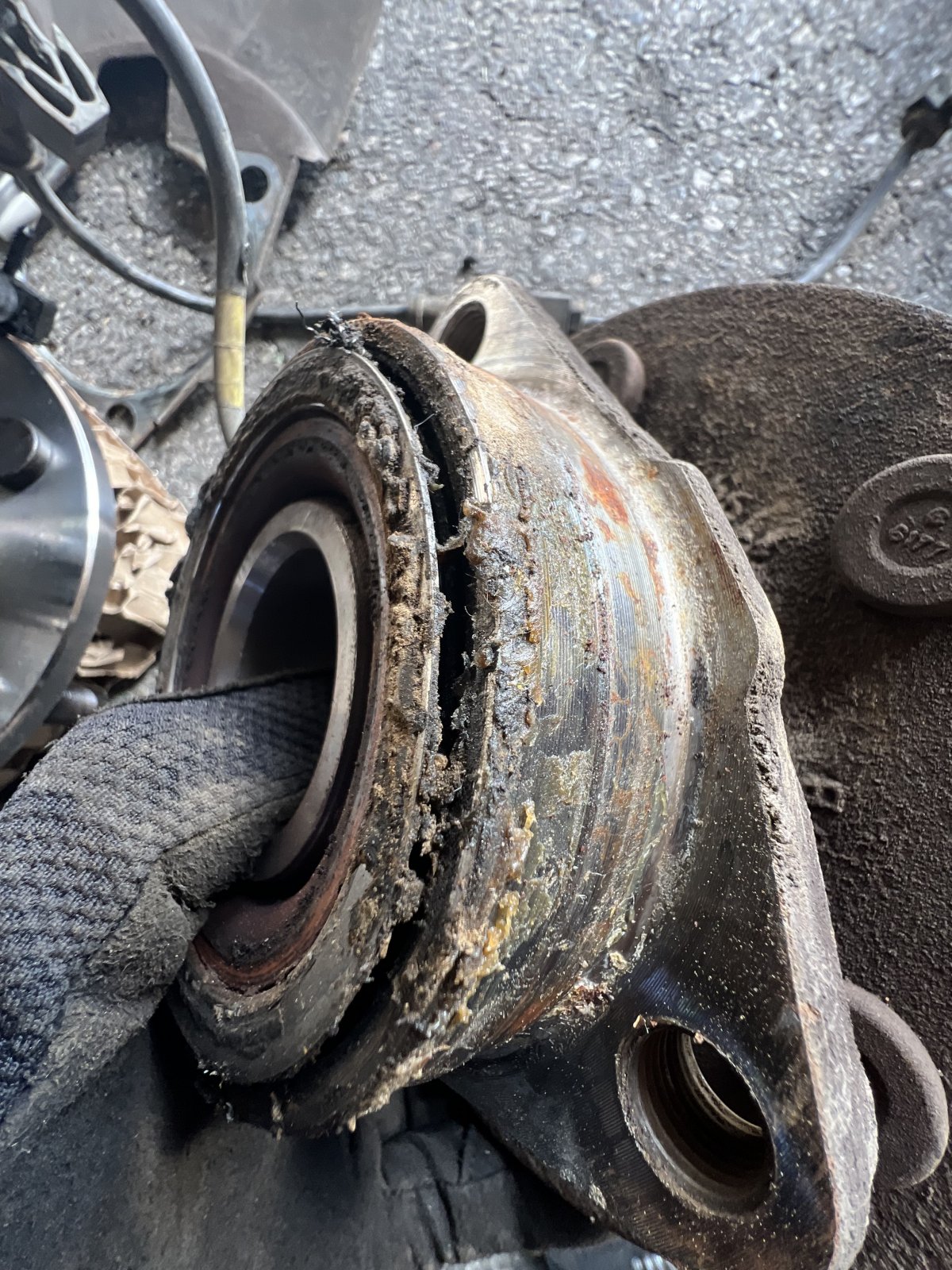

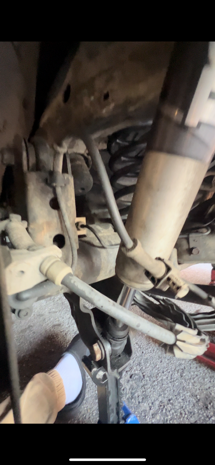

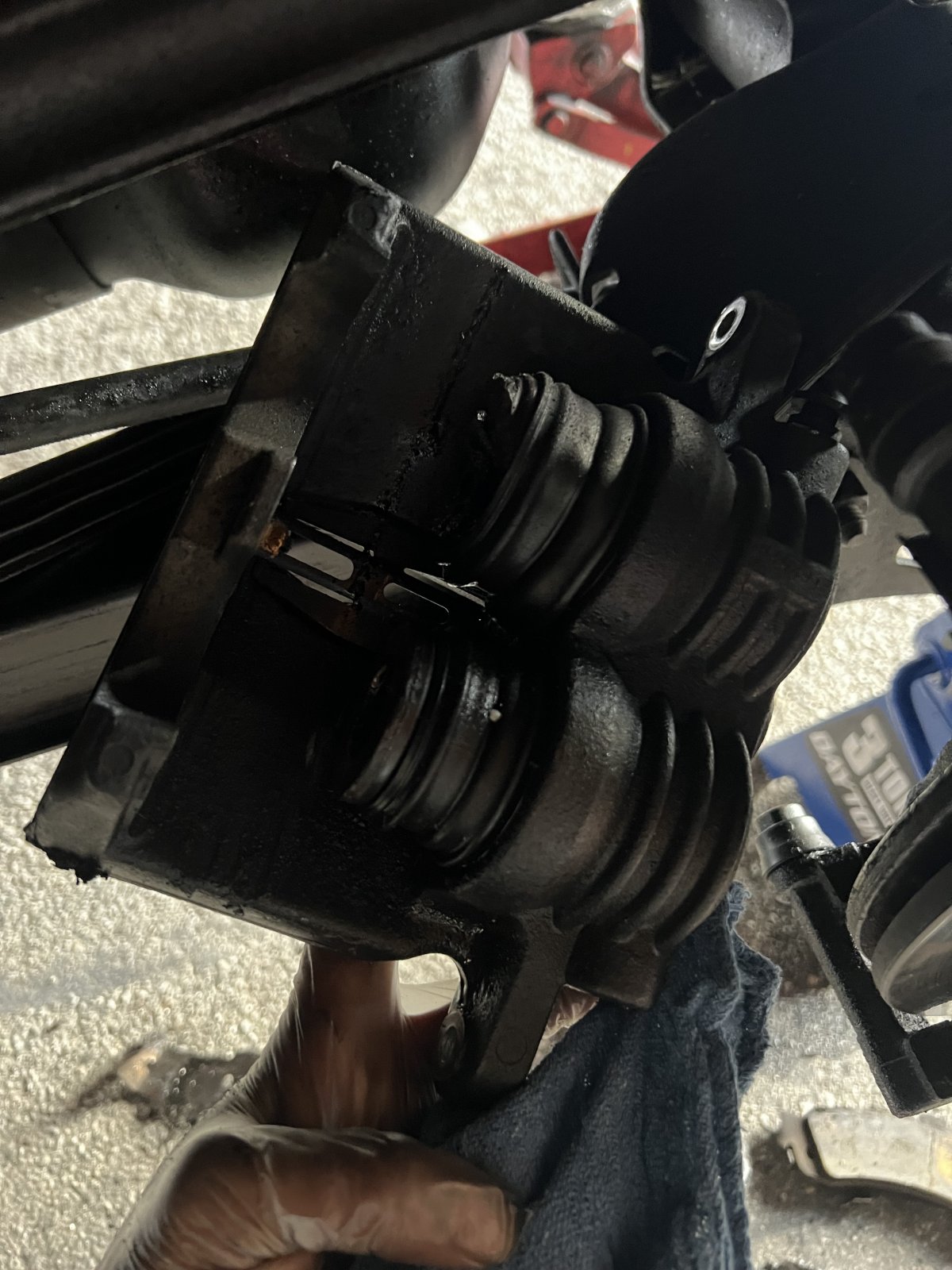

I have 05 z71 Tahoe 4x4 that is experiencing the same issues with “service stability”. The brakes seem to seize slowing the vehicle down during accelerations.
So far I’ve changed the passenger wheel hub, driver side rear abs and caliper.
Any help is much appreciated thanks in advance!

Parts I’ve swapped out.
