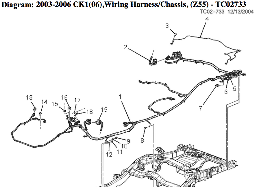

Here is a picture of the schematic for the air tube. It is number 4.

Do you know what the specific code is?
Do you happen to know how this air tube interfaces with the rubber hose that comes off the compressor? I'm trying to better understand this whole system. I noticed there's a tube going to the axle.
