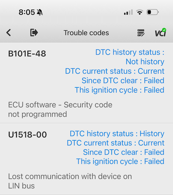

That said, I do have 2 codes in the Instrument Cluster module:

does it have a HUD? the b code means it might need a fob relearn
It does not, but the cluster is configured for one and I have the hardware for when I get up the gumption to install it.
Weird on the fob relearn. It was getting a low battery error on the fob before that, so I'll replace the fob batteries as a next step.

Found a little more specific info for both codes. The U1518-00 looks to be a problem with the comms link to the HUD, which makes sense because it's not installed. So I'll eventually fix that one when I do the install.
The B101E-48 code has a bunch of different possibilities, but no fixes except potentially voltage issues or a dealer-level reprogram. Seems I should be able to do that if I buy an MDI 2, yes? Hate to spend the money for the Bosch tool but it seems GM has been locking clone tools out of their TDS service. Maybe I'll just bite the bullet and take it to the dealer and pay them to diagnose it. Before I do though, I'll disconnect both batteries for a bit and touch both cables together briefly before putting the terminals back on.
